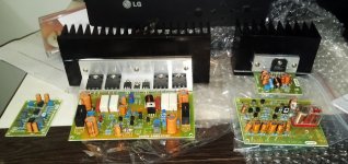

Adding some pics of the kits I got:
Description left to right:
1. Active crossover @110hz
2. 200W Toshiba 2SA1943/2SC5200 mono amp for sub
3. LM3886 mono board
4. Speaker protection module

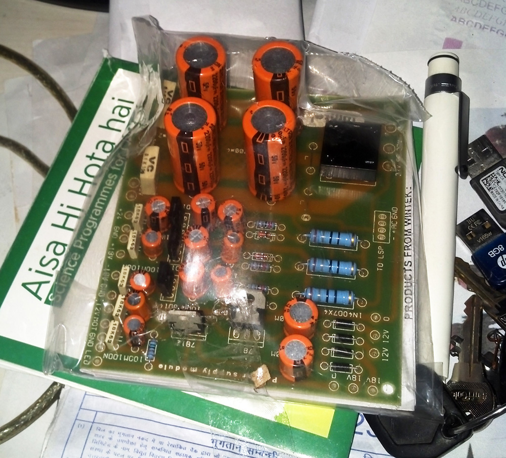

5. Power supply module, here is the pic:
Right now I have 4 ohm and 4-8 ohm rated speakers/tweeters. Some are 40 W and some are 150W. My speakers are 8"-10" and consume lot of space so maybe I replace them sometime later with smaller and more efficient speakers. Chances are that I get 8 ohm speakers later but its not certain.Do you have 8ohms, or 6ohms, or 4ohms, or 4 to 8ohms speakers.

But the specs sheet of LM3886 board saying +/-28v for 4 ohms load.A 22Vac + 22Vac transformer is probably what you need for your 4ohms speaker loaded chipamps.
6 channels @ around 50W equates to very approximately 300VA of transformer. This size is not critical, you could probably get away with anywhere from 200VA to 2000VA
What is the needed ampere here? When I emailed my amp kit vendor, he recommended 650VA 12 to 13 ampere for 5 X LM3886 and 500-520VA / 9A for 200W Toshiba kit. And you are saying just 300VA. Which one to pick?
My major confusion is what I need to say to the transformer vendor when I go at there so that he can give or prepare me the right transformers for both applications. Also, I would need 18-0-18VDC 500mA tapping for the sub crossover so how to get that? Will there be any provision in the sub transformer?
This is main power supply for the AMPs so a crucial thing and I am worried about it. More I read on the transformers, more I get confused.
First of all I want to buy all the required transformers, will step into next stage after getting all the transformers.

That power supply PCB is not good for LM3886 x 5. You need good caps to product nice sound from LM chips..
650VA and 12 Amp is totally overkill for 5 x LM 300AV will be sufficient. And if you are planning of power manage each channel,, then go for 5 small transformers with 5 separate PSU and switches.
Subwoofer amp can be mounted inside the sub box.

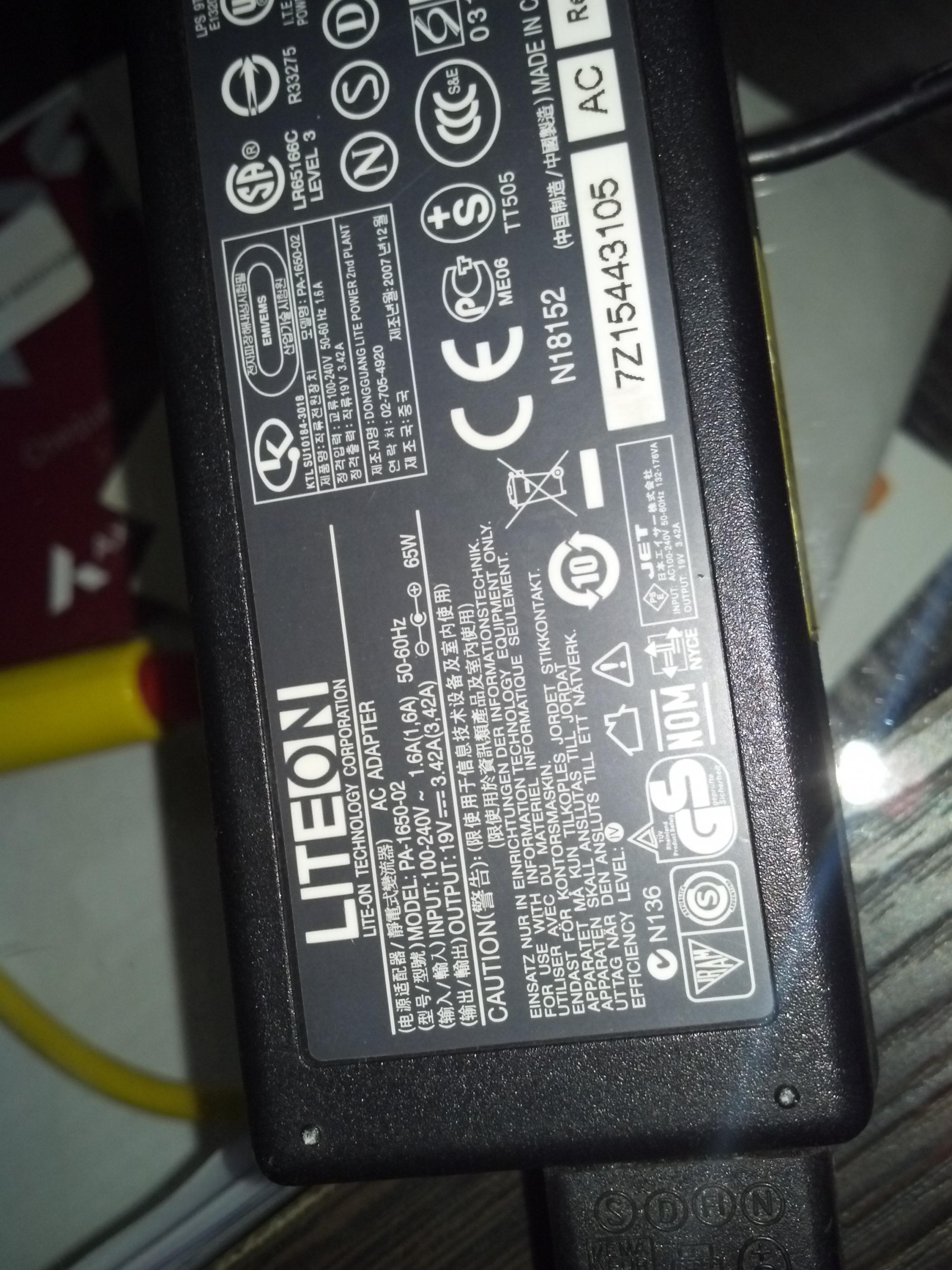

This is my laptop's power adaptor. I am curious why can't i use something like this?
SMPS for the Gainclone chip amp
http://www.diyaudio.com/forums/power-supplies/229707-laptop-power-supplies-amps.html
I'm using industrial grade SMPS +/- 21V 5A for my LM1875 chipamp. No audible RF or hum problem. Got it cheap directly from manufacturer.
BTW you will require 2 adapters(preferably same make/specs) in series to generate +/- V.

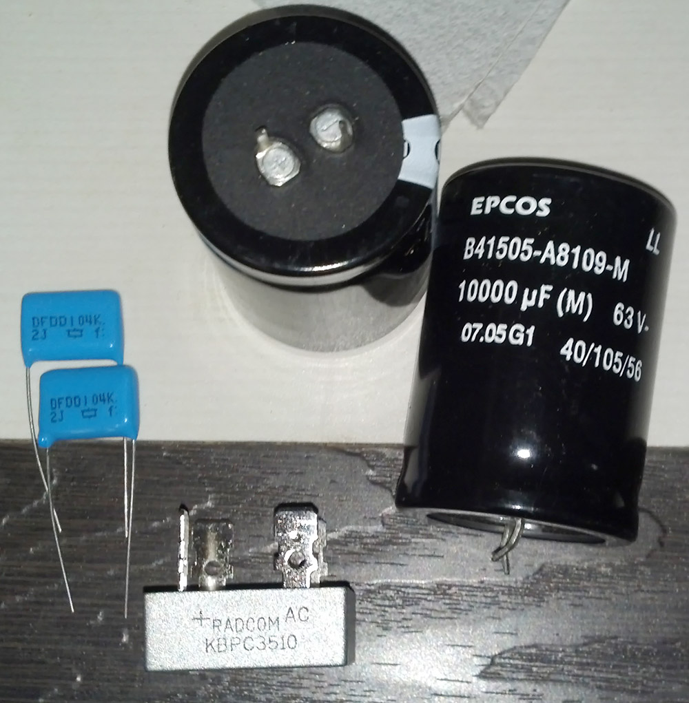

Yes you need a PSU , almost everything needs a PSU .. Your standard PSU will consist of a power transformer , a Bridge rectifier (to convert the AC from the transformer to DC) and Capacitors large enough to supply enough low ripple dc to the amplifier(s) .....
The PSU board you posted might work accept for the fact that
A) the bridge rectifier is too small for 5 LM3886 and the 200w sub amp.
B) there isn't enough capacitance and not enough space on the board to install more/larger capacitors. (though it would be useable to power your crossover but a bit overkill)
The non-scientific rule of thumb I use is to use at least 4700uF per rail for every 50w power output though I usually use 10,000uF per rail , so a PSU with 40,000uF to 50,000uF of capacitance would be suitable ....
Now for PSU follow this design... Dont forget to attach fuses (Slow blow fuses).
http://www.circuitstoday.com/wp-content/uploads/2009/07/40v-dual-power-supply.jpg
Right now I don't have fuses so can I skip this state till I complete the testing and later I can add the fuses when I am finalising the product. BTW what rating/spec fuses I need?
Vendor's site suggests to connect a 60W bulb in between while fist time testing which I can use for now.

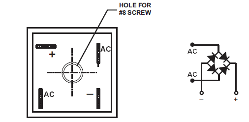

About the PSU circuit design, I am confused how to connect the 35A bridge rectifier? There are four legs on it, 3 are similar and one is different. Now all four lags it will be connected but not sure which one to connect where?
Rest is not confusing.
Thanks, that really helped a lot.May be this will help...
The bridge rectifier I have is the same one like the image you posted. Now I can move forward.
This will help you in wiring.
http://www.diyaudio.com/forums/atta...m3886-schematics-pcb-lm3886-montazna-sema.jpg
Thanks.

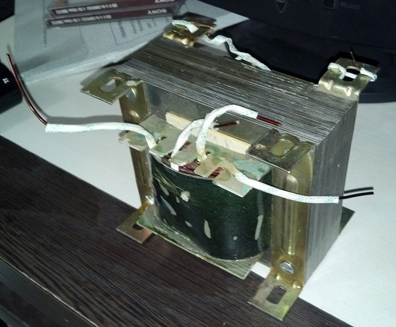

Most probably my another transformer for the sub (28-0-28, 5A with provision of 18-0-18, .500mA) will also be ready by tomorrow so I will again go to the market to collect it. I have collected PSU components for LM3886 part.
Now I will also need PSU for the SUB AMP and currently I have this PSU: 12-0-12VAC 1A Input, 18-0-18VAC 1A Input, 27-0-27VAC 5A Input, Regulated 12-0-12VDC 1A Output, Regulated 18-0-18VDC 1A Output, 38-0-38VDC 5A Output .
Please suggest what components I need to change in this PSU? What more parts I need to collect from the market?
