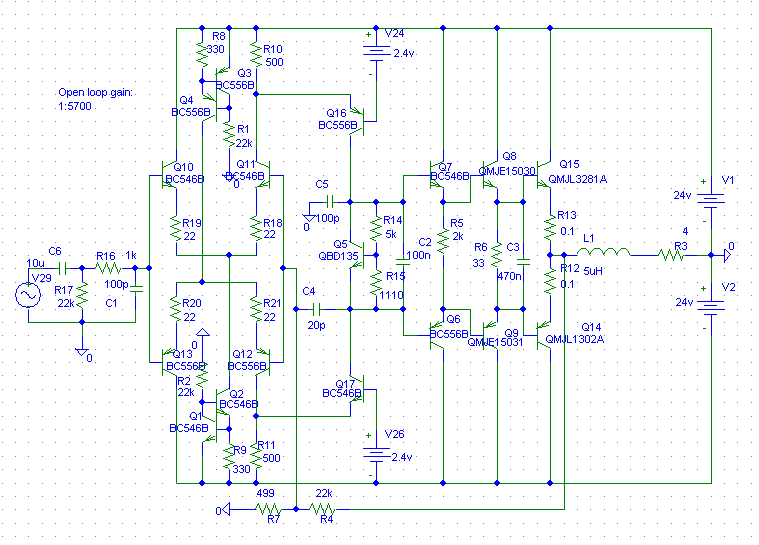

Have you ever succeed in buiding a input stage with current mirror?
hi thanh !
I did some more checkings on the asymamp i posted here, it's kind
of useless. When clipping to + , it completely breaks down, seems
that currentmirror is not too easy. I could remove the buffer, but
this is bad for distortions. BTW, it's nearly identical to the blameless,
not so blameless at all... I would never build an amp showing these
symptoms !
So i will continue finetuning my symamp first.
Mike

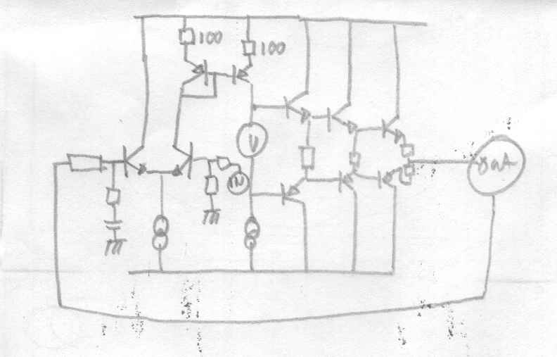

mike! I don't understand "when clipping to +" . With 700mV pulse signal, output voltage only include "positive part" .
Yesterday, when I turned off the neonlight ,my amp also broke down . V- failured
:xeye:

hi lumanauw !
hmm, the output with my circuit is not inverting... :)
I am not sure how you want to use the currentmirror, can you show
some schematic ?
I use complementary diffamp, resistorloaded, and then symetrical
folded cascode. As i use negative side of diffamp, output is not
inverting. I can post schematic later.
hi thanh !
Not nice to hear you blew your amp... Did the PSU fail ?
What kind of amp was this ?
With clipping to +, i meant when reaching max positive voltageswing
where it should clamp, it breaks down to 0 volt until level drops again
below clippingthreshold.
I don't understand what you mean with openloopgain = 55 ?
Closedloop is 45 with my amp. So openloop should be much higher ?
Did you adjust DC for measuring with openloop ?
3.3k collectorresistor + increased currentsource ? That must be
a giant currentbias in vas ?
Mike

Thanks your explanation! I didn't adjust DC when I measure openloop gain because I think that adjusting or without adjusting is not a problem. OPen-loop gain is 55 and close-loop gain is 33
hi thanh !
I makes a big difference, i once forgot it, and suddenly had a OL-gain
of 3...
If the amp is stuck in clipping due to large dc-offset, it can't create a
signal !
Maybe forgot to put the open -input to gnd ?
Is your amp asym or sym ?
I had no reliability problems with my amp, the topology should be safe...
to lumanauw: I think i need a few days for the prototype.
I need to check your circuit, can't say much yet...
Mike
hi !
I think, this circuit is a normal 3 stage, just one diode to reduce
gain in the diffamp. This should behave normal like a 3stage.
You have 2 active bjts in the vgainstages,the diode not counted.
You ensure with this circuit that current in vas is identical to
current in diffleg.
With the folded cascode i posted, you have one 1 active bjt in
the frontendloop. (per side, top/bottom)
Now i understand why i didn't understand you... :D
But its still a nice circuit !
Mike
It looks very good. I'd lower R5 to about 330R and use a 2SA1930/2SC5171 for Q6-Q9. I'd also modify the bias circuit with Q5 to a double transistor design. Increase R18 - R21 to about 330R. And do not forget glue (necessary!) Q10 and Q11 as well as Q12 and Q13 together. Or use better a dual transistor like 2SA1249/2SC3381 for it. I'd also increase R12 and R13 to about 0.22R.

Hi lumanauw !
The folded cascode seems to be very flexible, the voltage for the
cascode and these resistors set the current for the "vas". I choose
~2ma, but other values did not have very big effect on the circuit.
I think the larger the current, the lower the gain.
I will start building a prototype this evening...
Mike
