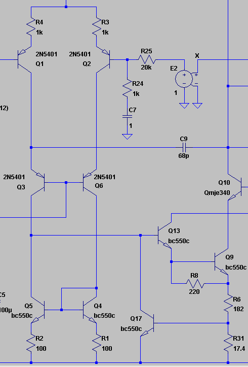

Hê hê! nobody can know the "lovely resistor" ! It is Emitterresistor of VAS , another pin of it connects with CFB diff
mike! I use b649/d669 for VAS .I intend to use a1011/c? .I also want to simulate it but I can't found its model

MikeB:
are you saying you added two series R-C networks, one each across R10 and R11?
if so, what values did you settle on to eliminate the oscillation also, after doing this, did you remove or change any of the other countermeasures you previously employed to remove the oscillations?
and, did you ever try CCS in place of R10 and R11? Did you still need the R-C networks in such case?
thx,
mlloyd1

MikeB said:Hi !
I stopped oscillation by simply adding a RC from emitter of cascode
to rail. Like in my previous amps: Oscillating ? RC always fixes it !
to lumanauw: I planned the ccs for the Vref, but not much place left
on my testboard... But by connecting both vrefs and avoiding going
to ground, the vref is at least always symetrical.
I wanted to use leds, but i had to use what i've found in my box...
Mike
