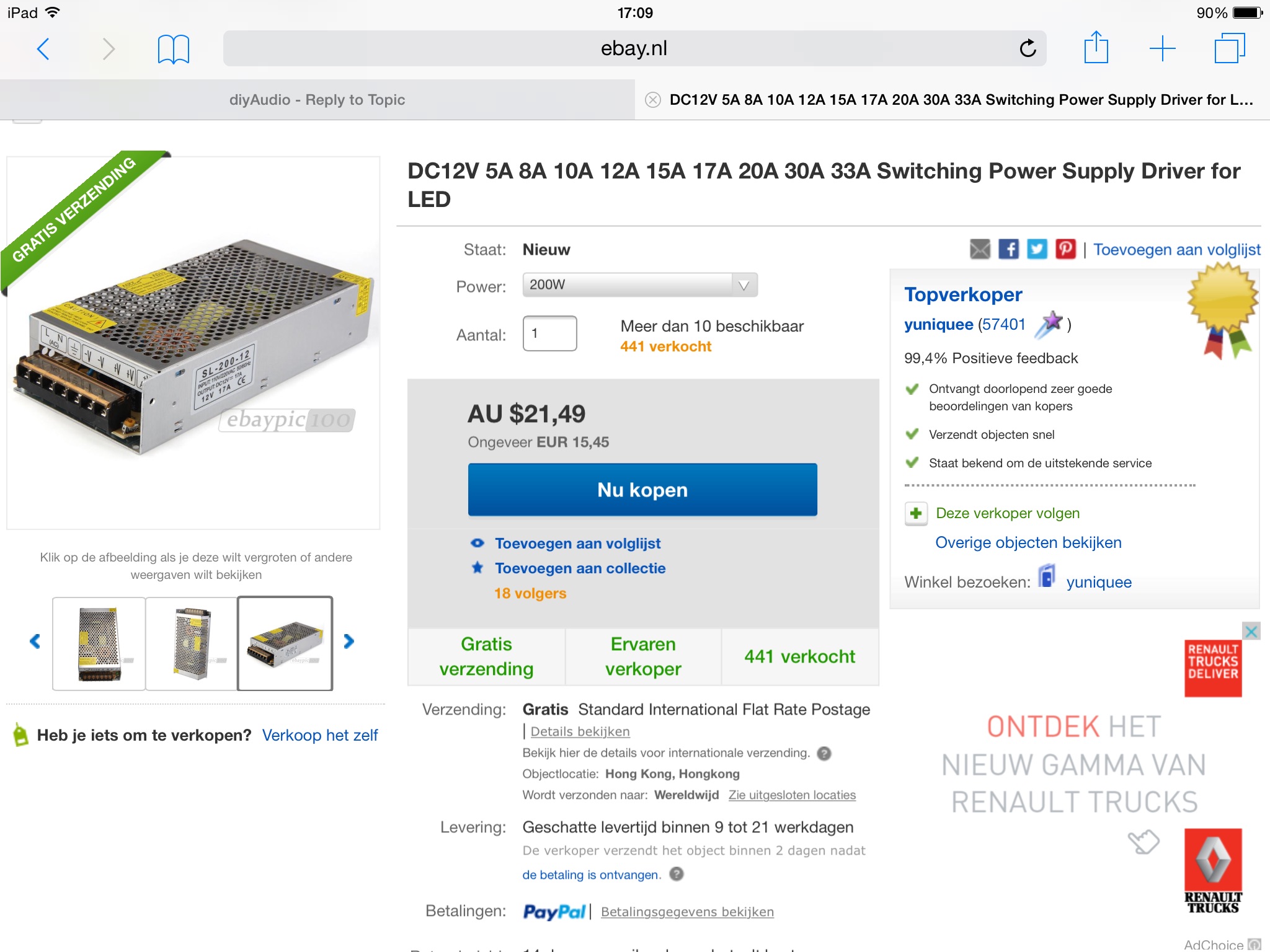

I use cheap chinese SMPS for the heaters in several direct heating amps. No hum or noise at all. at the moment i use a fu13(813) amp to.
I run the smps with NTC resistor to slow down the startup current.
Thanks for the info. I think I will go that route too.
A small caveat: Beware of the SMPS's that have a specific overload protection mode, called the "fallback" or the "hickup" mode. Such ones may have difficulty starting, or even may not start at all, when facing a "cold filament".
The unit I wrote found on offer, the Mean Well SP-150-12, or ... better yet, the SP-150-13,5 (13,5V) is of a different construction. It has a "Constant Current" limiting overload protection circuit. It simply does not "allow" more than 150W/12V or 150W/13,5V of current (+ some % margin) ever to flow. It acts as a current limiter.
Therefore, I was thinking that if the GU-81 draws 10,5A, then the SP-150-13,5 would be ideal. With the current limit set at somewhere around 11A, it shall act as a natural "soft start". To add on top of that, I will go with the CLC filter, with some heavy uF elko to "slower" the voltage rise time, and bypassed with some small foil uF to shunt the kHz hash frequencies, if any. The L would be the ideal solution to loose some of the excess volts that come out of the device. The rest I shall loose on the interconnecting wiring and with the trim pot.
Do you have one SMPS divided for both GU81's ?
I will go with independent units for each of the tubes. I.e. four tubes = 4 SMPS units. The 150 Watt modules are the highest of the row which come without active fan cooling. If they will be loaded to not more than 80% of the nominal power rating, then within normal ambient conditions and with appropriate air flow they supposedly do not require any forced cooling, fans or stuff.

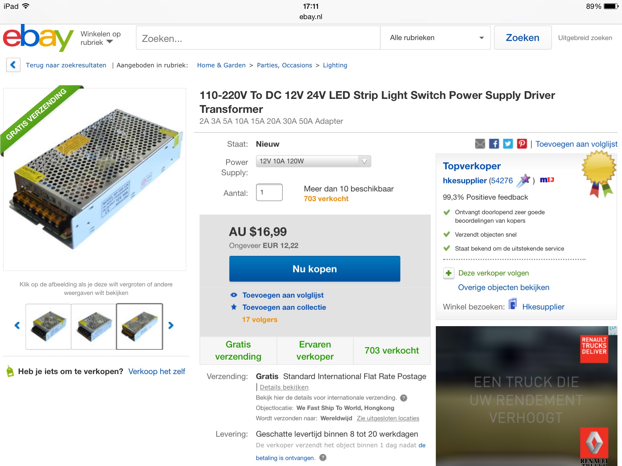

Can you suggest any supplier ?
I use one SMPS for FU13(120Watt) and one for GU81(200Watt). They are without active cooling(silent). Rimple(noise) is very low 10mv at 40khz on the heater. At the output not measureble.

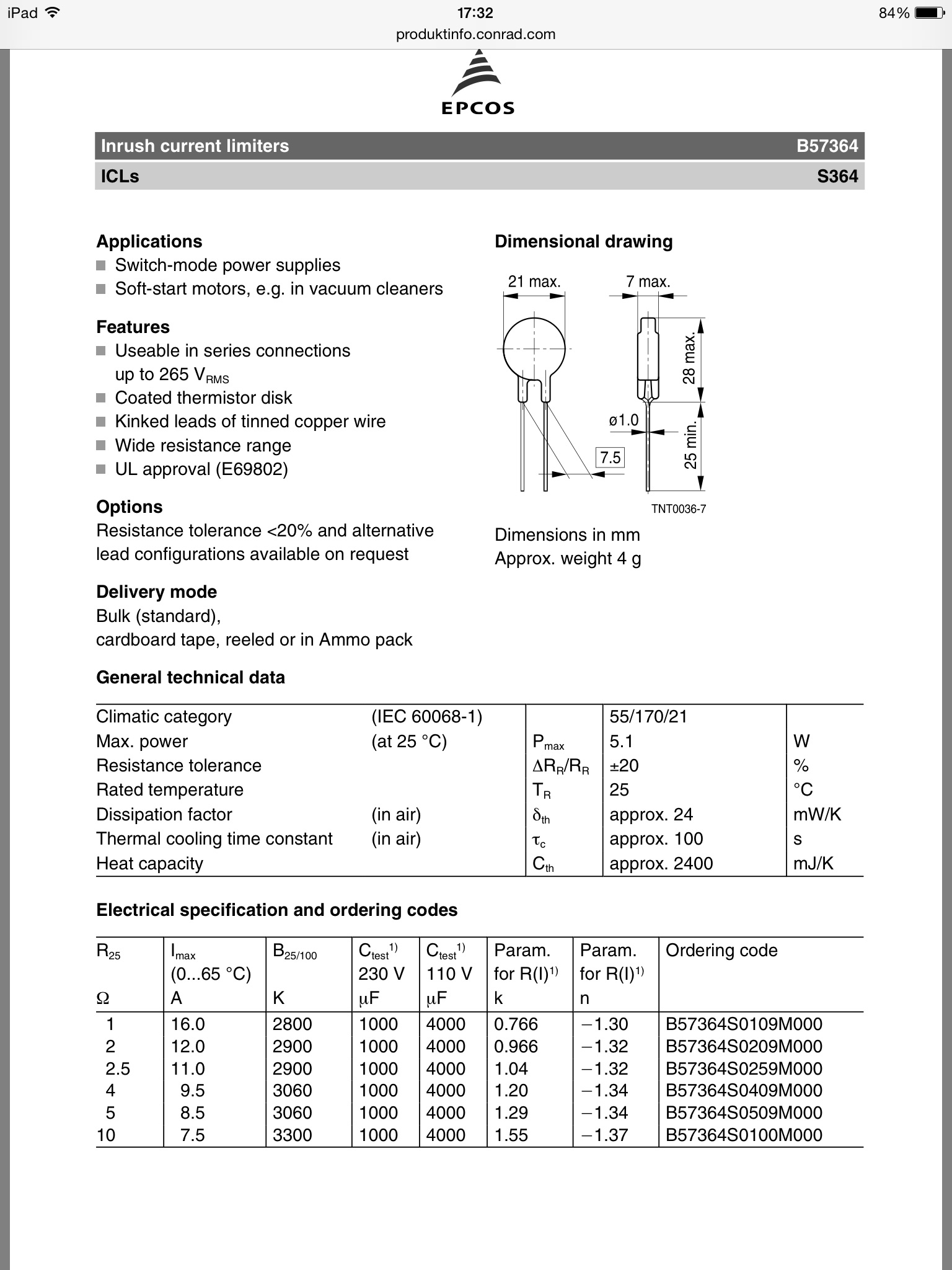

Just use NTC in serie with 12v supply. You then have softstart for cold heater. Works great.
I use one 2 ohm NTC for heater FU13 and two 2 Ohm NTC in parallel for GU81.

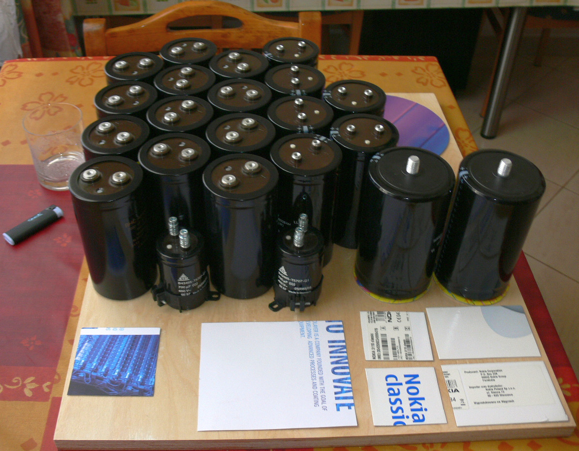

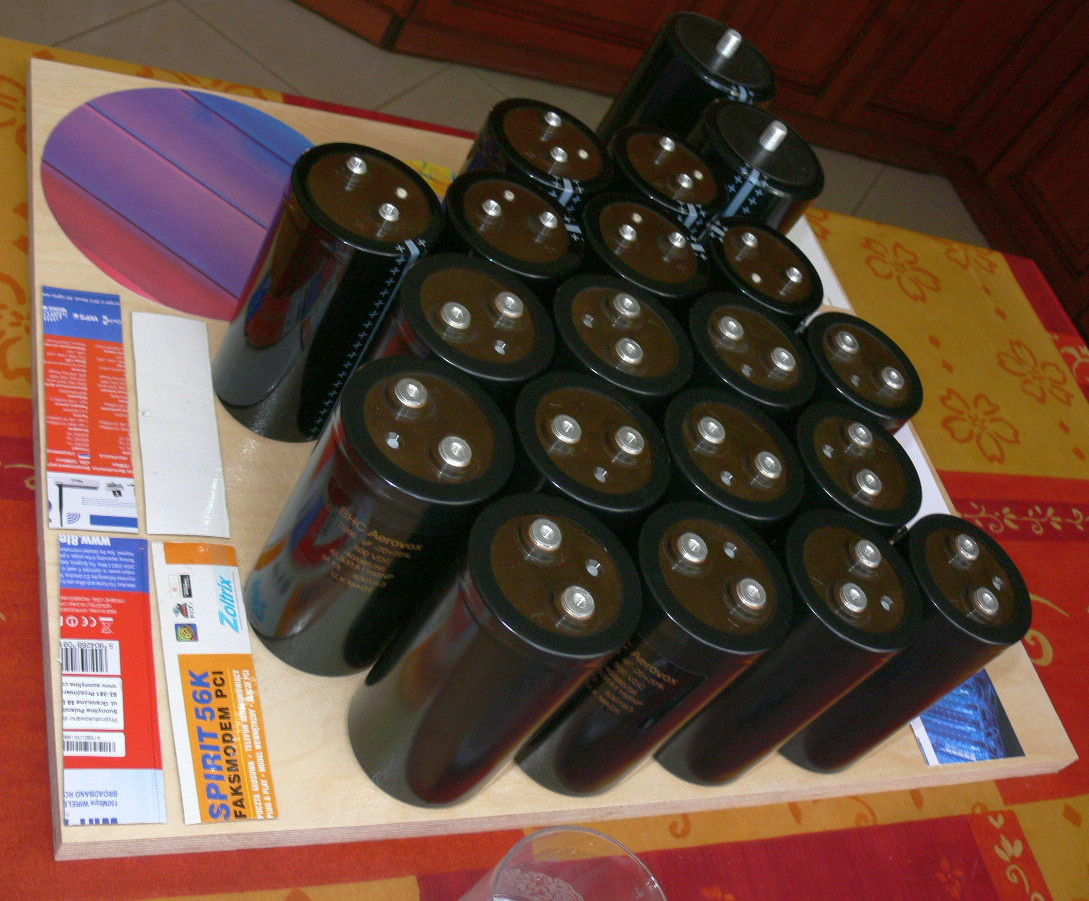

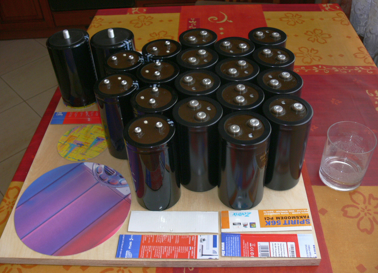

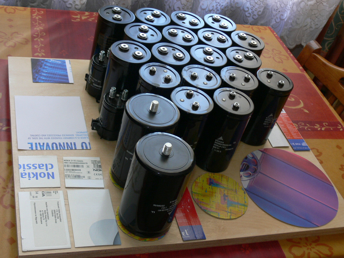

Started assembly of one of the monoblocks.
One of the element support planes (plywood).
The first of the two, the one holding the anode supply toroids,
the mercury rectifier heater toroid, the anode filter capacitors (as visualized) and some inductance to assist them …

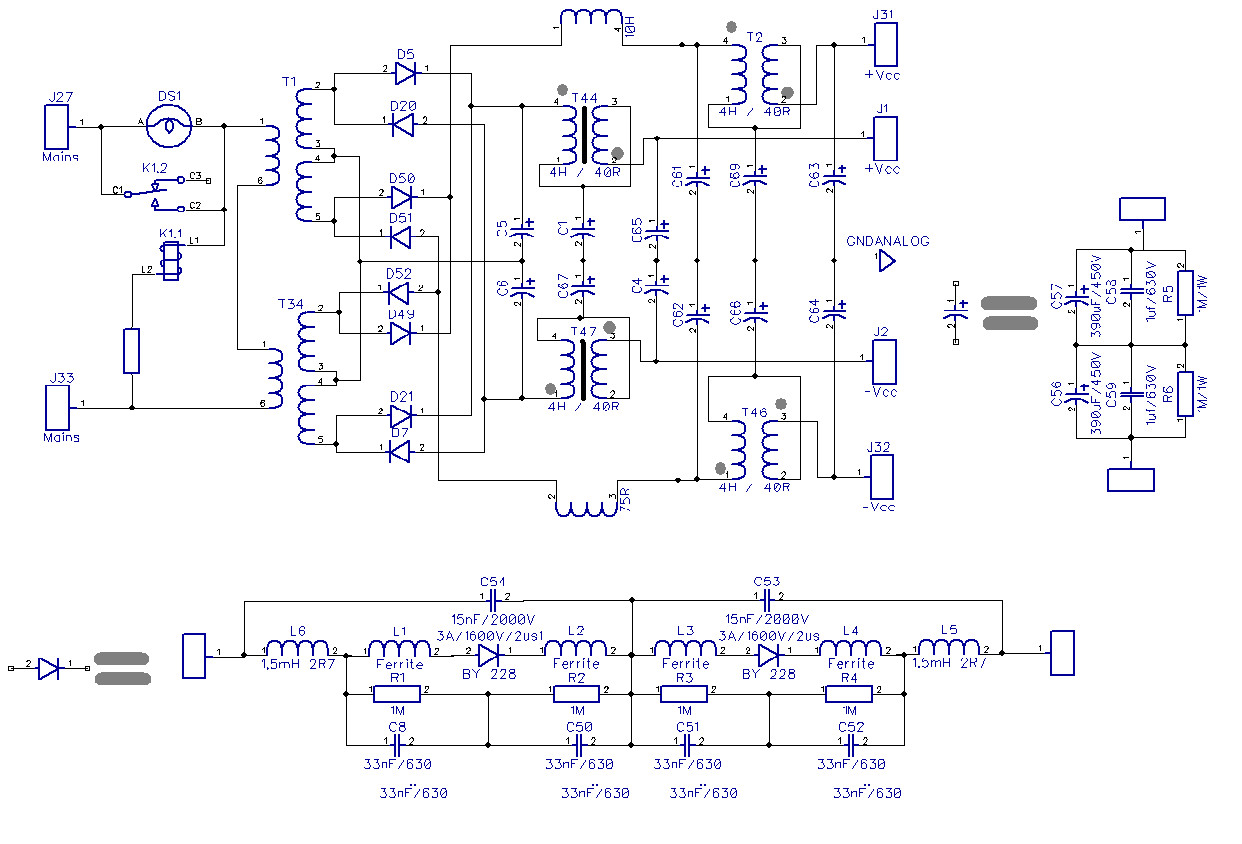

Zjjwwa,
do you have a schematic of the power supply?
Yes, but the old one was slightly haphazard / make-shift, so as to re-use some less than optimal toroidal transformers from a different project.
I will search for the drawing and pasted here in a little while (when I find it).
Anyways, something very similar to this initial concept:
http://hiend-audio.com/2014/08/18/low-dc-from-high-ac/
It basically uses two 1200VAC - 0VAC - 1200VAC transformers to obtain 1500V DC, but also .... 750V DC.... :)
For this new "V.2" version of the project, I ordered some more reasonable toroids with some extra / additional tappings, which provide for greater flexibility of use and playing around with them. Generally, the new PS will be based upon mercury rectifier tubes for the anode, rectifier tubes for the S2 ... and a small little "cheater" mechanism, so as to provide for safe start of the PS, so as not to fry the mercury rectifiers. Once I build the supply, I will most probably draw/design it.

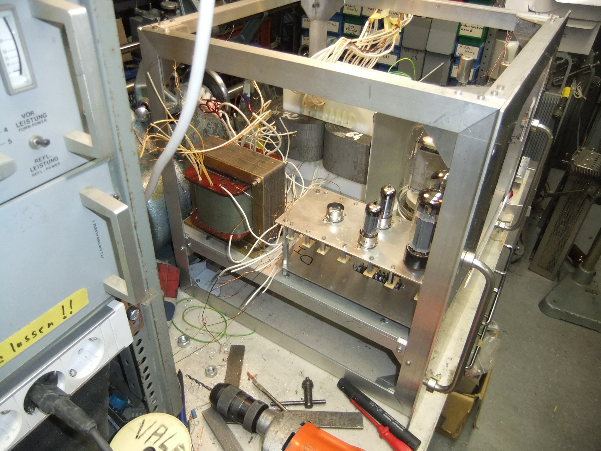

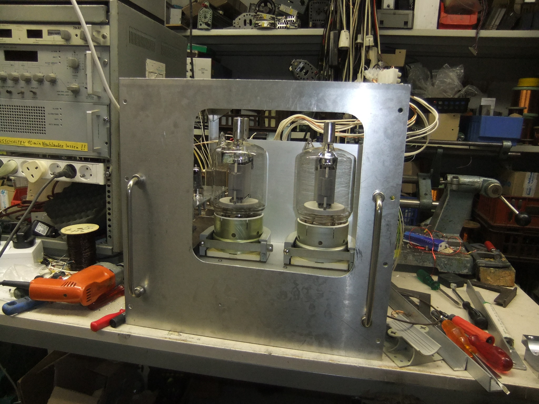

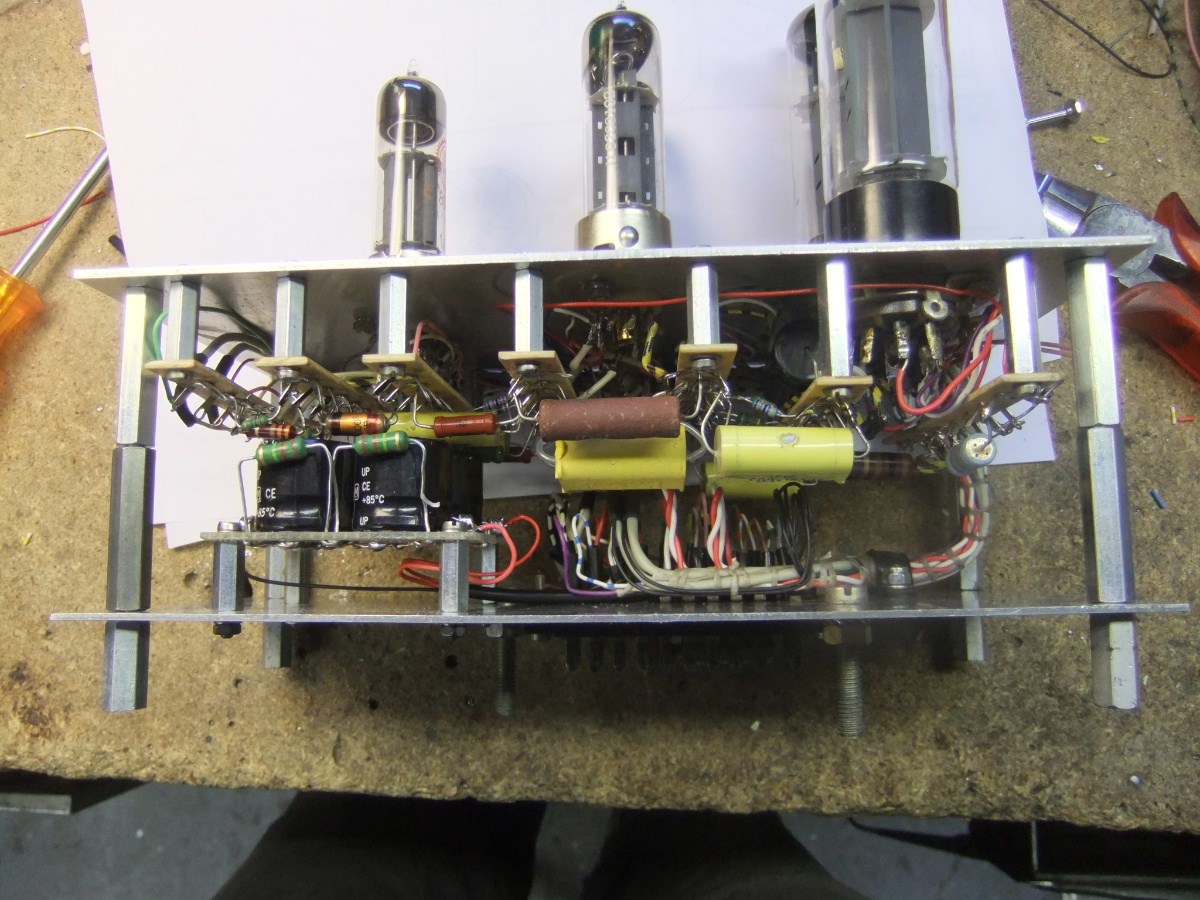

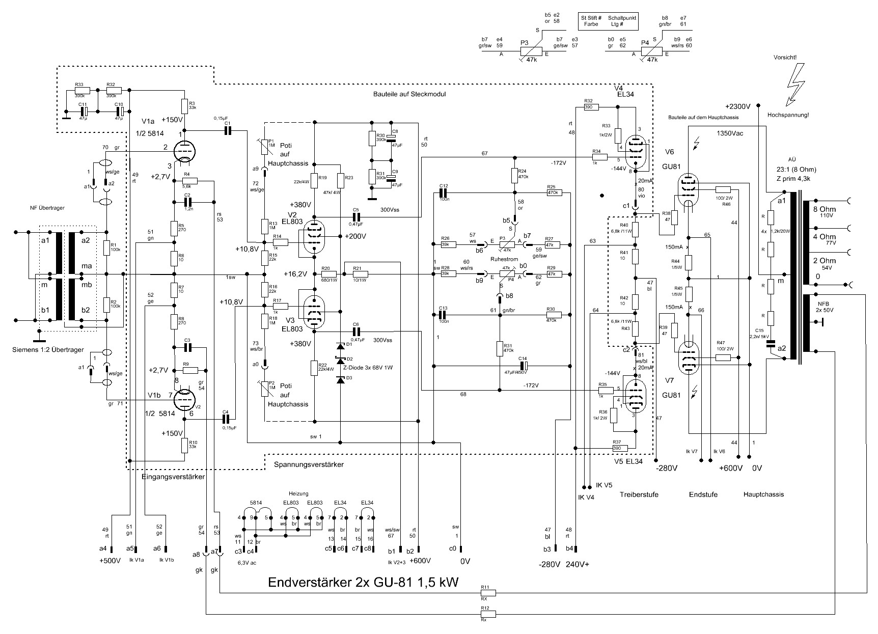

here I got another schematic with GU-81 P-P amp. Its a current projekt starting abt a year way back.
See pics below.
There still a lot of things to do, especially with the mechanics. The OPT is too heavy. It need to reinforce the chassispanel. I have only now realised what a huge task it is to build an amp of such caliber. But I started the game, and I will finished it
To do list:
Fitting the controls in the frontpanel and sockets in the backpanel.
Making a safegard circuít for the tubes, which looks after grid and plate .
currents and turns off when overloaded.
Fitting safety switches to shut off HV when open a cover while the amp is live.
Finishing the main power supply.
Cutting and drilling the side, top and bottom covers.

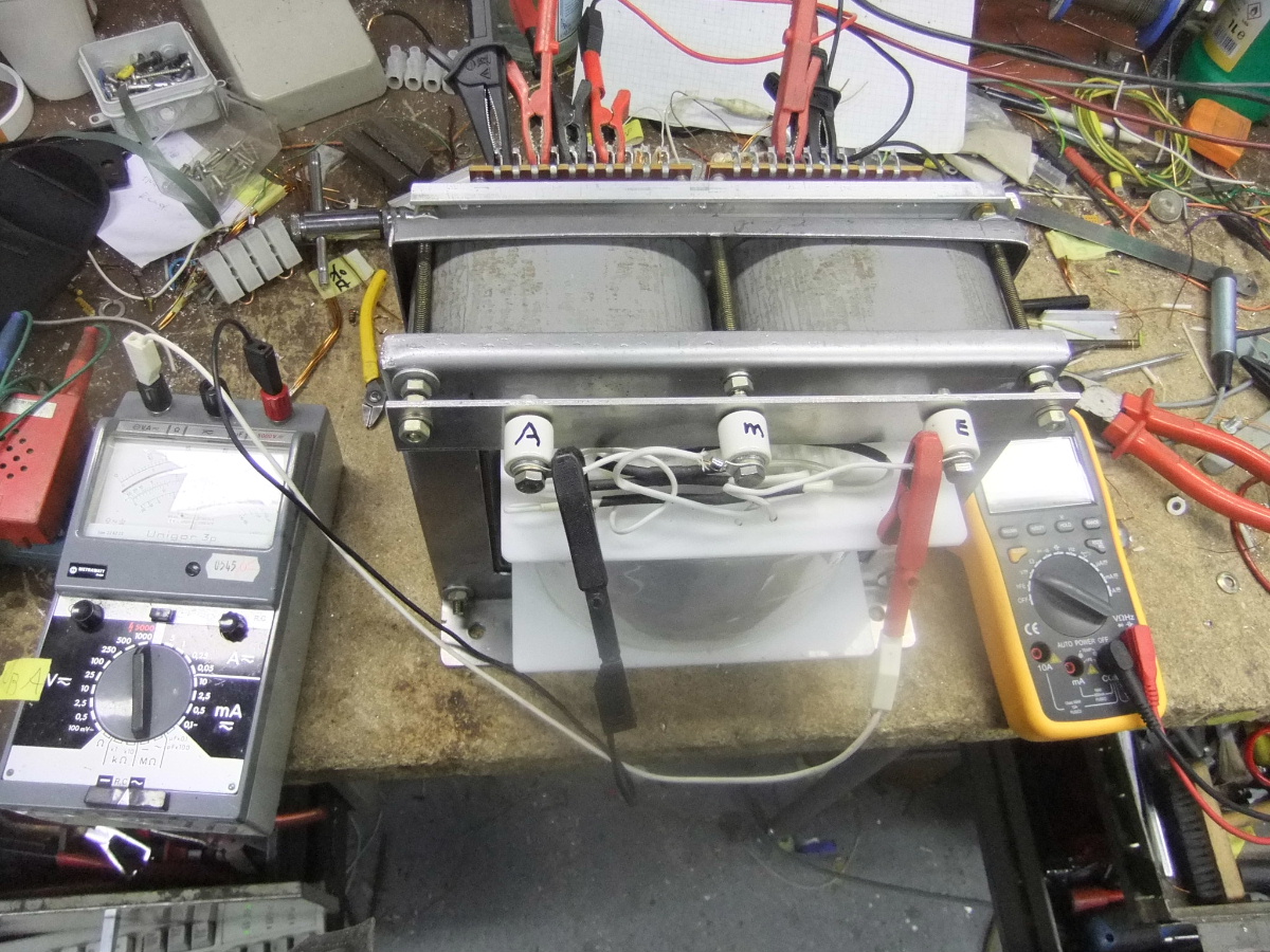

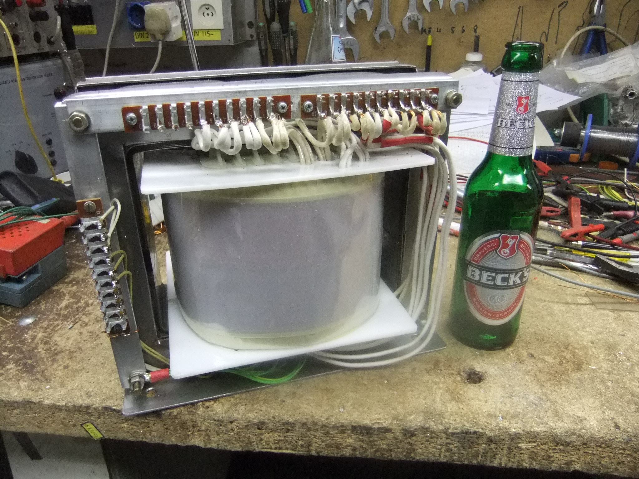

The amp putting out 1500W rms. It operates in P-P B2. The plate needs 2300V and 600V at the screens.
The aux mains transformer is also finished but I have currently no pics of it. Both the trafos are homewind . The opt is a SE231b core, the total weight is 34kg.
I will build the HV Power supply as a switchmode supply. It got its own housing. The amp need 0,9 A plate current at full blast. I made switchmode power supplies before, so I´m little familar with them.
The opt was the most time consuming part to make. Looking out for all necessary parts take also much time. Finally getting the core from a member of "die röhrenbude", a german tube enthusiast forum. Than I purchased all the wire, the insulation foil etc at a local trafo company. I need abt a week just only to get all the copper on the bobbin.

Hi, what kind of opt is in the 2kW edition. Is it self made or custom wound at a lokal transformer shop. Please show a pic of it.
My amp is nearly finished with the mechanical work. I coming up soon with more interesting work on it.
Bugger! I forget to fit center taps on the GU-81 filamant windings of the aux mains trafo. That means another half day for the bin.:(
73 Wolfgang DF6ZC
Self made but built to order for a transformer company near Hannover. They are doing high-voltage transformer checks with it. Only one socket blew up during 20 years period of duty. The control unit is a separate Rack containing 6 EL34 tubes.
The output transformer is a hand-wounded double 170 C-core. Our Aumann winding machine isn´t suitable for that size! If you want more Info, send me an E-Mail. I would like to see your amp under working condition!
