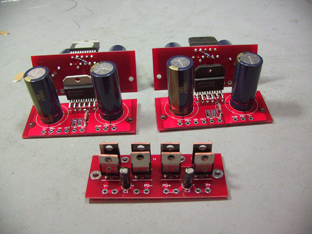

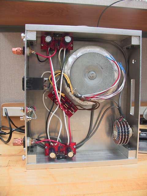

I attached a picture of the current amplifier build process. It is mostly done. I had the chassis done from my last gainclone, which I gutted, and managed to get the boards stuffed and the wiring done in about 3 hours, while taking lots of pictures. I also taught my fiance how to solder during this time, and she stuffed 4 channels today, and is working on a power supply board now.
Good news for those who just ordered PCB sets, as I will include a set of standard resistors to go along with each pcb set (4 x 22.1k compact metal film, 2 x 221 ohm compact metal and 2 x 680 ohm carbon film) See a picture here of the resistors that will be included with the pcb sets:

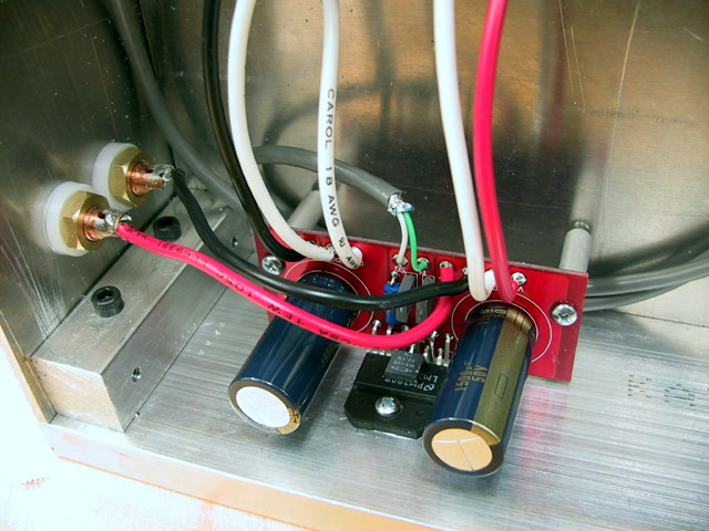

Here is a closeup of how the board is wired up.
On the previous picture, ignore the extra wires coming out of the transformer, as they were originally there for a fully integrated solution with a digital volume control, but I scaled this down to a simple passive solution, and they are un-used windings.

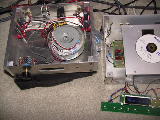

I finally got around to hooking up the amplifier with the new boards that I put together earlier today, and it works great, and sounds good. I will do some more listening tests tommorrow.
Everything works great, with no problems at all. This sure simplifies the building process for a gainclone.
Here is a picture of the working amp (same as earlier picture, but hooked up my cdpro2.
The part that I like most about this amp, is that there are few places to mess up. I am working on the instruction manual now, to make it super clear on how to put this thing together, even for the beginner.
