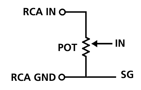

Alcaid said:
Where do you ground the pot on your boards? Shouldn't the pot be connected to signal ground?
For my boards, the signal goes in from the RCAs, then into the pot, then into the board. The input ground goes directly into the board signal ground. There might be confusion, because I used shielded cable in my gainclone, where you only ground one side of the shielded cable. The shield is connected to the ground rca jacks.
Let me know if there still is confusion.
Brian
Something like this?
