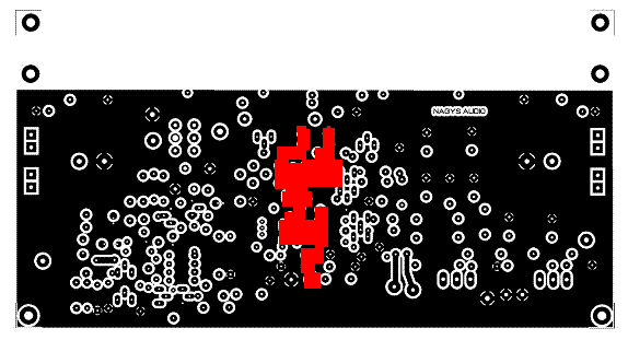

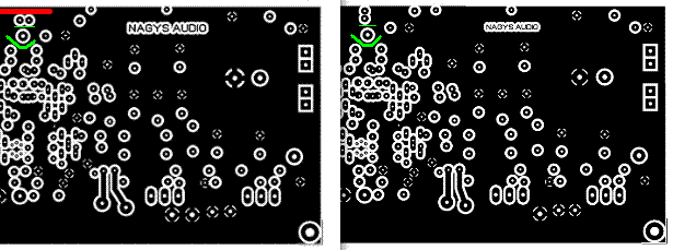

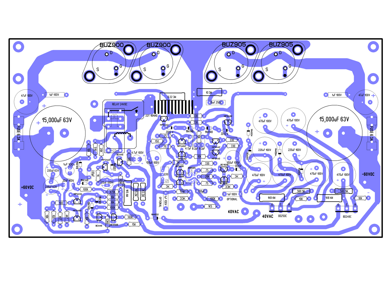

Cool!Godfrey - I made some changes according to your suggestions. I'm going to leave the 1uF/100V capacitors where they are... The temperature near the MOSFEST will be high and it's better if these caps are slightly positioned away from the transistors.

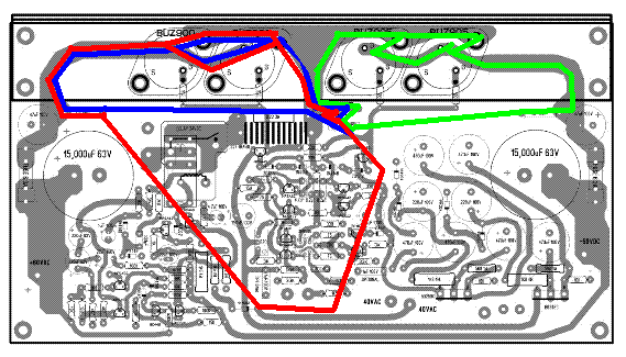

BTW the reason I suggested moving the zobel is to open up the red current path, otherwise there's only the green. Better than nothing, though.

Godfrey - Moving the Zobel is not so easy, as everything else will also have to be moved. Is there any reason why having this current path open is so important? There are many other paths (very thick traces of the ground plane) where the current can travel. Just curious. Even if the Zobel is moved, this track will never be as thick as some of the others, so the current will mostly flow the other way regardless.
Not trying to be combative or dense here, but doesn't this method just place the resistors across the two source bolts of each mosfet? Wouldn't you need to put the resistor from source to output? Wouldn't you would need to cut the trace around the bolt that connects source to output?
If you isolate the bolt that is connected to the output from the case, and then connect the the two bolts (the other bolt is not isolated from case) with a source resistor then I think you have achieved what you are after.
No, just the zobel. See 2'nd pic in post 35.Godfrey - Moving the Zobel is not so easy, as everything else will also have to be moved.
Yes, but only round the front of the board near the input, not across the back. The middle section (colored red in first pic below) is very dense, with no current paths across from left to right. That's why I was trying to open up a path across the top.There are many other paths (very thick traces of the ground plane) where the current can travel.
Yes, at low frequencies. I was thinking of high frequency stability. Second pic below shows the high frequency current paths for the output devices. Green on the right is for the P-channel devices. On the left, red shows (roughly) the old path for the N-channel devices, and blue shows how it is with a copper track across the top.Even if the Zobel is moved, this track will never be as thick as some of the others, so the current will mostly flow the other way regardless.
Reducing the area of those loops is a good idea as they are effectively inductors in series with the decoupling caps. That's also why I suggested moving the decoupling caps - to reduce the loop areas, which reduces the inductance.
I'll admit I'm just being picky with all of this. It will probably work fine as it is.

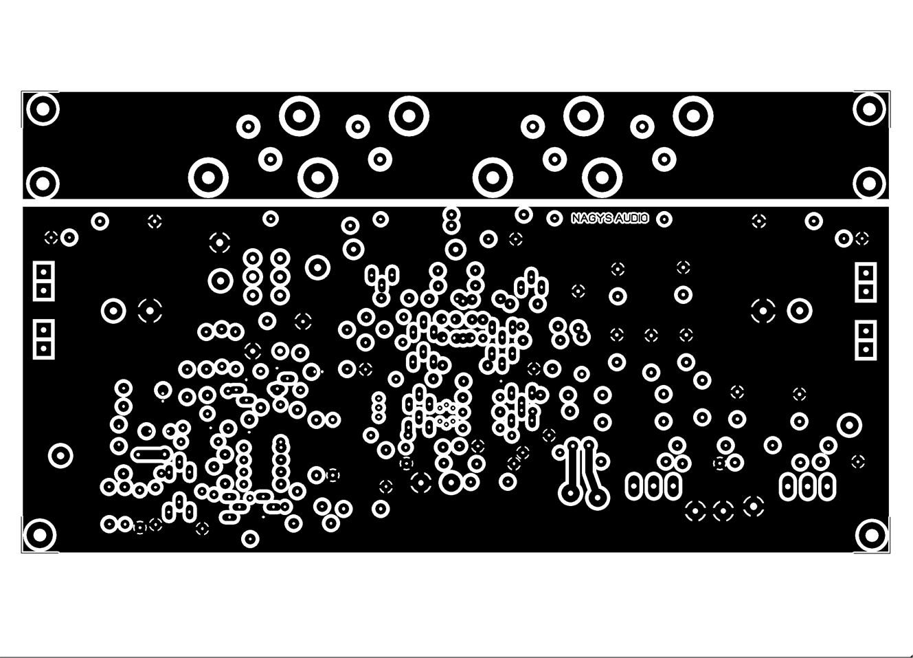

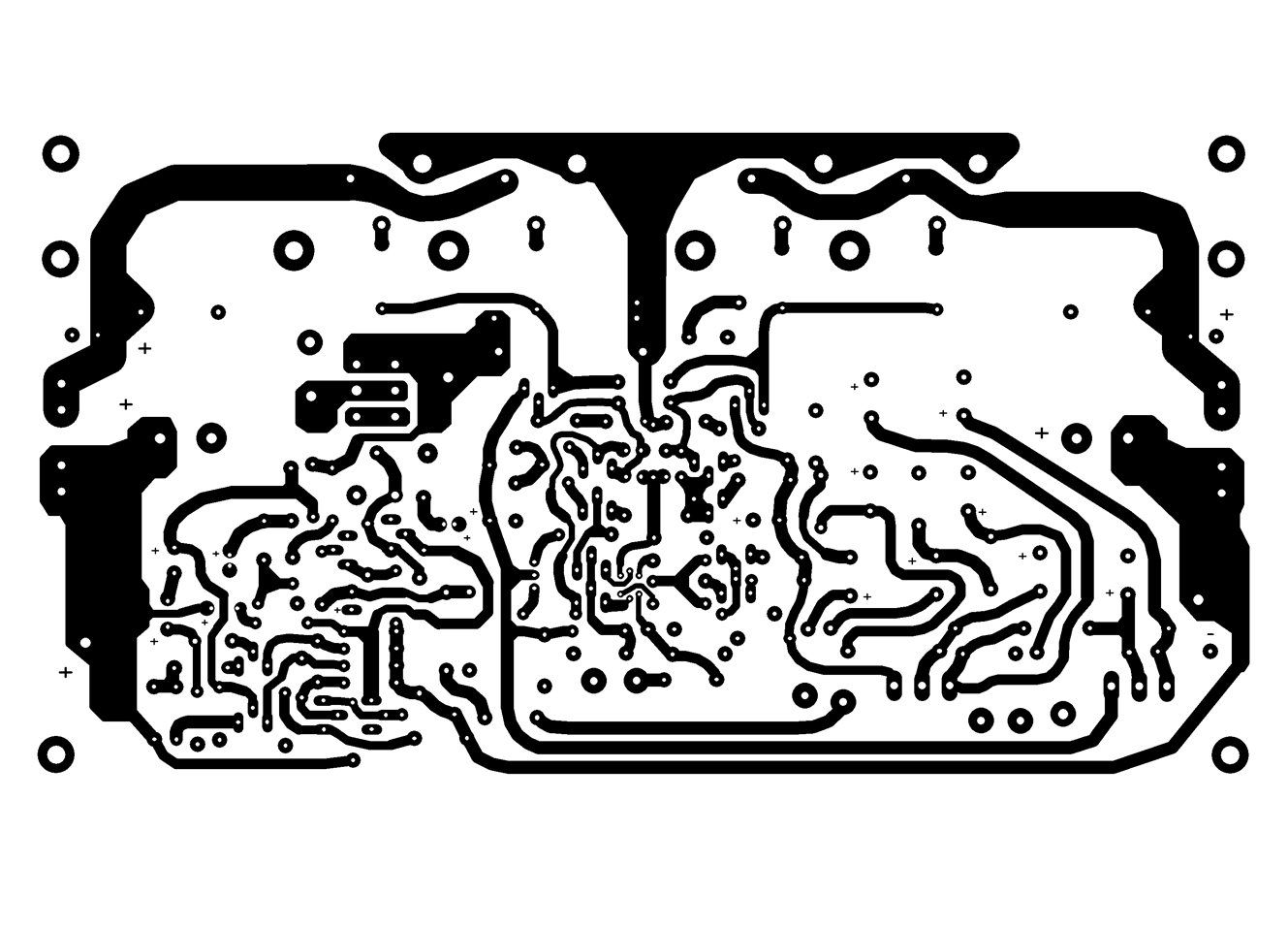

Submitted the PCB layout to a PCB manufacturer for a quote. I'm ahead of schedule! I should be able to place the order by the end of this week, or early next week.
Final board specifications:
- FR-4
- 1oz. cu.
- Lead free solder finish
- Plated holes
- 2 layer (double sided)
- No silkscreen printing
- No solder mask
- No solder paste mask
Here are the pictures:

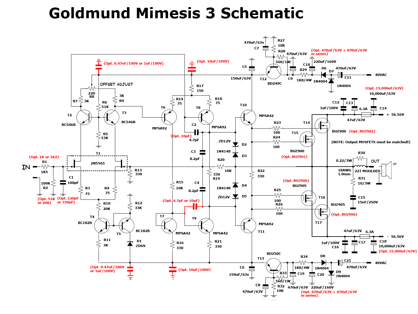

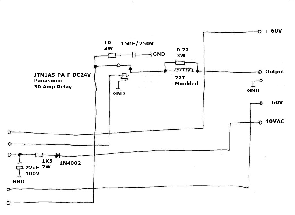

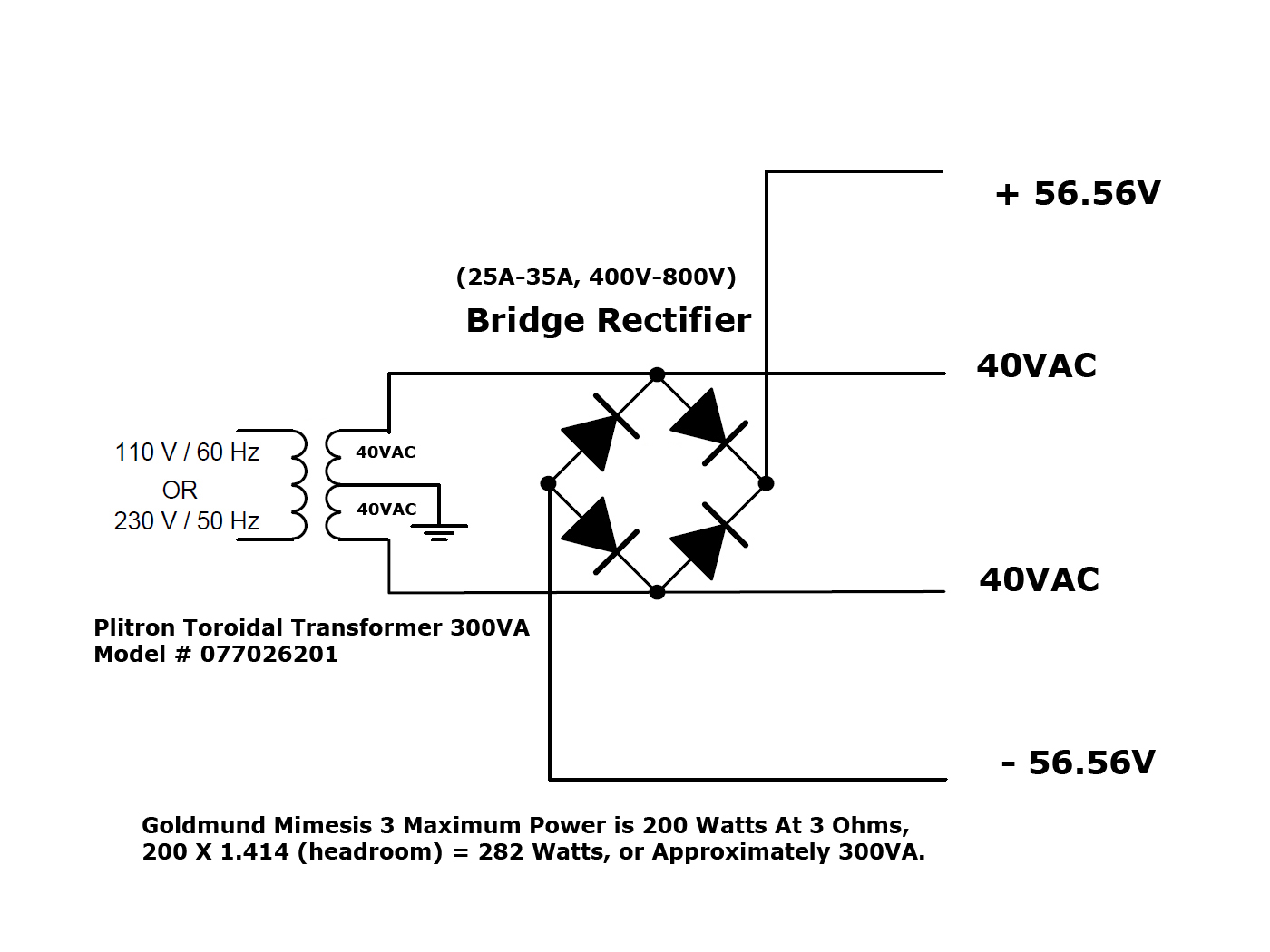

Goldmund Mimesis 3 Clone's Part List
Here's the entire complete parts list. The only items that are not included are chassis' hardware (aluminum bar stock plates, bolts, nuts, washers, nylon washers, locking washers, etc.). My next post will be pictures of the raw PCBs. I should get them in the next week, or so.
