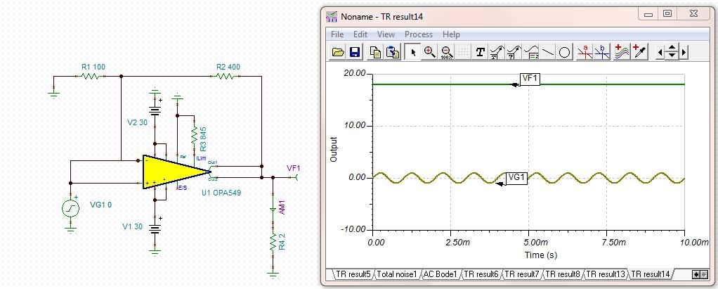

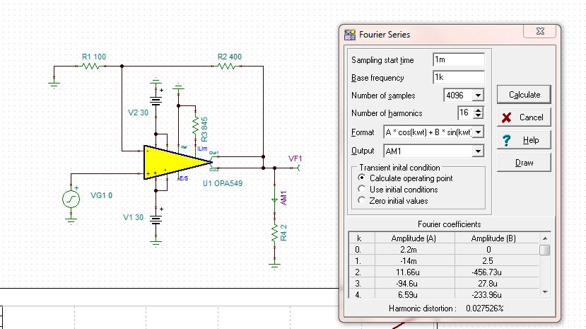

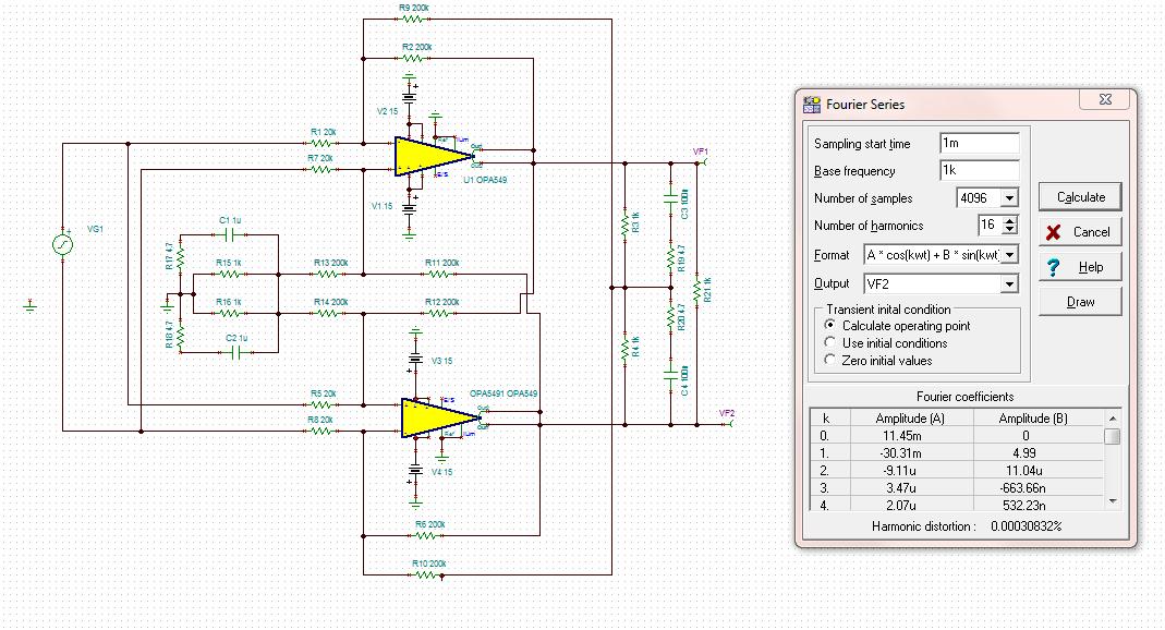

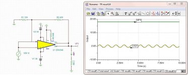

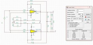

I wanted to see what i could learn about Wen-San's design by doing some modeling.
The first question I addressed is: What is the THD in the opa549 in a standard non-inverting configuration and Wen-San's design.
The difference in THD between the two circuits is significant enough that it it seems likely that the result would carry over to a real circuit.

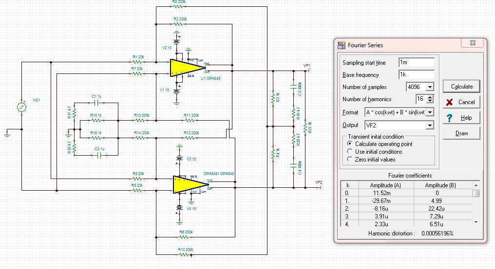

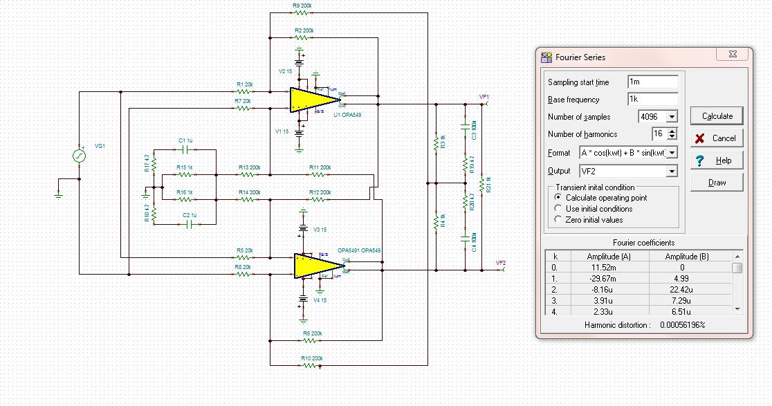

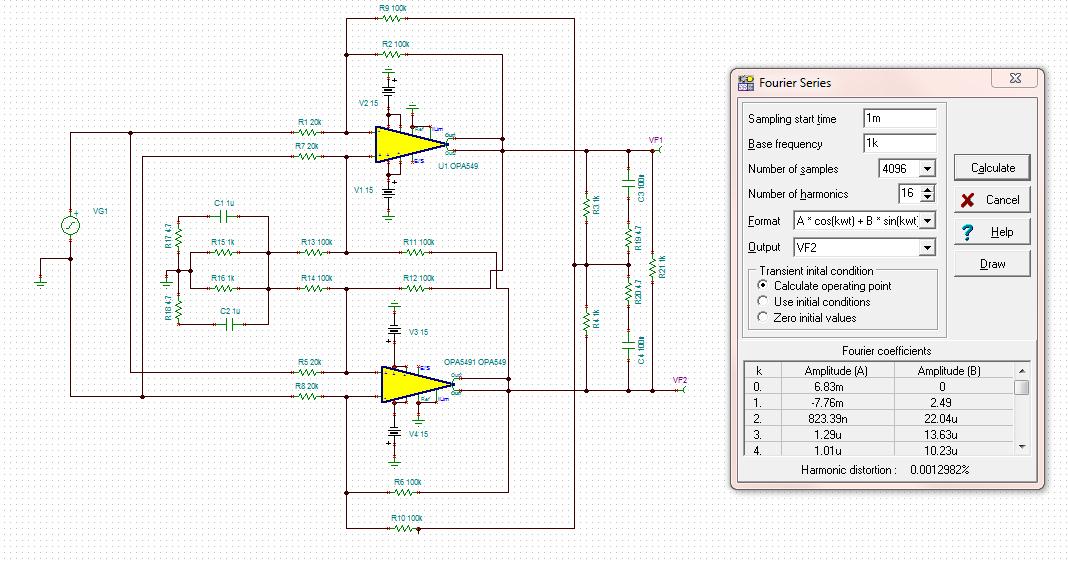

I next wanted to investigate how sensitive the circuit was to ground noise. The standard instrument amp circuit only has a virtual ground, however, Wen-San's design gives up the virtual ground for a real one.
I tried a very large ground "noise" (1V amplitude 2khz).
It increased THD, but given the amount of ground "noise", I'd say the circuit is quite insensitive.

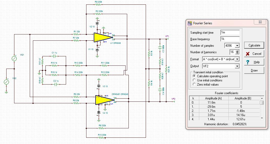

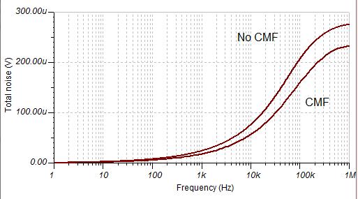

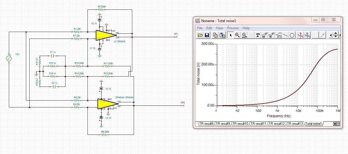

Finally I wanted to look at the effect of common mode feedback (CMF) on Total Noise.
I simply removed the common mode feedback from the circuit to make the comparison.
I also wanted to see how sensitive Total Noise was to small variations in resistor value so I adjusted the 200K resistors randomly between 199 and 201 K. This change did not effect the Total Noise measurement.
I suppose the true test would be to put some common mode noise at the input. I still need to figure out how to do this but I wouldn't mind if someone beat me to it.

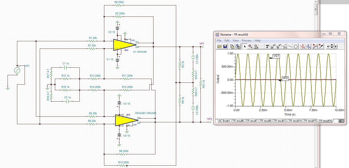

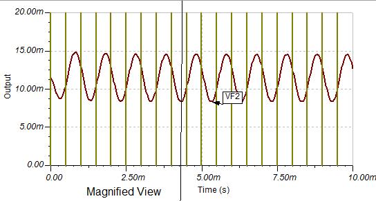

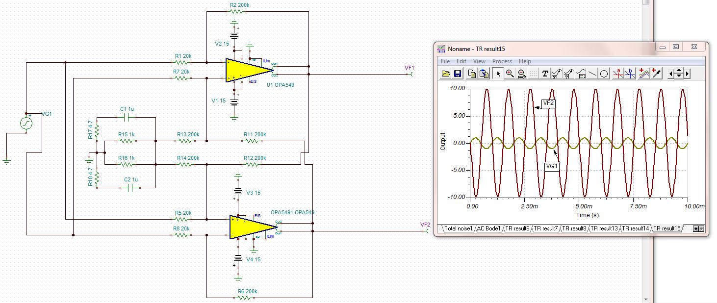

CMMR tests
Below I've attached the the common mode response of 3 different configurations:
1. standard non inverting OPA549 (same gain as other configs)
2. Wen-San config without common mode feedback
3. Wen-San config with common mode feedback
in all cases the input is 1V, 1khz to both the inverting and non inverting inputs.
the final image is a magnified view of the transient response shown in 3.

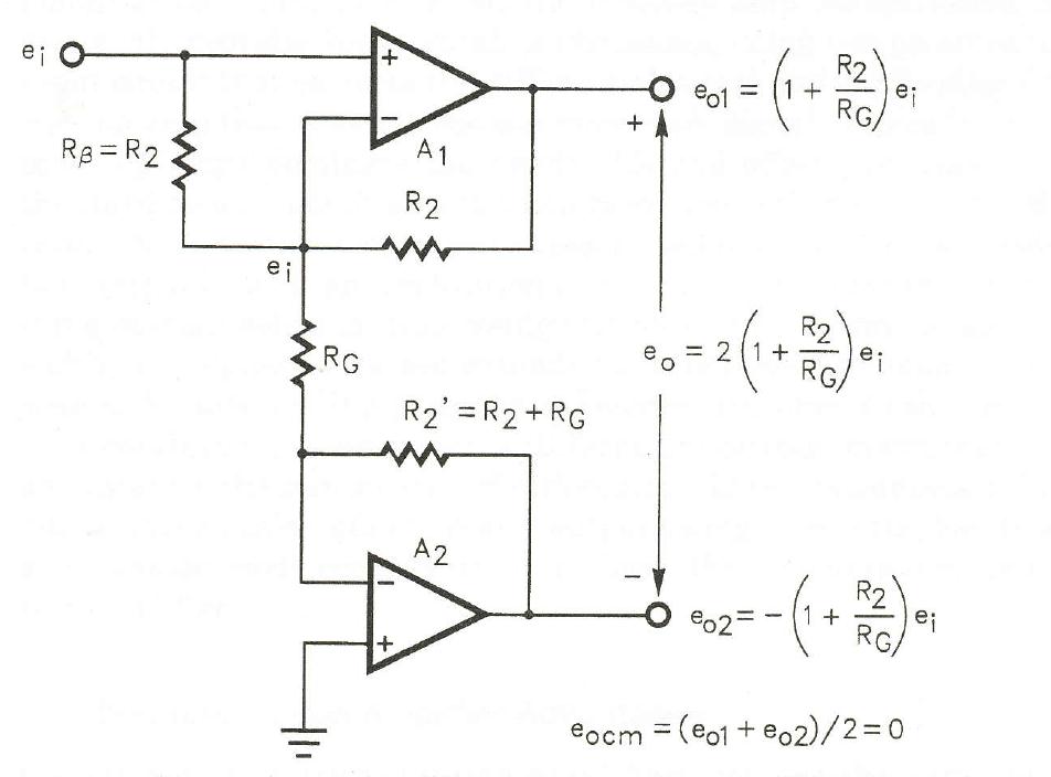

I think I need my input stage to handle the single ended to balanced conversion.
With the circuit posted immediately above i can obtain conversion by making Vi2 a ground.
I also found a (see below) variation on the above circuit in Jerald Graeme's book: Amplifier applications of op amps. It removes some of the common mode signal that that the above circuit can create but it only works for gains of 3 or higher.
On a separate but related topic, it seems that lowering the gain of Wen-San's circuit with OPA549 caused THD to rise.
