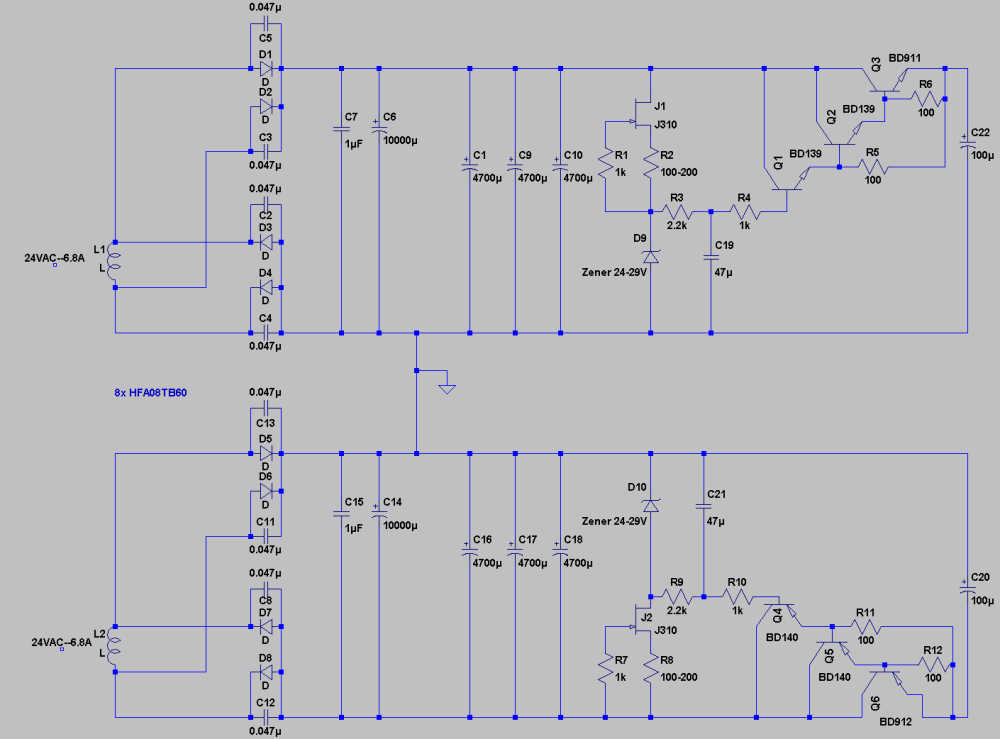

Thx Terry, it really sounds reasonable to lower the voltage (esp. into 4 Ohm load) and i decided to use the PSRR dicrete regulator without global feedback by Pedja Rogic. With 24V AC 350W Transformer and some ordered 22-26V Z-diodes.

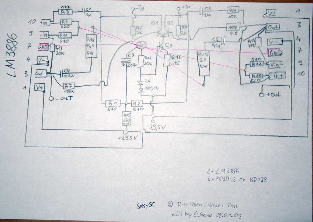

juma said:
Gono, don't forget the ground connection - see attachment
Viel Spass dabei !
Thx alot juma! i fixed that and made the layout a bit more stargrounded & P2P like. Also R14 was 100k instead of 10k in last sheet.
And i found the perfect fitting case, (You will be surprised) the right sized heatsink and i should have all missing parts on my table tomorrow...
Feel free to crosscheck the attached circuit against Terry Aben circuit

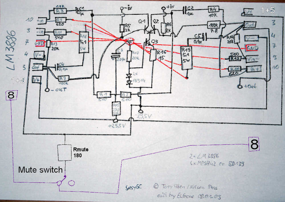

juma said:It looks better now - just 2 things more:
- pin 5 of LM3886 should also be connected to V+
- pin 8 of LM3886 (mute) should have at least 1mA flowing through it (otherwise it won't play)
It's all in datasheet anyway
Thx! the mute switch i had on the switches-drawing, but you're right, they should be included in this drawing too, as well as the Pin 1+5 mark.
R9/11 & R10/12 now also going to starground.
Is it okay to use one switch for all 4 LM3886? The value must be recalculated...
Yes, you can. Just take care that every chip gets 1mA through pin 8 - take a separate resistor going from switch to each chip.
Gono said:
Can i use 2 Zener Diodes in Series? like 24V+5V=29V ? is there an order to keep in mind?
Of course you can and order them as you like, but if you want exactly 29V on output of regs you have to account for transistor's Vbe. Take 24V+6V8 zeners - that'll do it.
OTOH, your transformer gives only 24V AC on secondaries. If I were you, my zener would be just one 24V (28V at most) - you'll have to allow for some regulation losses and electrical network instabilities.
Yes, you wrote that you have 33.5V DC unloaded, but it will drop when you turn a volume knob a bit, so it's better to stick with worst case scenario - you don't want any more amps or regs going in the smoke, right ?

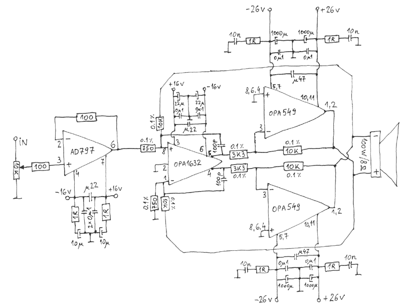

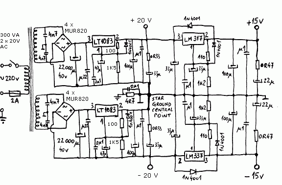

When it comes to using SuSy concept around chips my ears were most satisfied with this circuit (National chips were second to it):
For your application you can use +/- 20 V rails and be happy with 50-60 W / 8 Ohms (even 4 Ohms load don't cause problems - I tested it on my Epos M5 speakers with LT1083 reg. supply for OPA549s). Just be generous with heatsinking if you like playing it loud. OPA 1632 is natural born SuSy diff. amp. and can be pin-to-pin replaced with THS4131 (both Texas instruments). AD797 is just a buffer stage and can be replaced with any buffer of your choice capable of driving 600 Ohms load.
okidoki, i did so with 4 10k resistors.

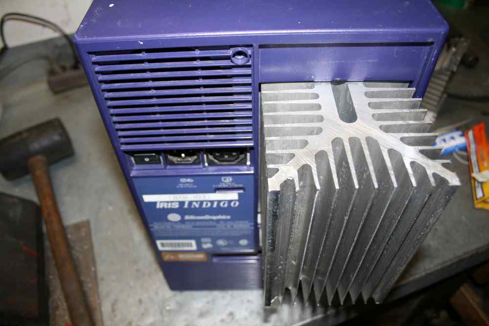

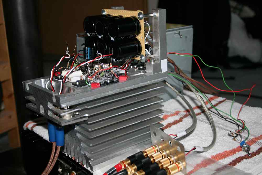

Well good news first: it's up'n'running It nearly took a week, but it was worth it! I still need to finish the chassis, it will look great and i hope to finish this project this weekend! Pictures will be updated then.
I build it with 24V Zeners and get about +/- 23,8V (both rails nearly same value). It was build strict P2P mounted directly on a (way too huge) heatsink. The heatsink i wanted to save for the "amazing circlotron" but as i don't have money for a set of new transformers atm i decided to try this "cheaper" project first. And so far i'm not disappointed. The midrange is really clear and but not too analytic as i can tell from still "burning in" the amp. I was missing some bass when driving it with symmetric input, but i just had an isolating transformer for symmetrie generation so far and think that was the reason. Then i changed to asymmetric input wich gave a bit more pressure in lower frequencies but at cost of midrange detail. But i don't want to bore you with sounding impressions of an amp, wich is still formattig its electric soul.
But with asymmetric inputs another problem occoured: The amp went into clipping quite fast! I did not ran it extremly loud (couch was not vibrating) and i was wondering why. As i mentioned i use 4 Ohm speakers (Nubert 380's // 2 way compact-speakers) with impedance-linearization, wich like to suck some current.
So there are 2 more questions for improving the circuit to my environment: If my impedance does not went much below 4 Ohms, should i increase the voltage by using 25-28V zeners? Hope to get some Zeners tomorrow to answer the question myself... but opinions are welcome. Datasheet says increasing supply voltage from 23 to 27 V should increase output power from approx. 42 to some 70's VA as well as the clipping voltage should went up 0.5V

attached a pic of first test run and you'll find some more (full res.) in the gallery

Rodeodave said:Wow , incredible design. Dead Bug Deluxe.
Did you do sketches on paper first to get the proportions or did you solder en route? Echt geil.
Indeed, think i should put some varnish on as final step to save bugs life! And yes, i planned the layout on paper as the complete circuit. Wanted to do it 0ld5k3wl like back in the days without pspice flavour. (besides circuit was discussed/calculated in detail in this thread)
