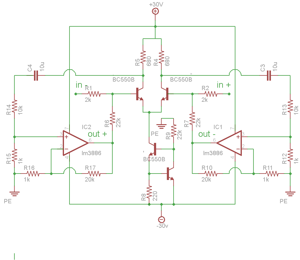

hi,
i want to change my previous bridge gainclone base lm3886 with this SuSy gainclone.
can i use my schematic below? ztx450 replaced with bc550.
need advice..

Hi zei,
here is the schematic with fully-differential (balanced) input.
I left out the PS coupling parts and pinout of chips, you have them in schematic in post #672.
Some part values are different in this new sch. - don't worry about that, the amp sounds better this way.
Cheers !

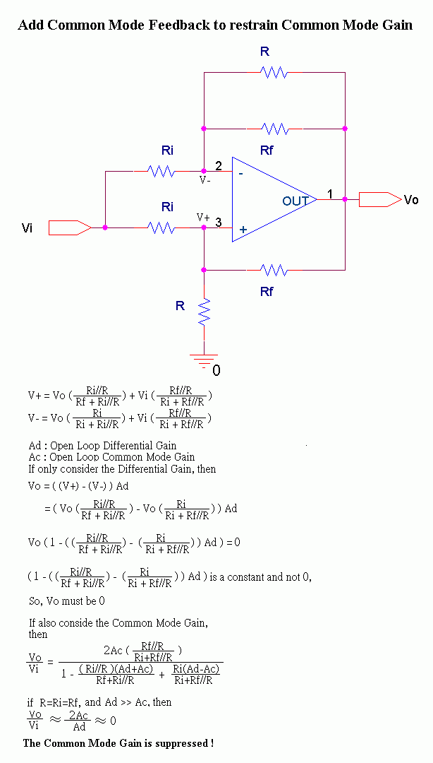

The Close Loop Common Gain still remain 1.
The Close Loop Common Mode Gain is not suppressed.
Separate it symmetrically become a Fully Differential Amplifier with Common Mode Feedback.
I had built such "Ultra Symmetry" circuit as a pre-amplifier and a power amplifier in Taiwan 5 years ago!

I don't think using OPA1632 to drive 2 OPA549 is a good idea.
The slew rate of OPA1632 is 50 V/us.
The slew rate of OPA549 is only 9 V/us.
There is a contradiction on speed, and there is a stability issue apparently.
I would rather use OPA1632 to drive 2 power buffer.
The open loop gain of OPA1632 is 78 dB.
The open loop gain of OPA549 is 100 dB.
And the common mode feedback of OPA1632 can not include the output of OPA549.
I would rather use 2 OPA549 to make a Fully Differential Amplifier with Common Mode Feedback.

This circuit structure has no gain.
If the OP amplifier isn't a unity gain stable amplifier, it will have stability problem.
Beware !
