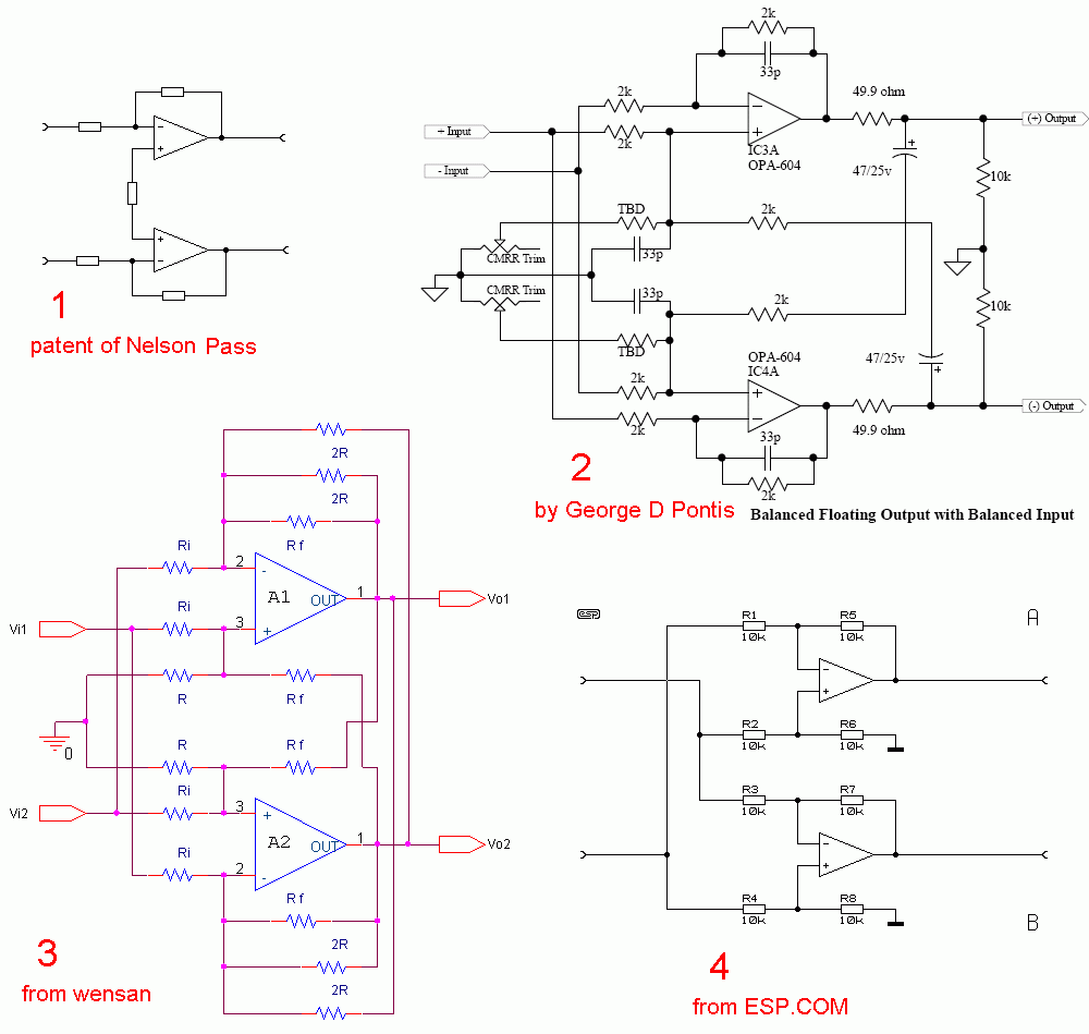

I want to use IC(lm3886, lm3875) to build a amplifier,
and I found four balance circuits :
1. SuperSymmetry of Nelson Pass
http://www.passlabs.com/downloads/articles/susy.pdf
2. A output topology based on a design by George D Pontis
http://www.forsselltech.com/downloads/schematics/BalOut1.pdf
3. Ultra Symmetry of wensan
http://www.diysong.com/images/ultras/UltraSymmetryPreAMP.htm
4. Balanced Line Driver with Floating Output
http://sound.westhost.com/balance.htm#input-improve
I am freshman, and need help.
Can anyone explain which one is better and why?

BrightXA said:I want to use IC(lm3886, lm3875) to build a amplifier,
2,3 and 4 are essentially the same circuits, implementing
balanced operation of opamps. 2 and 3 take feedback off both
the local and opposite outputs.
Circuit 1 does not use conventional op amps, and so the diagram
is a bit misleading in that regard. You cannot directly use an
LM3886 or similar chip.
They all work, but the performance is dependent on the specifics
of the execution.

It's not an op amp.
What you see as the (+) terminal on the diagram is a low
impedance input, not the high impedance input you expect on
an op amp. Think of that stage as if it's a "current feedback"
amplifier, but with the output phase inverted.
You can't wire a chip amp this way and have it work.

Hi Mr. Pass,
Is it because +ve input for conventional opamp would be floating with circuit 1?
Attached is the instrumentation configuration with LM3886. It does not work. I assume that the differential signal passing through R1 e.g. 2K will somehow provide some virtual ground by splittting it into 1K-virtual gnd-1K. BTW does this circuit have the supersymmetric noise cancellation via R1?
Thanks.
