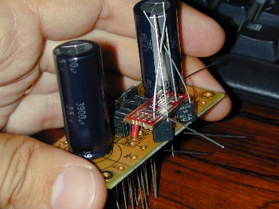

I have it!!!! Sucess at last!!!!
Ok Guys I have a new schematic a new layout a new outlook!
THS4131 for SuSy with global feedback works beautifully!!! Here is the trick.
The THS4131 has significantly more bandwidth in the working range we are constrained to (voltage wise) than the LM3886 does. As such the THS4131 is starved of feedback it needs at high frequencies because the LM3886 simply can't keep up in the loop. So the THS4131 essentially has infinite gain at frequencies above which the LM3886 can cope(due to the lack of feedback), thus the circuit become completely unstable and the THS4131 is actually continually clipping.
So, short story, the answer is to add a compensating cap but forming a closed loop only for the THS4131 (not in global feedback, this would actually make things worse). I did this by placing a 200pf silver mica cap between -in and +out as well as +in and -out of the THS4131. The rest of the circuit is unchanged.
The amp is perfectly stable now!!! No sign of oscillation at all!!!!!! Wooooohoooooo!!!! Just great music and nice silent noise floor.
There is a bit of phase shift of course but only at very very high frequncies, well beyond the audio spectrum.
I may try some lower values, but 200pf seems to be working great and sounds excellent.
Thanks for all of the encouragment and ideas! I am one happy fella.
One other thing to try would be the somewhat slower THS4121 which might need slightly less external compensation, and it's a cheaper part.

Hi Russ,I did this by placing a 200pf silver mica cap between -in and +out as well as +in and -out of the THS4131. The rest of the circuit is unchanged
no problem with the cap on the inputs of the THS, but shouldn't the output cap be behind R3/R4, as you are shorting the outputs of the THS on high frequencies otherwise?
HBarske said:Hi Russ,
I could be wrong, but then so would the THS4131 datasheet, as they do it as I do in their circuit on page 16. Notice cap C1 is directly connected from outputs to opposing(phase) inputs. The short circuit is not a problem until you reach output voltages that would cause excess power disipation. In this case we are filtering out high frequencies before they ever get a chance to reach levels that would cause the THS4131 to work hard.

everything's fine. I was on the wrong track (I should have read your post more carefully). I thought you wanted to place a cap between + and - output - my fault.
Congrats for getting it working.
You want to be careful about reading my posts too carefully, sometimes in my haste I post some very hideous mistakes. Thanks for your help along the way.
