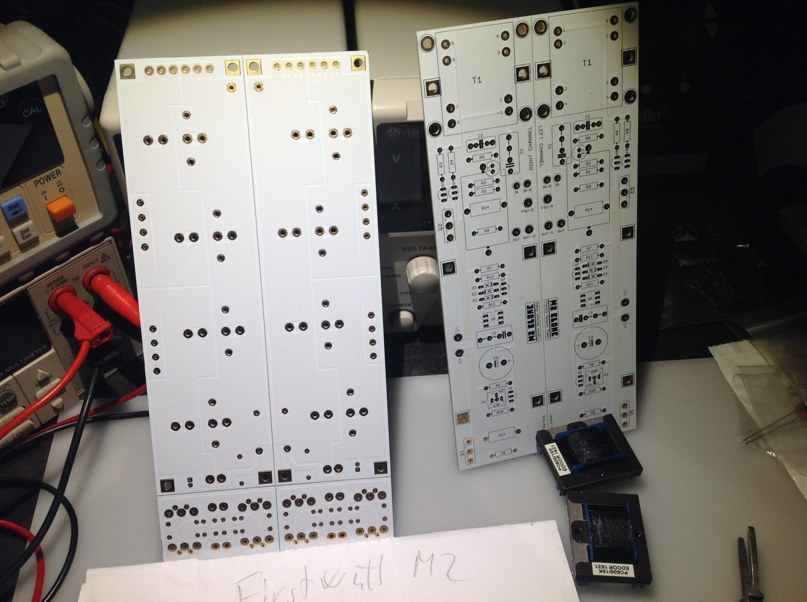

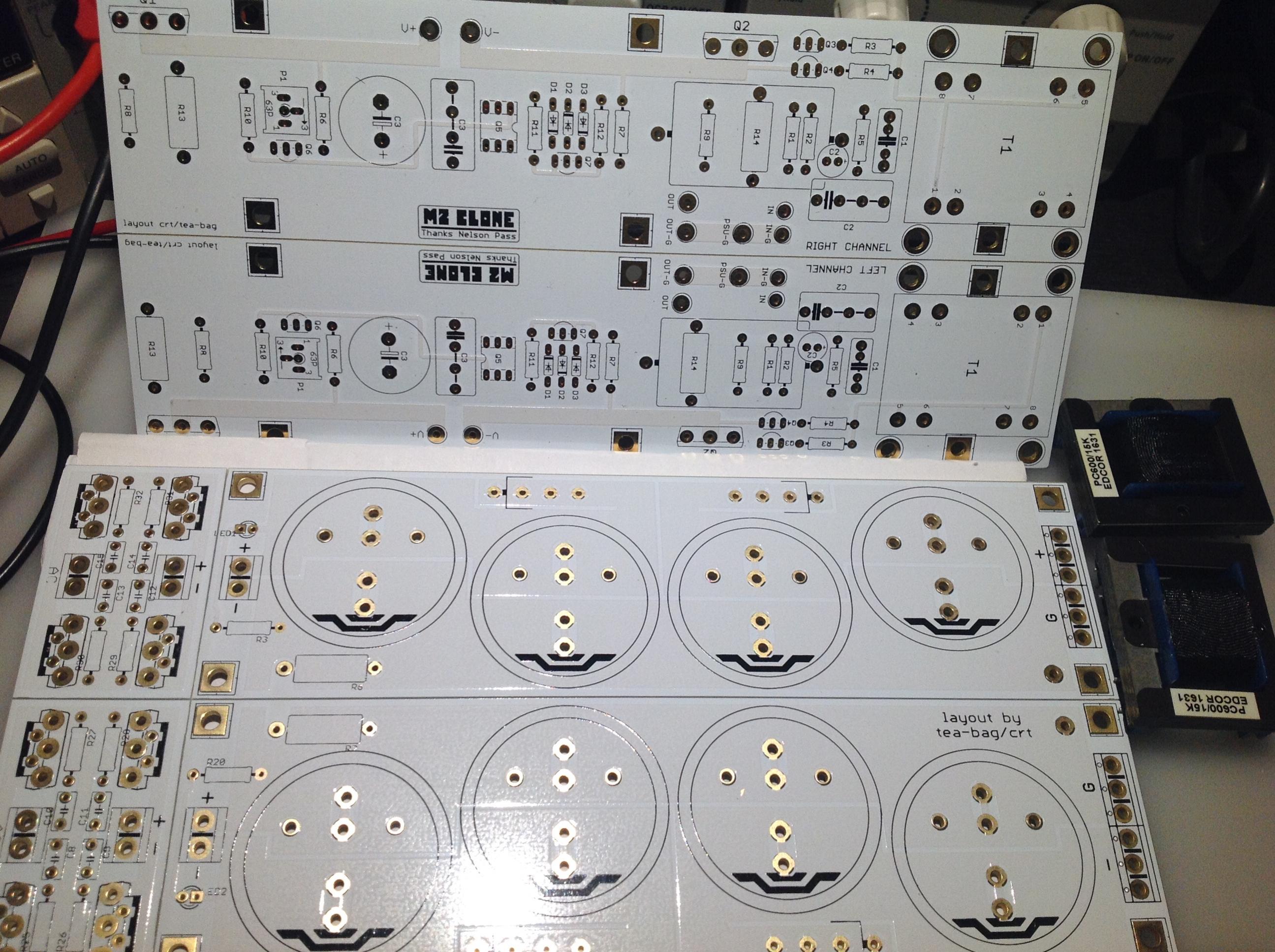

If you have any left over parts for this, I would be happy, very happy, to buy a full or even a partial set.
Jim
I have a number of full sets. I will send you a PM with the details.
Tea
Pcb received thank you tea bag

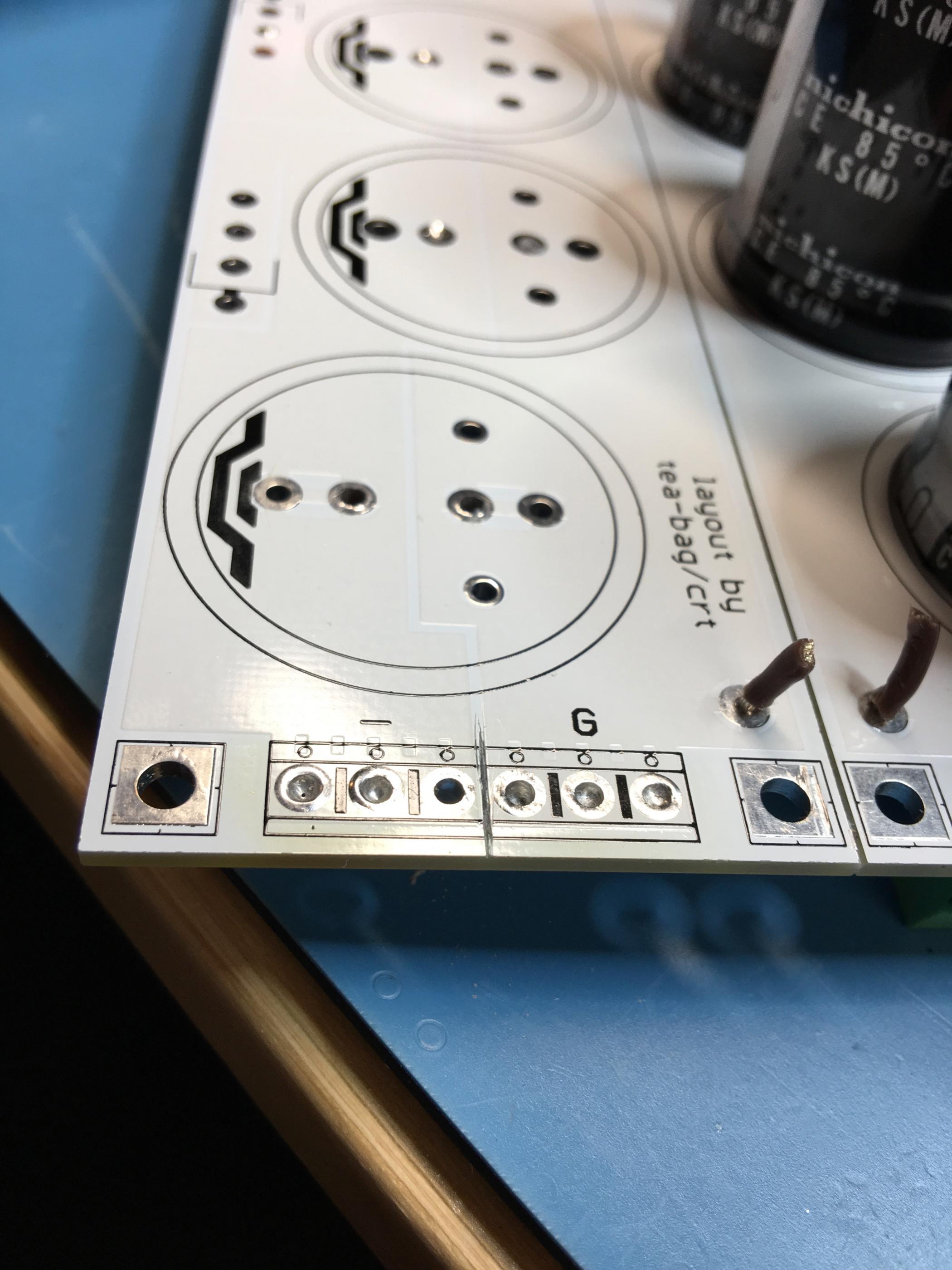

I wanted to post a problem I ran into with the PSU PCB in case others run into a similar issue. In testing the fully populated PSU board, the negative rail was shorted, luckily identified with a variac. I was able to isolate it to the last pair of paralleled capacitors on the negative rail of the PSU board. After testing and removing component by component, I identified that the top layer copper pours by the output header must have been shorted during production. The issue was non-obvious because of the silkscreen layer on top.
After scoring between the pours (see picture), the issue was resolved. Easy fix, minus the desoldering, but you may want to test the PSU boards for shorts between the +/G and -/G pins before starting assembly.

I have tested all in stock power supplies boards, and none of them short between G and - or G and + rail.
I can send you another PS board if you like.
Thanks for the offer, but no worries, I just got mine back together!
