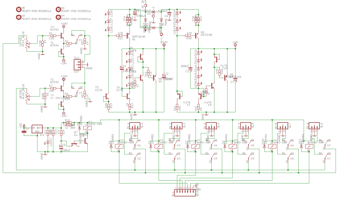

see if this helps...

Luckily for me my brother is an elec engineer so he does most of the work for me. He wants to look at the schematic to look at before i buy. A member who was in the last GB has offered me a board.

Is that relay necessary? Just a pop or something or does it damage speakers?
What are the power supply requirements? My only real criticism is that it requires 2 AC inputs, or one input with center tap. IMO it is better to take a single AC input, and then use a volt doubler PSU. That way you can use a standard AC wall wart (cheaper, easier, safer, no grounding problems or AC hum, etc). Bigger caps are needed for volt doubler PSU but that's no big deal.
Does everyone use the onboard shunt PSU? Any comments on it's subjective performance? Anyone already experiment with different PSUs or voltage regs?

Necessary, there is DC on output when closing down.
Requirement is either a double secondary 15+15V Tx with mid wires going to the centre point of the AC input pcb connector or a 15-0-15V 3 wire centre tapped. 50VA or more massive.
The onboard LED referenced shunt regs are arrived at after having tested with 317/337 also. Their contribution to the total resolution and signature result is decisive.
