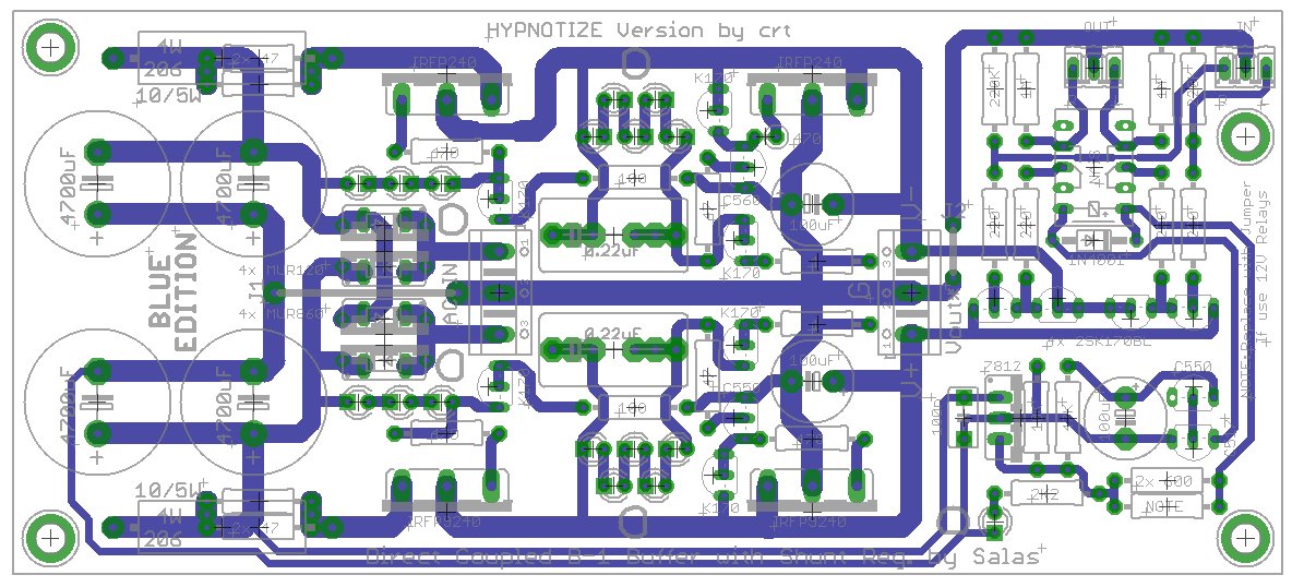

Hi guys,
How do you like this one? You prefer it? It may be a bit bigger and probably cost a bit more too, but gets heftier caps, can sink diodes, gives space to AC entry, gets up to 22.5mm pitch films to experiment with makes and uf better for decoupling the ref. Its either this or the one next to it we must decide. Vote please.
154.6mm x 68.8mm older dimension
181.8mm x 71.3mm new dimension

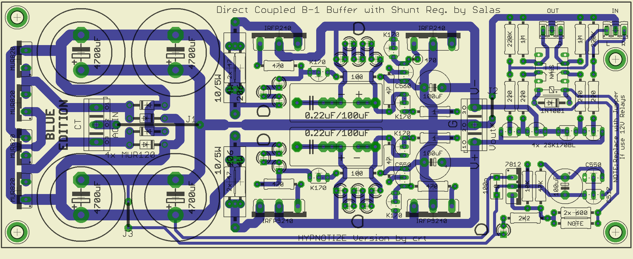

Hi guys,

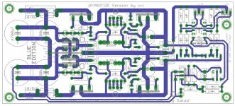

Hi guys,
The biggest one is my favorite but I am also ok with the first one!
