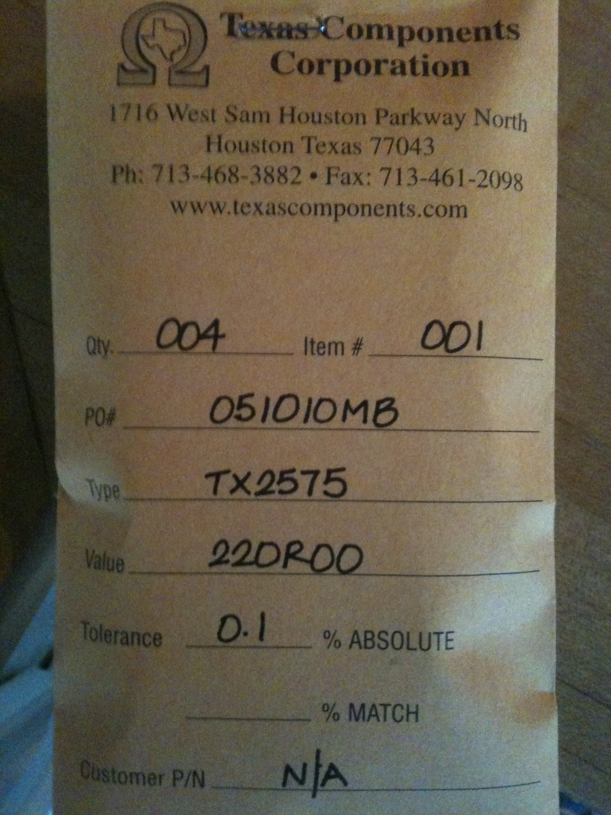

The reason is we made it shooting for very good subjective quality. A 50VA isn't that expensive, its a typically much available rating and gave it space to play with higher CCS also. This is constant draw bias and cores sweat much easier. So we chose big. I would run it from 2 300VA R-Core even with 2A per side CCS, and nude Z foil signal path resistors if it was my fixation. Tight point to point air dielectric construction with solid silver hook up wire, monoblock 1.2 remote sensed regs, LSPD pot. But I am not that fixed.:D
Nude. Cool.
