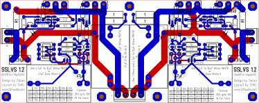

IMO it would be advisable to rethink the changes and make the design simply better than the previous versions for its specific purposes:
I am not talking to bend the variations in favor of my personal favorite Mezmerize but maybe the focus could be sharper:
- A combined (scorable) mezmerize/hypnotize optimized version 2.0 with some more possibilities as 4 caps, TO220 diodes etc. for those that want the buffer part the best possible way and for those that like the input selection with relays too. So one board with scorable part concerning the input selection/volume control.
- A separate universal shunt supply PCB for those that won't use the buffer part anyway. Wider tracks for larger currents, more space for larger resistors that come with more current etc. To me it seems that will be the primary purpose for this particular board anyway but I could be wrong on that of course.

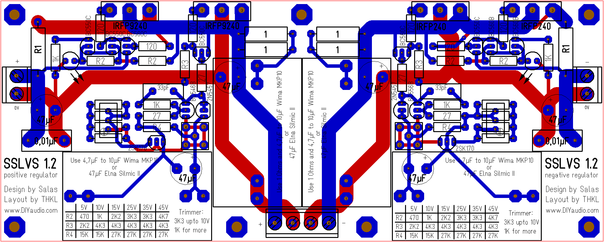

Hi, things have changed but the AC wiring crossing the TO220 diodes is not pretty. That Phoenix connector should have moved to the side long ago. Still 2 jumpers and a narrow spot for the ground tracks ( too picky, I know ).
Just a thought: when all MOSFETs are brought to one side mounting them will be more easy on a heatsink or cabinet/case. It will leave possibilities for the AC wiring too. In my eyes the layout is somewhat less optimal/tidy than before, I am sorry to say so. Or at least I don't see many advantages over the old boards except for the caps and the TO220 diodes. I won't start about the color of the board ...
Maybe the marketing department should have advised to design just a general purpose shunt supply board from xx mA to xx A without the buffer part Omitting the buffer part, putting all MOSFETs to one side and using a 6 pin Phoenix ( 2 x +, 2 x - and 2 x GND ) at the power output for feeding more than 1 circuit certainly would be nice additions. The board would then be a truly versatile shunt supply PCB.
Its all CRT could muster. It has the TO-220 diodes, the 10mm double snap in caps, takes big current Rset resistors, and caters for any type/value Vref cap. So it takes all the proven mods.
About the parts side color maybe they can do a mask strong blue also. They did not do more in the proto phase. If not, we will see options. Its 3 times heavier copper and plated holes and takes parts OK non the less.
Using it for universal supply only its a whole different thing. Would need Norton references to give a whole range with trimmers and remote sensing for addressing longer distances well.

Jean-paul, remember that this is a GB for a DC coupled preamp with excelent performace. If we wanted a PSU group buy, we would have done that, making a proper and optimized board for that purpose.
We have the versatility that it can be used too just as a PSU, but it is not the main idea.
Regarding the Mezmerize, is had less demand than Hypnotize in the last GB, so I can't see anything strange in not offering a multiple-input option. Some of us only use one source for audio, so no need to use a bigger board. And, as Salas said, there was a column in the spreadsheet for signing up for the Mez version, but people preferred the simpler approach. It's just a problem of lack of demand. Being only a bunch of customers, each board would have a very high price, leaving even less customers than before knowing the price.

BTW, this regulator board looks impressive Salas
