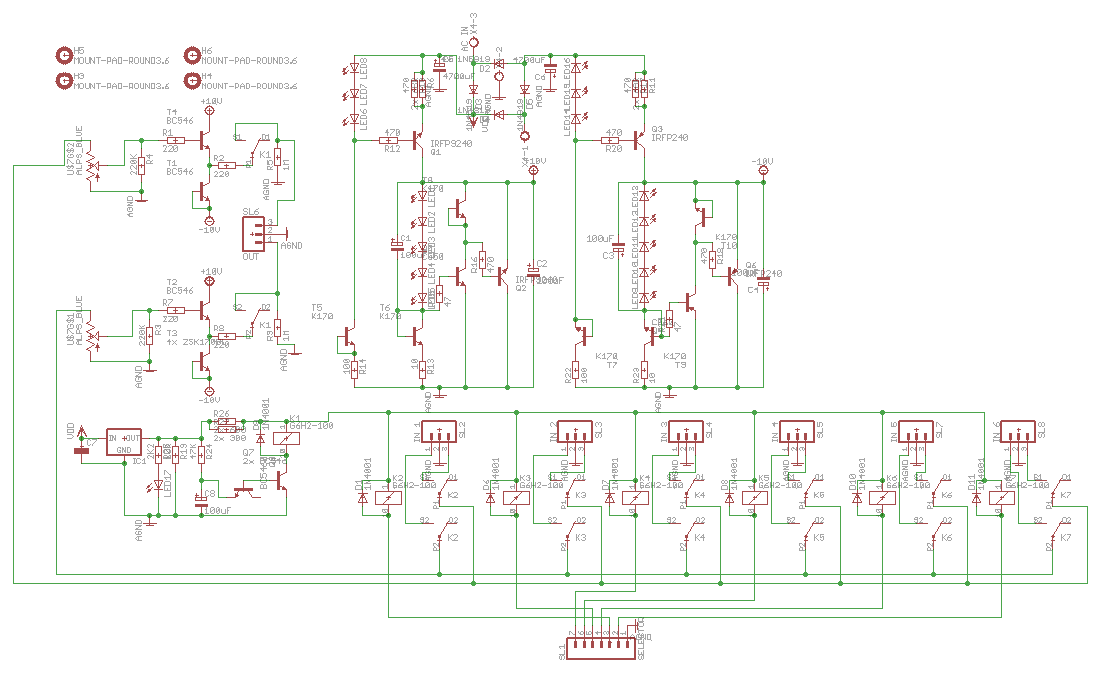

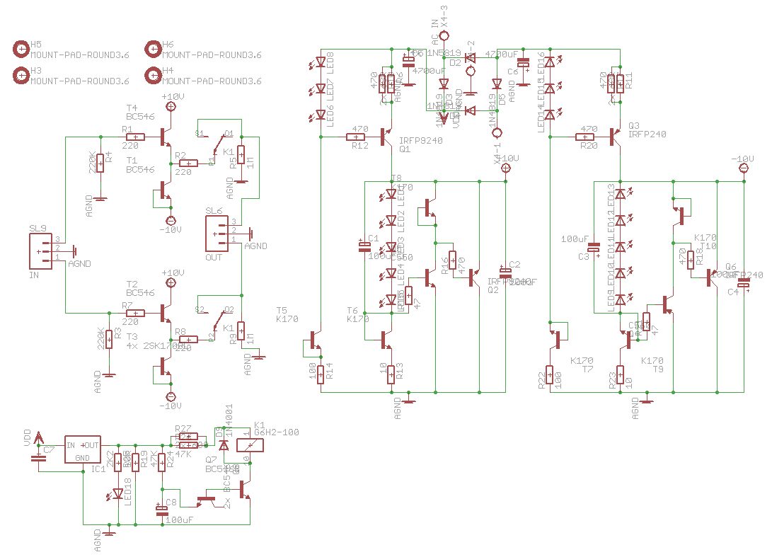

Its the same as before plus 1 relay for Hypnotize, plus 2 for Mezmerize if you utilize the full 6 inputs.There were some BOMs compiled I guess. Only you add the two parallel 0.5W resistors (600R in Hypnotize, 300R in Mezmerize) if using NAIS TQ2 5V or just a jumper if with NAIS TQ2-12V. A 2X15V 50VA TX will power the thingies OK. If anybody wants to compile fresh BOMs, look at what the PCBs carry, I attached on #512 http://www.diyaudio.com/forums/showpost.php?p=1908404&postcount=512
The circuits below are the Eagle guides, don't use them directly for BOM, they have some helper equivalent stuff, but good to see the full picture.
