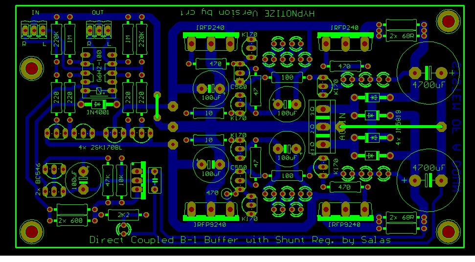

Here is an adjusted layout from PCBCore as sent from Tea-Bag.
Salas,

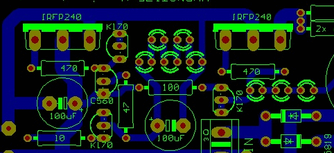

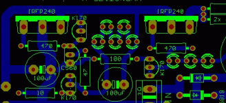

Looks like the 470 ohm resistor in the middle on the negative rail only has one leg. It appears to have been there in the other doc's as well, on both units.
Tea-Bag
There are 2 470R gate stoppers there. One over the 560, one over the 3 LEDs. I see 2 legs and 2 pads for both. Where it shows?
Opposite side, Do I have my rails messed up?
Small point but I couldn't see a label on the V+, V- and GND inputs. I know you'd figure it very easy from the polarity of the first caps, but if its no hassle, I suggest adding it in. Might save someone a lot of trouble someday!!

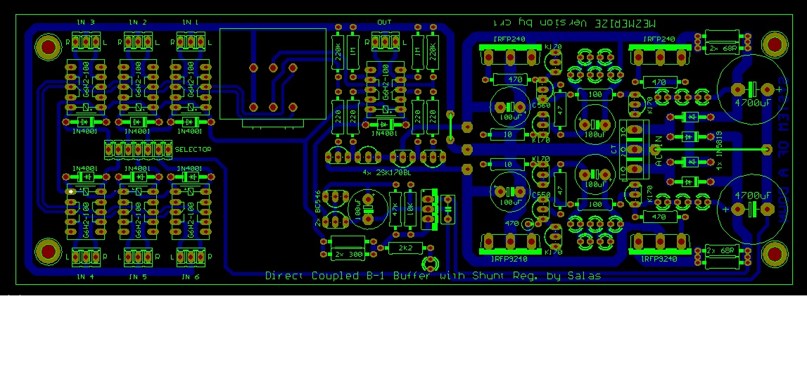

Its the same as before plus 1 relay for Hypnotize, plus 2 for Mezmerize if you utilize the full 6 inputs.There were some BOMs compiled I guess. Only you add the two parallel 0.5W resistors (600R in Hypnotize, 300R in Mezmerize) if using NAIS TQ2 5V or just a jumper if with NAIS TQ2-12V. A 2X15V 50VA TX will power the thingies OK. If anybody wants to compile fresh BOMs, look at what the PCBs carry, I attached on #512 http://www.diyaudio.com/forums/showpost.php?p=1908404&postcount=512
The circuits below are the Eagle guides, don't use them directly for BOM, they have some helper equivalent stuff, but good to see the full picture.

As promised, Bom's for Hypnotize (Basic) and Mezmerize (Deluxe).
Values are the same for both versions, except one resistor and relays qty :
a) 600R for Hypnotize and 300R for Mezmerize.
b) 1 relay for Hypnotize and 7 for Mezmerize.
As I ignore the real PCB footprint, be carefull with caps lead spacings I specify :
100uF (5mm) - 4700uF(7.5mm) - 100nF (5mm).
For the resistors I've choose 1/2W for all values, without brand information.
I'll just mention that 220R should idealy be "top quality" resistors (cf Salas).
Omron relays specs can be found here :
http://www.components.omron.com/components/web/PDFLIB.nsf/0/DB3627D7D8BCAFF485257201007DD587/$file/G6H_0609.pdf
IC1 is L7812 fixed tension regulator.
C7 is 100nF Metal Film Cap.
Please refer to the PCBs shown here for more informations :
http://www.diyaudio.com/forums/showpost.php?p=1909777&postcount=541
Let me know what should be modified or has been ommited.

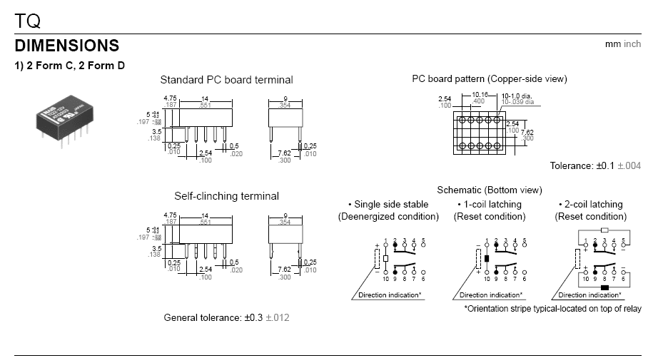

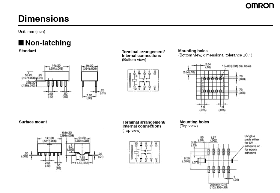

I see that the Omron G6H prototype that crt used as he had it in his device list has the exact same dimensions as the TQ2 we specified because some people already have it. Do you see any possibility for problems?
Omron is fortunately sold by Digikey: http://parts.digikey.com/1/parts/755222-relay-pc-mnt-dpdt-1a-5vdc-g6h-2-100-dc5.html
