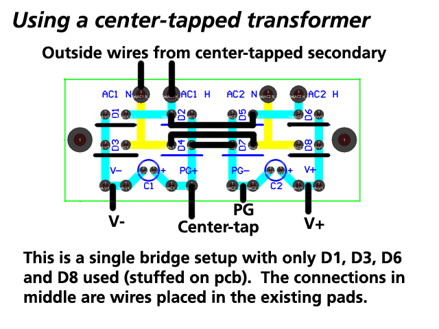

All hell is breaking loose on the power supply front:
http://www.diyaudio.com/forums/showthread.php?s=&postid=359504#post359504
How about right here - who's right Lieven or me?
I'd bet on lieven, but I need your blessing- or do both ways work?
Clearly the hardest part is hooking up the transformer!
There are 3 cases it seems to me:
- trannies with dual secondaries: that's covered in the manual
-trannies with center tap - you can resove this right now-see above.
- 2 trannies with 2 wires how to combine them to create equivalent of one or t he other of the above.Probably not as urgent... and has beeen discussed elsewhere a little.

For the center-tapped transformer, I haven't tried using dual bridges with it, but I would just stick to a single bridge. Say that transformer is 25-0-25, and you are using a single bridge, tie the 2 - 25v lines (50vac total potential) to the AC2 N and AC2 H pads on the power supply board. You will get roughly 70vdc on the outputs (V+ and PG+). You can then use V+ and PG+ outputs as +V and -V. The center-tap can then be used for the PGND connection, running a single ground wire to each pcb from this. The main issue with this is the capacitor on the power supply board, you will have to use a higher voltage cap (100v), or else wire up the 2 - 50v caps from the +V to PGND and the -V to PGND (using P2P wiring).
It might work just fine running the center-tap into both the AC1N and the AC2H pads, and using dual bridges, and running a single ground connection to each board (not both the +PGND and -PGND), but I haven't verified this. It might be worth trying, as this is the easiest solution.
Anyone else have any input?

Variac: Here is an easier idea for wiring up the single bridge and still being able to use the existing capacitors. A single ground will be run to each channel pcb, instead of the dual grounds. This should work out good for the grounding.
Brian
