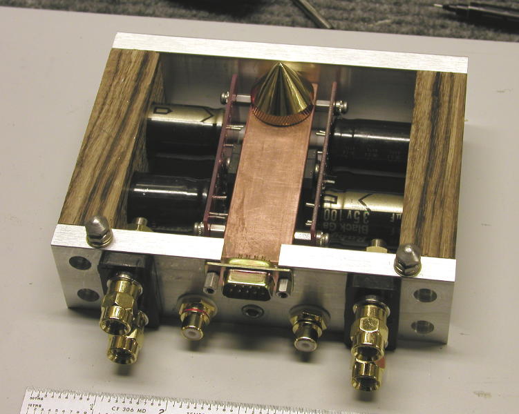

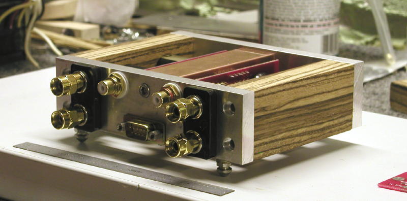

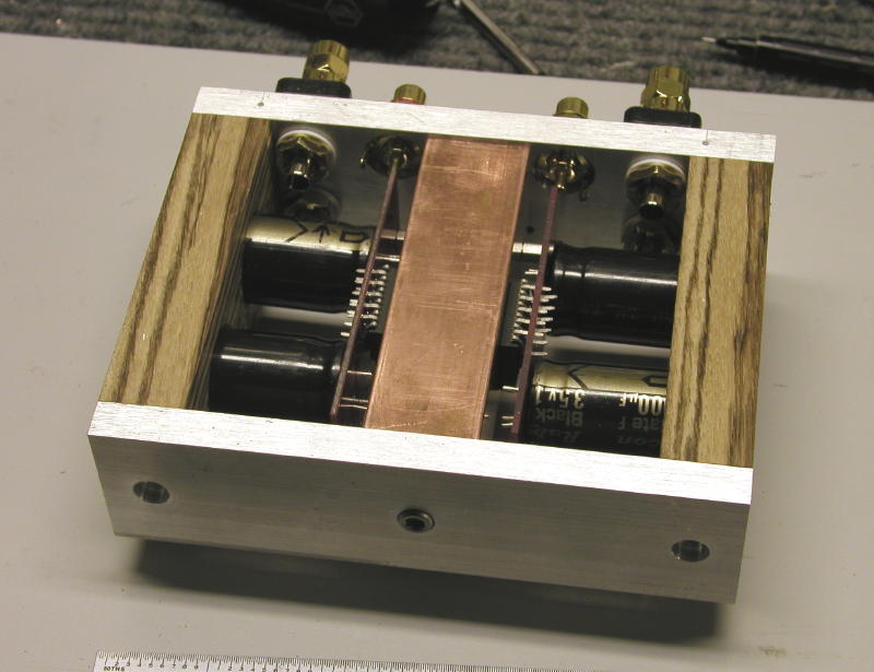

Pictures. I'm building this amp in an enclosure I found in an electronics surplus store. It housed some kind of test/measurements gear, I have no idea what it was. The size looked right, and this way I got a power switch, IEC connector and fuse holder for free, all of them already wired up.
This is what the front looks like, I'm leaving this unchanged. I'll probably use 2 of the LEDs to indicate power for each rail.
The new back panel, with RCA connectors and binding posts added. You can see all the holes from the DB25 and other connectors I had to remove. This'll impact shielding, but I haven't had much of an RFI problem in my setup except with my phono stage, so I'm hoping it won't make a difference. On the plus side, this means free ventilation
The enclosure with the transformer. The PCBs will be a tight squeeze in there, and I might get some hum pickup. We'll see. If it doesn't work out, I'll buy an enclosure from Hammond or Par Metal or something.
And pictures of what the completed amp will look like. Once I'm done, I'll try and find wood strips to put in those side channels. They originally had plastic inserts, but one of those was gone.

That's a mighty small amp! damn you peter you'll probably never stop to amaze us. (but skipping a party ? )
How are you going to fasten the lm's to the heatsink? seams like hell of a job...

Your case looks pretty nice too, very clean and elegant.
OK, now you're just being nice. I've seen the kind of work you do, and I know what your standards of 'clean and elegant' are Thanks for the compliment.
I don't think you'll be getting hum. Those chips are pretty resistant to transformer interferences (but not to improper grounding).
Thanks for the tip. I moved the transformer over to one of the front corners, so I'll have more space in the opposite rear corner to mount the PCBs. With the transformer in the middle, I was just short on both sides. Keeping all the audio components on one side means longer wiring, but it also means I can route the power supply wiring on the other side of the chassis.
