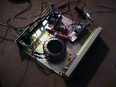

The transformer primaries hooked up to the switch/fuse/IEC connector:
The rectifier board connected:
The audio boards mounted on the side panel. Space was tight
Closeup of one audio board:
And finally, everything stuffed inside the enclosure. The wiring's a mess, but the hum/noise is pretty low (inaudible 3' from my 96dB speakers). I tried to keep the power supply wires to one side (left and bottom in the photo) and the audio wires on the other side (top and right).
Alright, that completes my amp and the pictures. Where are the others?

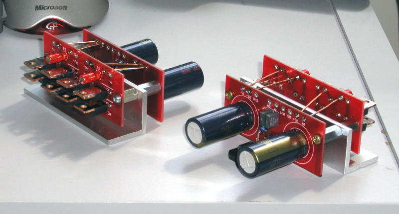

Peter Daniel said:Here's another way to create self contained modules, taking care of attaching the board and power connection. All you need is to attach transformer and inputs/outputs.
What? Are those Panasonic caps I see on Peter's boards? That is a pretty clever idea, though. Can you come up with something similar using two boards for a modular multi-channel/bridged amp?
