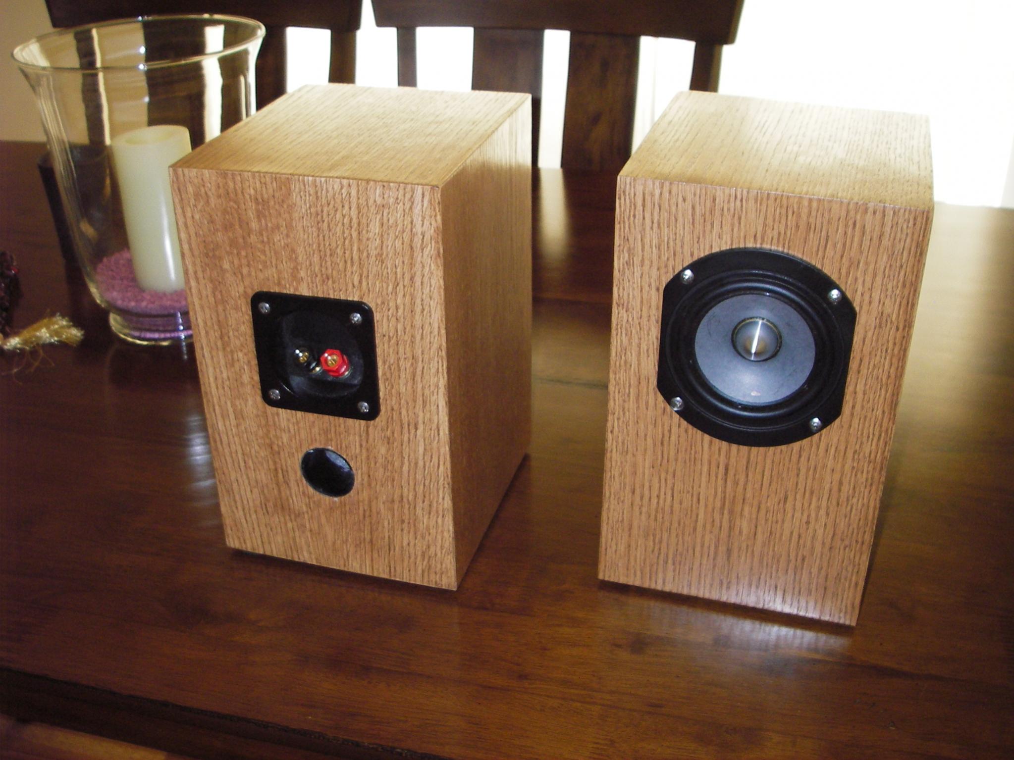

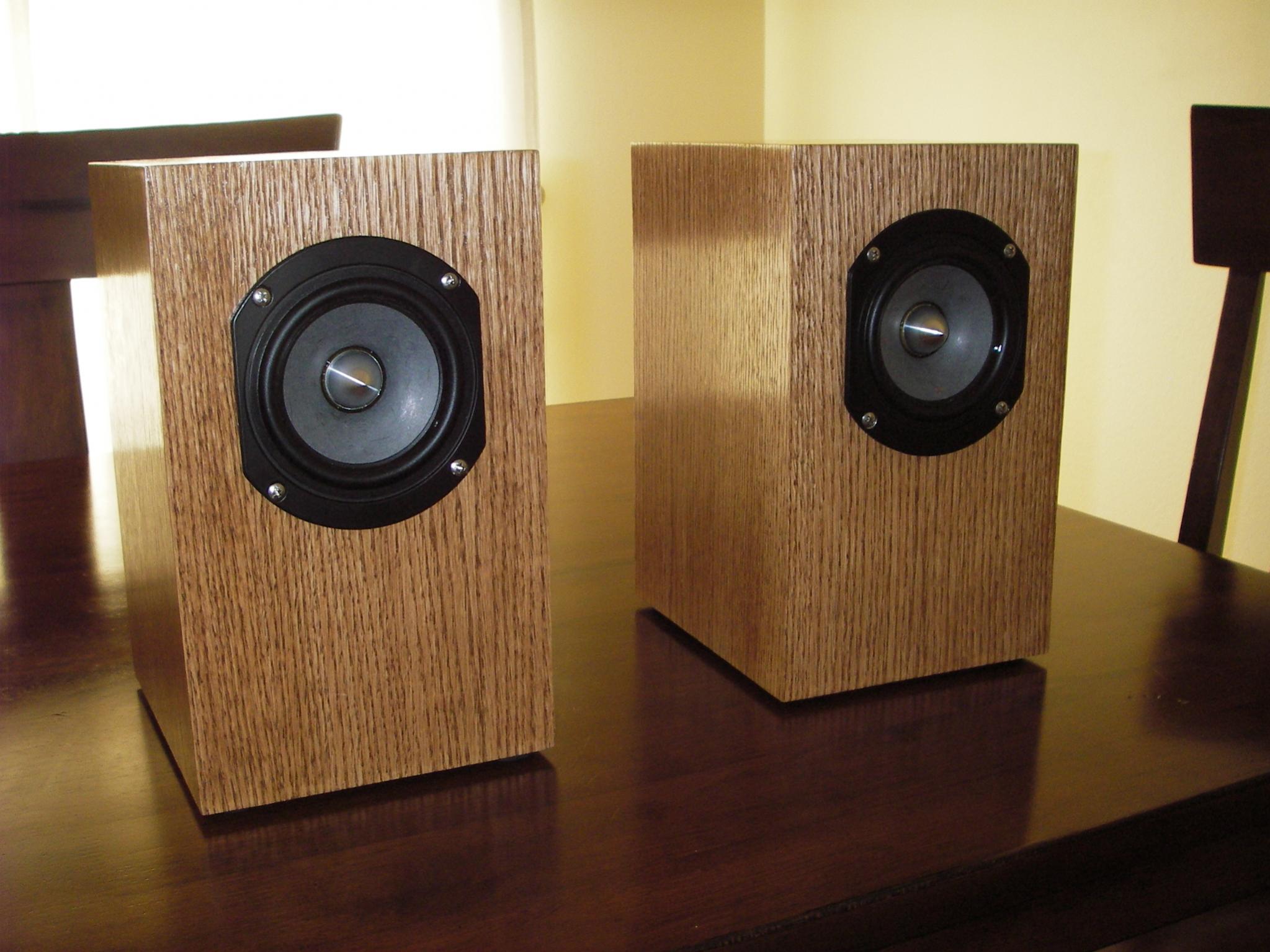

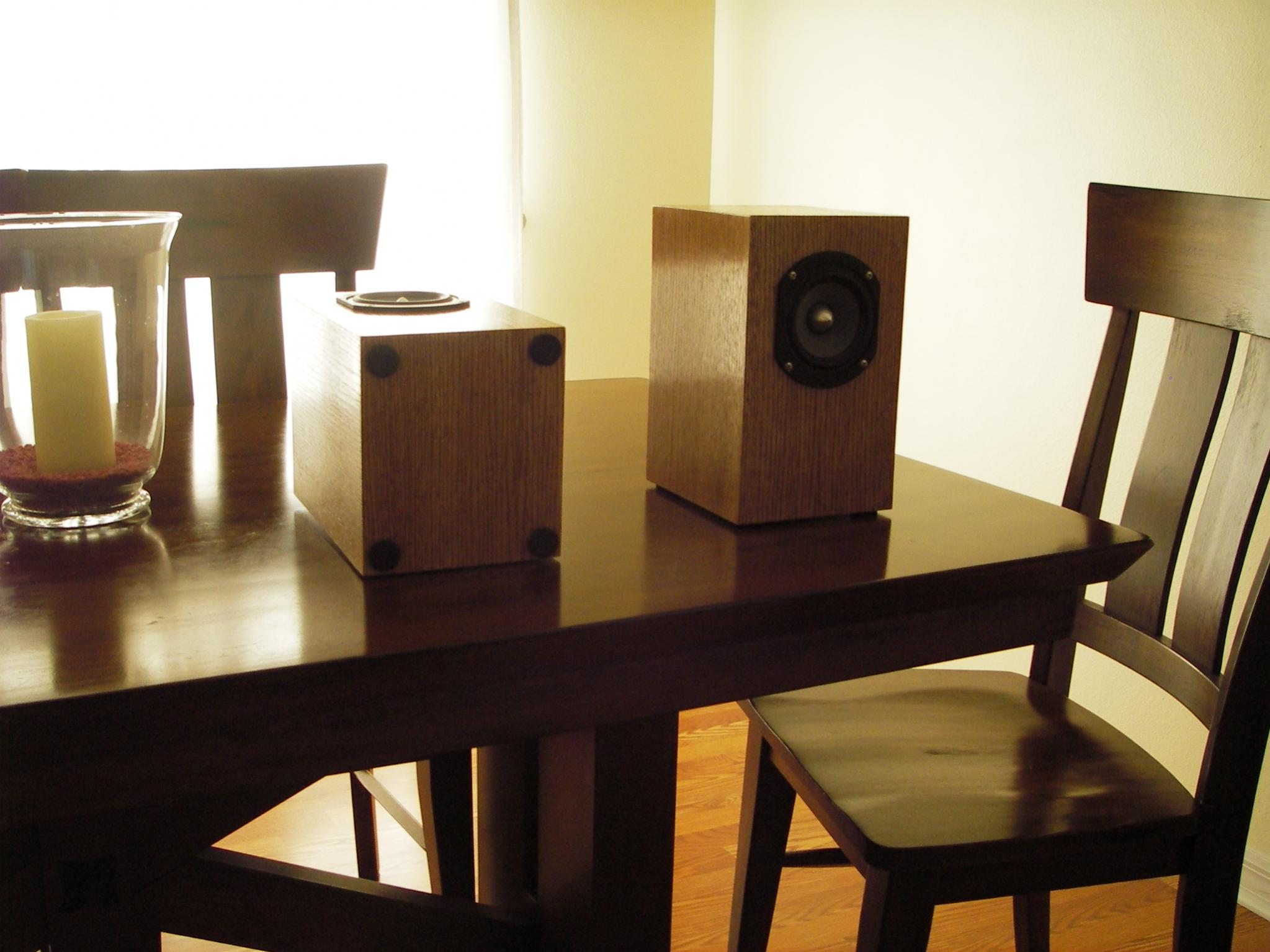

Here are is my first build. They are TB W4-1320's. I'm very pleased with their overall performance. A bit bright but I'm sure that has a lot to do the room as well. I may put together a 2-3db bsc and see how that helps. They are cherry stained oak veneer over mdf with 6 coats of semi gloss/satin tung oil and stainless hardware.

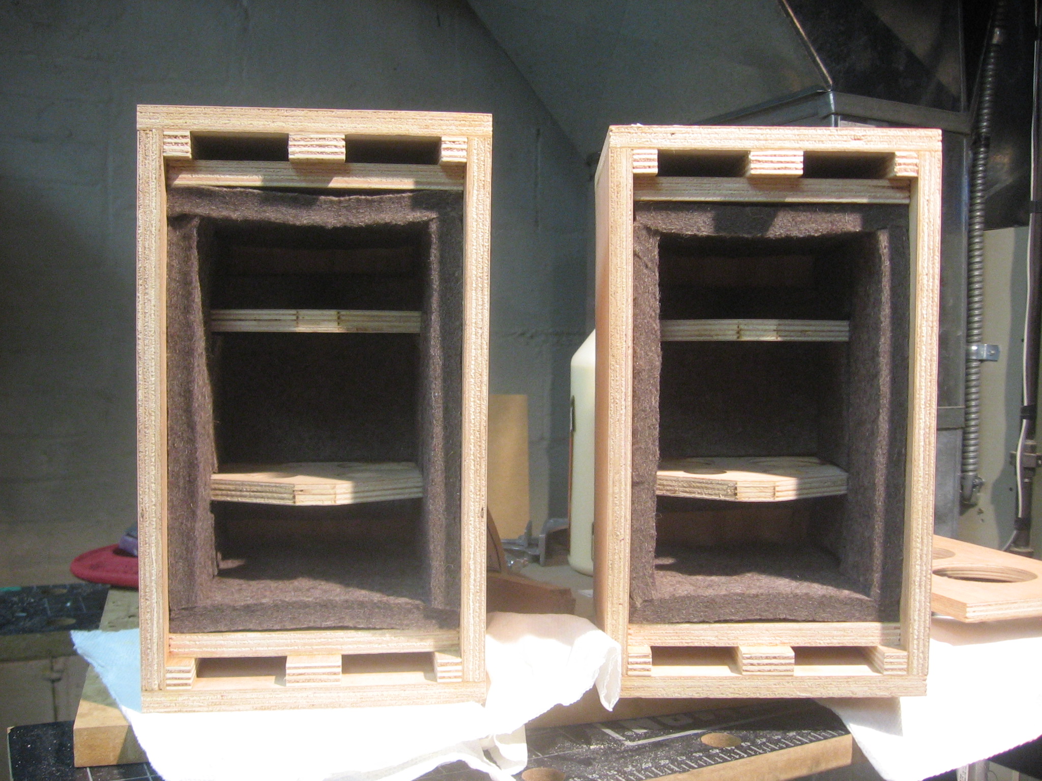

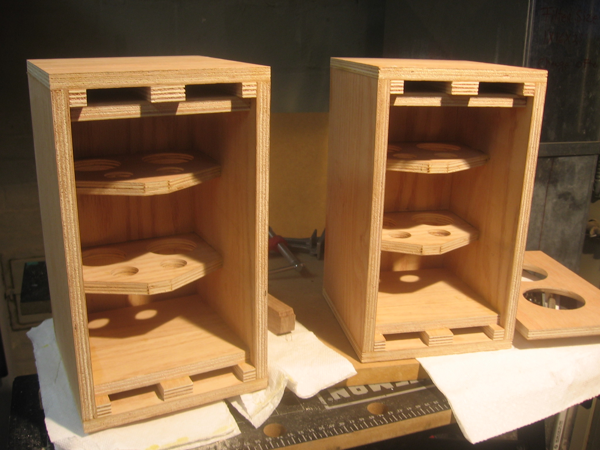

how does this 1/2" wool job look? i left some gaps for the top and bottom ports. i'm asking for your blessings before i glue the wool down :).
also, the ports are 11.5mm in height. i'll get them down to 10.5mm or so after a few liberal coats of tung-oil on the insides. i was planning on cutting some 1/32" Alu to slide into the ports along their entire lengths to tune the bass . what about stuffing the ports?
