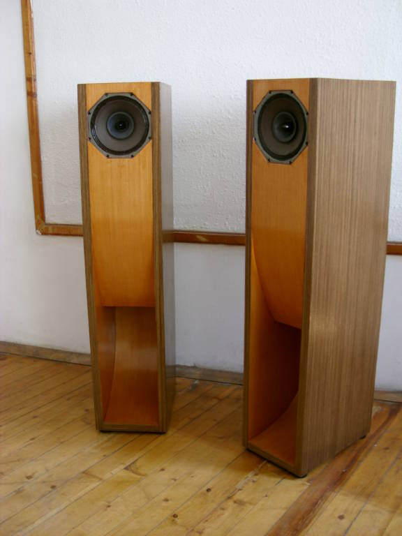

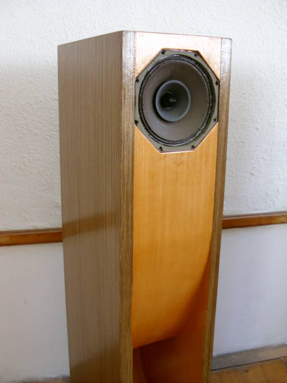

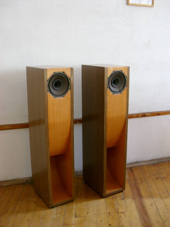

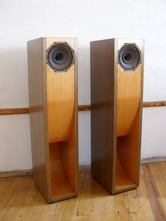

BVR / vintage Philips AD7061/M4 ( phase plug + magnet ring compensation )

Those are lovely... i just pulled a set of those drivers, i'd be interested in more detail.
dave
Hi Dave,
I think project like Iris 1v1 is better for Philips AD7061/M4... but small room + high cabinets + Wife Factor = isn’t a good idea :rolleyes: . My BVR with one mouth horn is compromise.
Different vintage Philips AD7061/M4 have different T/S parameters , Fs from 68Hz to 87Hz, Qts from 0,65 to 0,9. My drivers used to have Fs=74Hz/Qts=0,68 . After the modification (new spider) Fs came down to 68Hz , with magnet ring Qts came down to 0,48. With these parameters I calculated horn lenght=90cm, horn throat=60cm² , horn mouth=700cm², CC=9L.
I`m not sure if philips drivers will sound good without modification in my project.

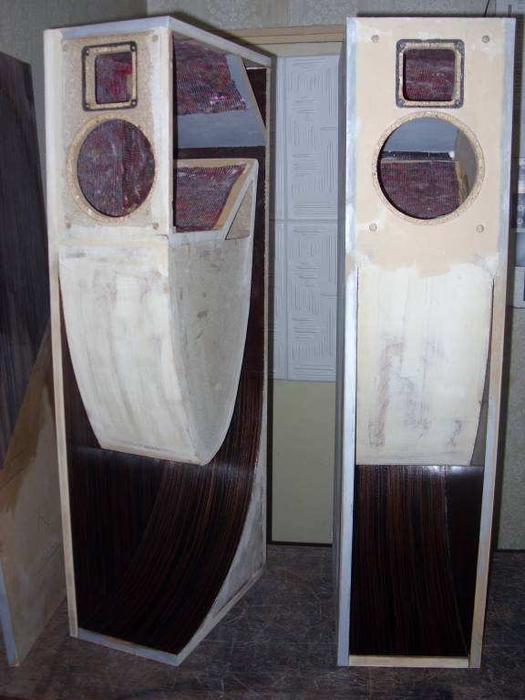

Philips with magnet ring and my prevous 2 way BVR project (first steps :) )in process of development
