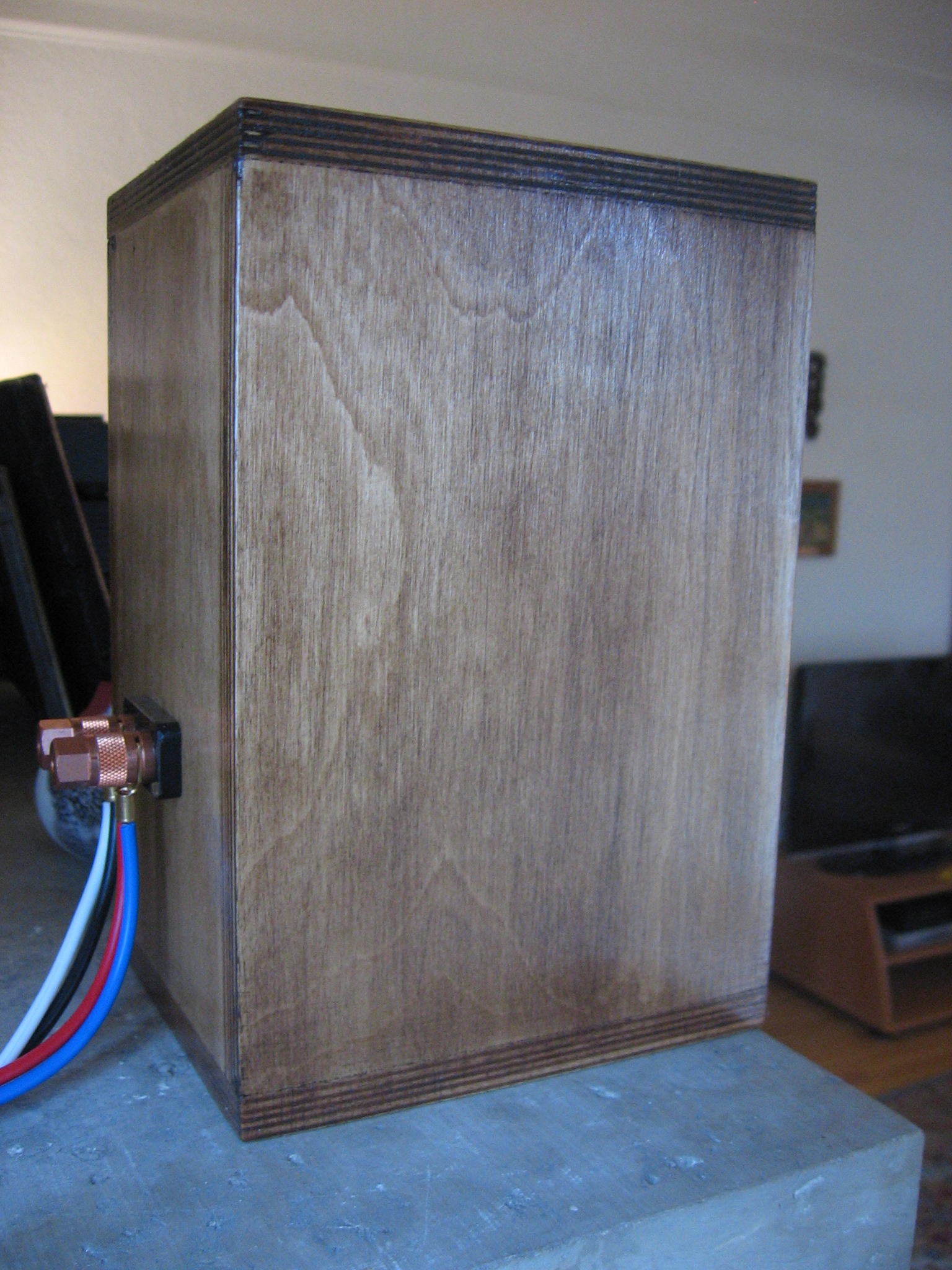

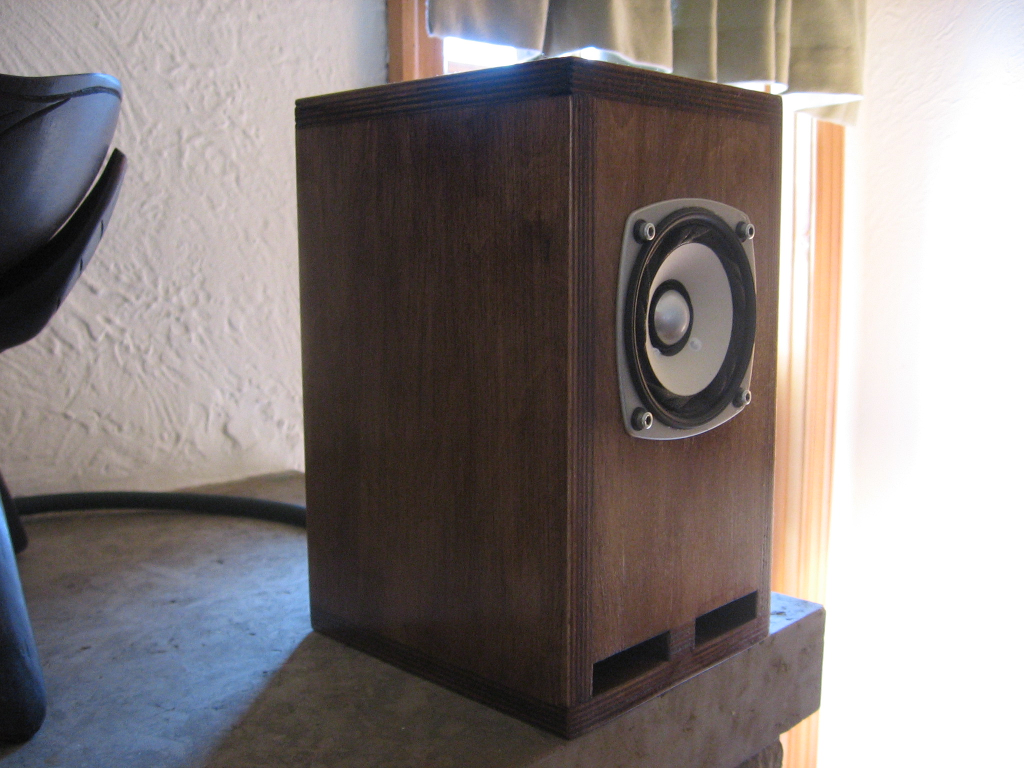

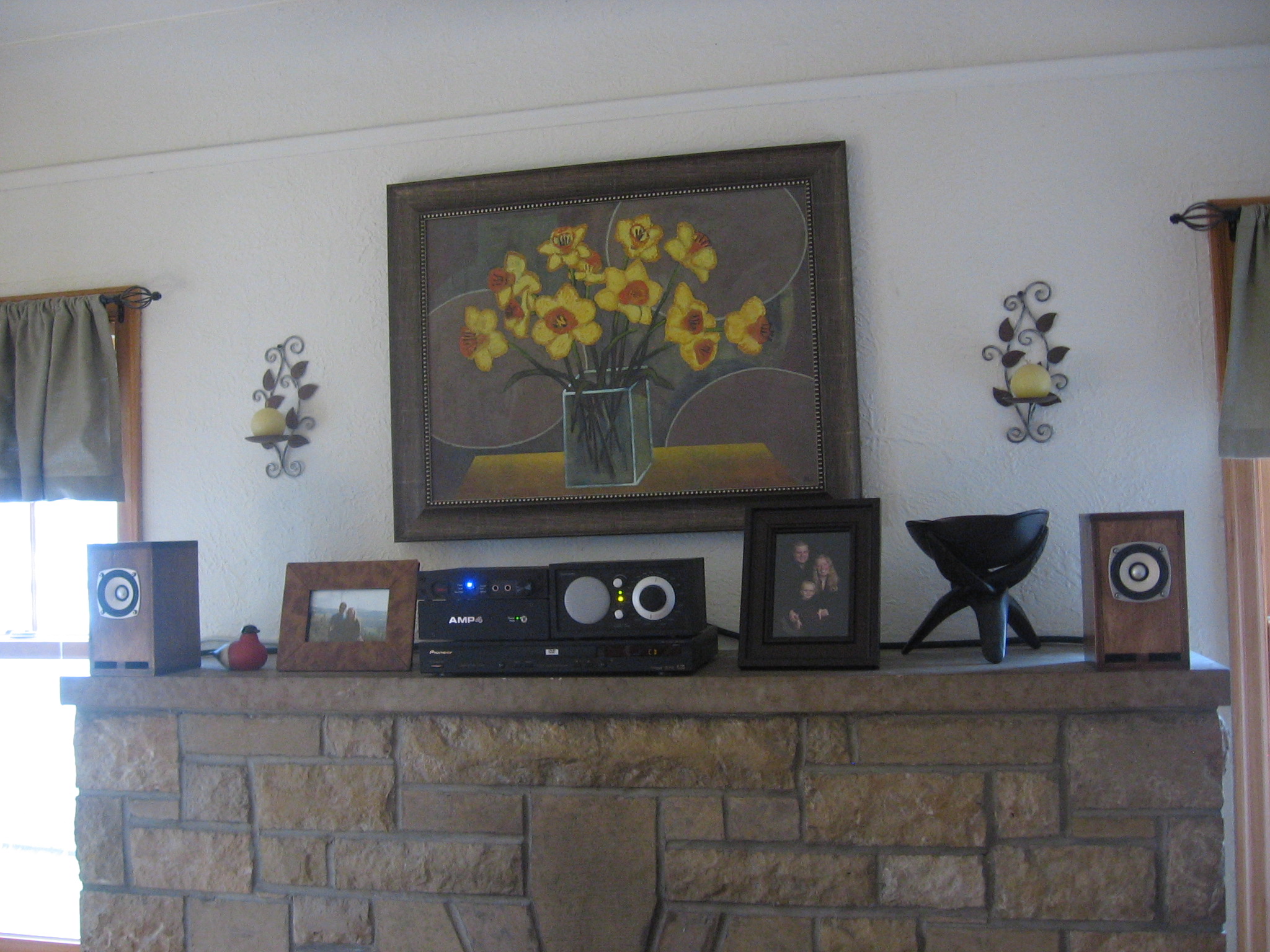

a pair of uFonkens for the fireplace-fi. because my finishing skills are limited, i went with a rough, aged patina look . BB sanded with 80grit, wood conditioner, dark walnut gel-stain, and tung-oil. i'm hoping the tung-oil will yellow a bit more. otherwise, they sound great driven with the Amp4/BM DAC1.
a big thanks to Dave . i can't wait to get started on my next FF85K project for rockin' out in the man-cave.
