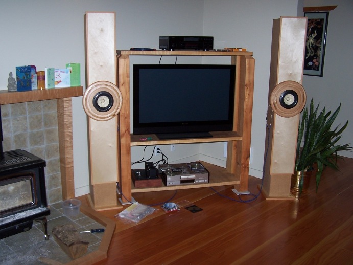

digitalmind said:Very nice builds in here! Much stuff to like.
I'm currently playing with a pair of Jordan VTL's. I like them a lot so far. May have to build a pair of J-Low's though somewhere early next year, if only for their sheer madness.
Wow. I like that tiger maple!
Thanks! I wasn't too sure about the veneer in the beginning, thinking it was a bit too wild. However, I've grown to like it. I'm planning on making different feet for the speakers though, much in the style of the Konus Essence. That should give the speakers a bit more 'classy' look.
Speaking of feet, that small footprint of the base doesn`t look like it helps make the speaker very stable, especially on a carpet. I`d be looking at a thick steel plate and spikes.
I`ve learned that applying boiled linseed oil to maple or oak is a mistake. The finish turns too brown-yellow in a short time for my liking. The look of yours is what I like. I guess that is achieved and maintained by using a clear finish like laquer. Urethanes will yellow but not nearly so as the linseed oil. Linseed oil works very well on dark wood like black walnut.

Holy crap! On the first page of this thread are my speakers. Haha, talk about a coincidence!
By the way -- forgive my ignorance, but is there an edit function so I don't have to double post? I can't find it if there is one.
They aren't all that stable -- it'd be fairly easy to tip them over should you bump into them. They would be a disaster on carpet. I haven't thought about steel as a base yet, but now that you mention it, it is a good idea. It would definitely give them a whole lot more mass against vibrations too.
Thanks for your words on oil and lacquers. They are indeed finished with a clear lacquer. I might decide to relacquer them in the future, and since I have no experience whatsoever on finishing any advice is welcome. I'll have my dad (an experienced guitar builder) to help out though.

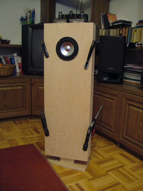

I made new enclosures for my speakers (Supravox 215SB). They're 125L and leaky.

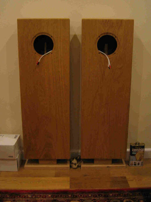

Jordan Transmission Line Speaker
Here is a finished speaker. I sanded the oak and then finished it with three coats of Danish Oil followed by one application of wax polish. The speakers sound excellent. They sit on an oak floor so I have put woll felt under each speaker.

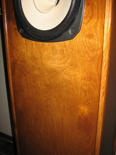

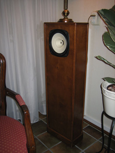

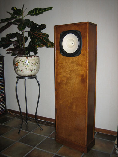

One of my designs
Time to upload one of my own designs as well.
Using a Fostex FE207E
The speaker was designed on specification of the owners to be in harmony with the other furniture in the living room. The speakers blend in perfectly and sound awesome too.
first image:
