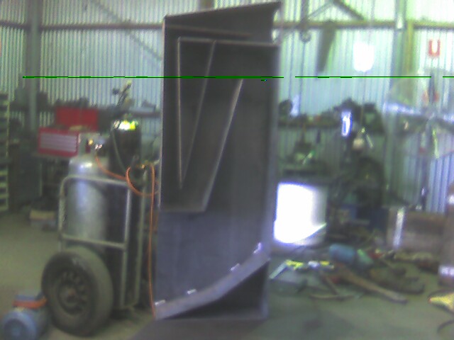

scottwilko said:here are my steel buschorns more pics coming soon
It will be very interesting to see how the steel works out. What drovers are you planning on using?
dave

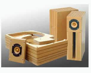

Multilayer fullrange lsp
I'm very interested in fullrange lsp and browsed the internet for information.
This is what I found Tangband company has a small fullrange lsp a backloaded horn design which is build of sheets machined in a cnc router has anybody the formula for this kind of loudspeakers.
Re: Multilayer fullrange lsp
Calling those horns is a big stretch...
dave
kamskoma said:Tangband company has a small fullrange lsp a backloaded horn design
dave
