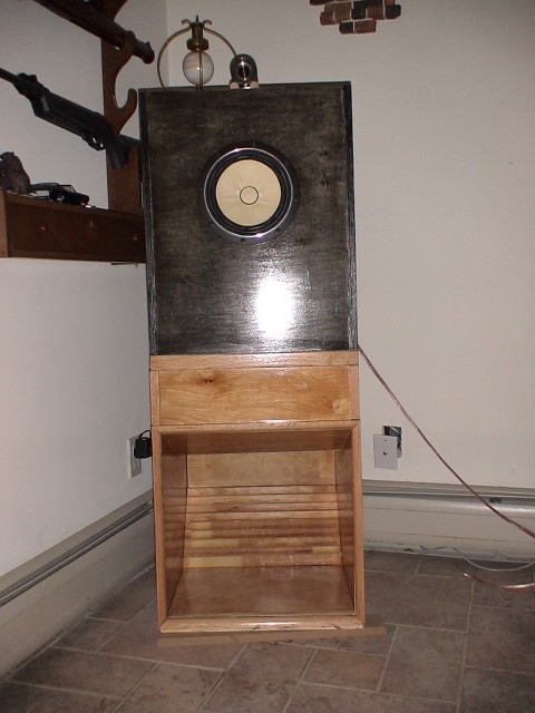

Just finished and now have as my main speakers. Modular design with an upper split-horn and main horn where where the two horn paths converge. Simmed well with Hornresp and MJK model worksheets. I have thread going related to this horn build. I am very happy with the sound especially when driven by a tube based amp. Uses just under two 4x8 sheets of plywood for each BLH. Driver used is FE208 Sigma but also sounded very good with FE207E. Here is the thread:
http://www.diyaudio.com/forums/showthread.php?s=&threadid=107278
It would not have been possible for me to build this without the sharing of knowledge by more experienced guys on this forum. Most particularly GM and Scott.

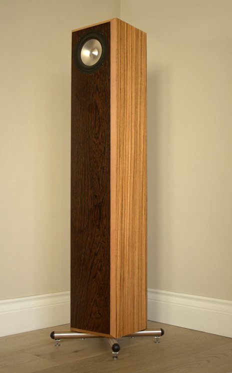

This is the latest addition to the family.
It's based on Sheldon's Tidy TL design and is a direct result of gaining a daughter who likes to shake things a lot.
My Highball designs had to be temporarily retired as there was too much risk of my daughter doing an Indiana Jones and shaking the stand so the speaker rolled off onto her !
I'd be interested to hear anyone else's experiences if they've used this design. Currently it has no BSC implemented or stuffing which i hope to add later.
