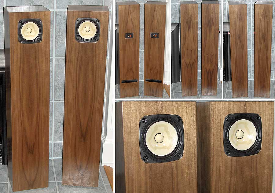

Dave, I see you have flush mounted the driver. Do you find that flushing mounting helps the high end?
This page http://zaphaudio.com/mtg-surface.html has had me wondering about flush mounting full range drivers for quite some time.
Re: The latest of the Fonken Family
They turned out quite nice Dave, how do they compare to the standard Fonkens?
Jeff
planet10 said:The GR Fonken (Fonken tuning in a classic golden ratio rectangular box)
We did this because the Fonken is a fiddly box to build. Plans in the Box Plan Library
Jeff
gmilitano said:I see you have flush mounted the driver. Do you find that flushing mounting helps the high end?
It is part of our assualt on getting the last little bit out of the speaker. With the program in the CNC machine, we just do it by default now,
dave
Re: Re: The latest of the Fonken Family
No direct comparison yet... Chris took a pair of fresh drivers for the ribbon mahogany Fonkens so that we can compare.
I expect a standard set to have an edge, but there are some (theoretical) advantages to the GR box (lower BS frequency for one, more bass maybe (but not necessarily better)).
dave
vinylkid58 said:They turned out quite nice Dave, how do they compare to the standard Fonkens?
dave

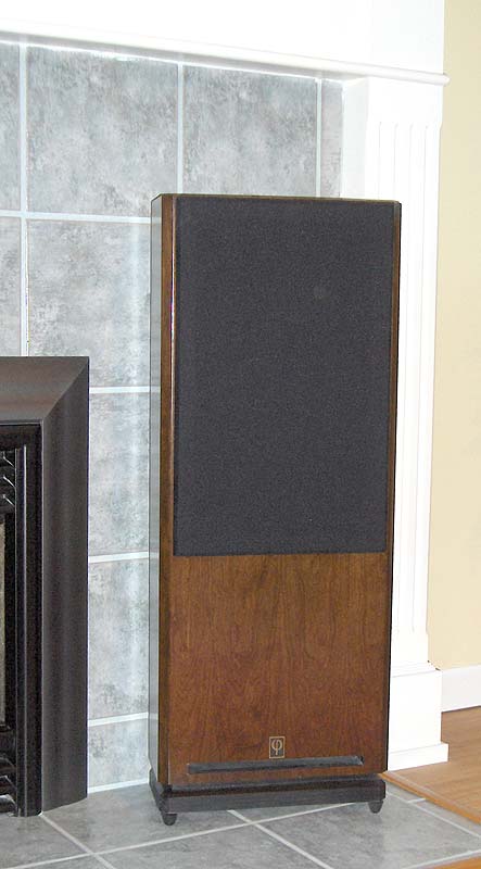

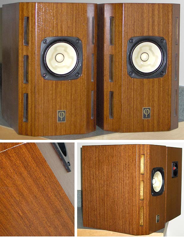

(Chris mailed me some pics)
Part of the rationale for the existance of the GR Fonken is that it is part of a family of "Flat-Face" Fonkens. A series of boxes that use the same tuning as the Fonken in different aspects (13 litres tuned to 50-something with a high aspect ratio port).
Here is the freshly finished Mark II floorstander. Everything below the port on the back is meant to be sand-filled for stability. The Mark 1 doesn't have this, so is even skinnier,

planet10 said:And Chris also sent a lone picture of Mileva (also with FE127e). This box has gained the highesy yet approval factor from Chris' spouse.
I like the Mileva shape as well, although my wife doesn't.
The Mark II floorstanders are finished beautifully, that veneer is really quite lovely. I've given up on the idea of putting veneer on mine, now that the weather is warming up, I think a few coats of spar varnish and some wax will be it for them.
Jeff

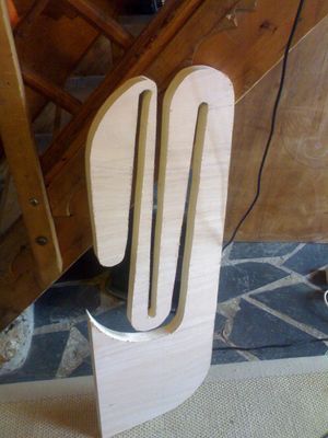

FE168-E sigma project
hi to all,
i'm starting a project based on the foxtex fe168-e sigma drivers, here some pictures of this project: http://scalblog.blogspot.com/
And somes pictures attached:
hi to all,
Update
Updated the blog yesterday, starting to be exiting
(sorry all coments are in french)

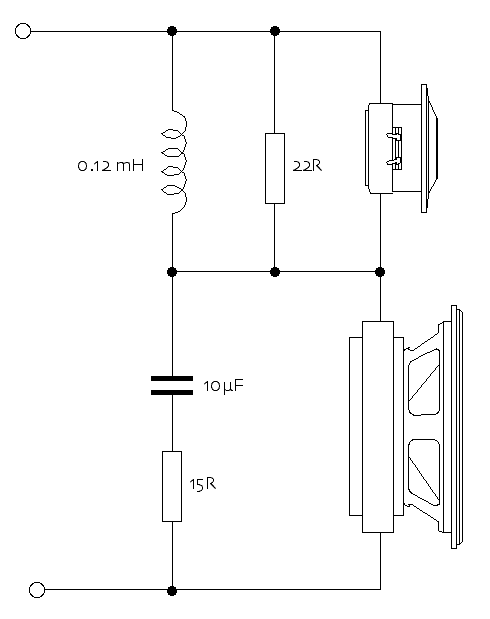

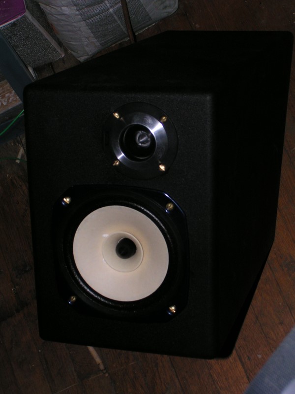

Tweeker said:Sealed box with Fostex FE166ES-R and FT17H tweeter.
Crossover?
dave
Its a shot at baffle step compensation, the woofer is being run pretty much full range. A straight cap in parallel gives the normal 6dB/oct roll off. All this assumes current source amplifier. Normally tweeters are crossed to with cap, doesnt work out same here. All XO components go in parallel with current source amp.
