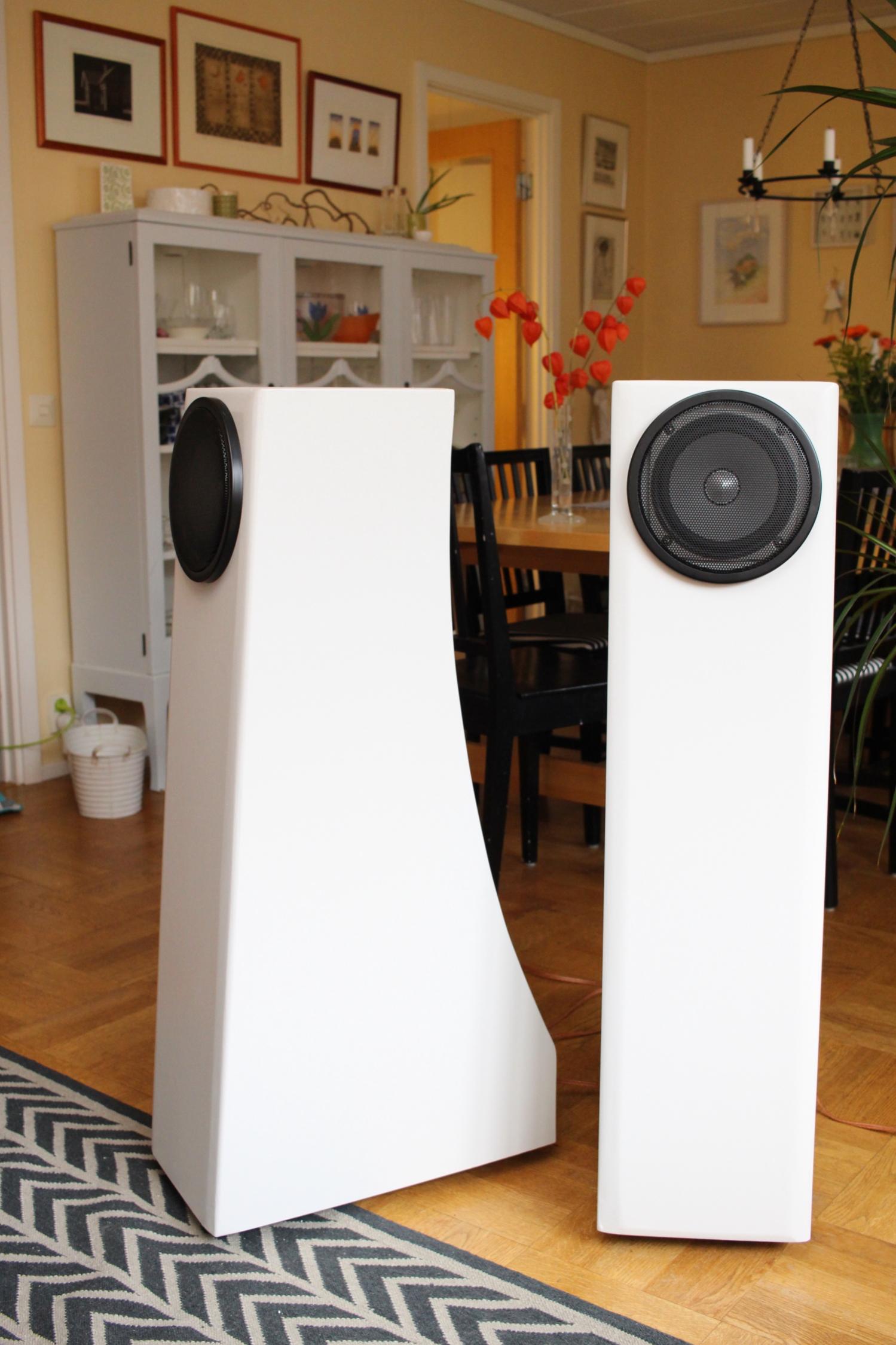

I have just completed my FHXL with the Alpair 10p and I am very pleased with the acoustic result (the woodworking result was ok too). The level of detail in instruments and vocals is just great and the overall tone balance is very good too. Perhaps I need to play a bit with the stuffing to get some more bass since I have no solid back wall behind the speakers. I am feeding them with a PP 300B amplifier with no feedback so the output impedence is probably quite high.

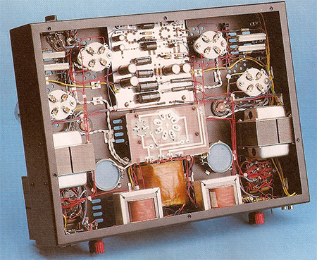

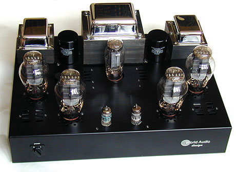

My PP300B is a kit called WAD 300B made by World Audio Design in the UK in the early 90's. I use it with a passive volume control and feed it directly from a DAC or my RIAA pre-amp.
It will give approx 2x20W which is ample for these speakers. There is a switch to choose between feedback and no feedback (6dB difference) and the data sheet says that the output impedence is 2 ohms in feedback mode and 6 ohms in openloop mode. Seems a bit higher than I thought but I have not measured it.
Here is a badly formatted website that shows an earlier version with different drivers tubes:
https://www.hi-fiworld.co.uk/index.php/world-audio-design/332-300b-amplifier.html
The transformers shown on the underside are interstage transformers for the 180 degree phaseshift to feed the 300B tubes. There are also two chokes. It is pretty heavy!
