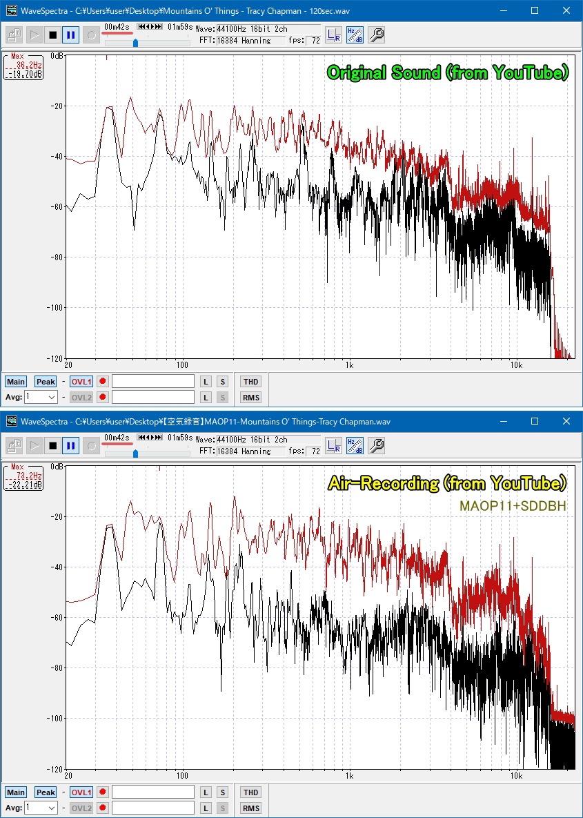

Looks like it Nandappe, but I'm using FH3s with CHP90M. I am suspecting like others have mentioned the FH3 has reached it's cutoff point at >= 40Hz. So likely in the domain of larger speakers like the Bib/IBIB, CHP90 Pensil, your TQWT DDVP-15 and the FHXL.Dear hmj,
If you compare the original sound spectra with the playback spectra, you can see the frequencies where the sound pressure is lacking.
In the original sound, 36Hz appears around 42 seconds, and I think FH-XL is reproducing it well enough.

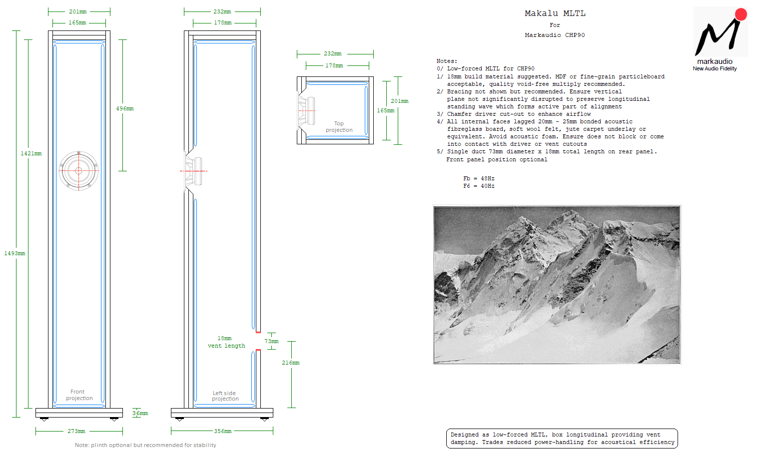

Since you mention CHP90, of the current boxes I've done for it & are up on the MA site, Bluebuck gets lowest, followed by the DCR, Pensil CHP90 and Psamathe RTL. They all have different alignments though (I aim to please ) so subjective impressions will vary between the boxes (no comment ). As a sneak preview of a few boxes I've been doing (probably not much use for you given their size & the room dimensions, but a bit of fun. Technically I could take this lower, but the object for these is a low-forced / closer to 'pure' MLTL):
Thank you Scott. Given the wife kicking off with the last tall speaker I built (Your CHN110 FestivaL) I'd best walk away from that one But I like that Bluebuck design and the Pensil!. Can you share the Fb, F3 and F6 figures please. don't seem to be on there?

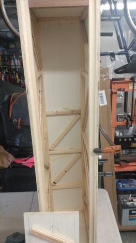

Dave suggested side-to-side and front-to-back bracing. I was wondering if the volume of "blocks" and bracing needed to be considered in sizing the box... if one adds bracing or thickens the front panel -- I've been considering both -- does the box size need to change to keep the internal volume as designed?

Yes the volume of any solids in the box to brace or diffuse has to be accounted for.

Very crude and not that effective bracing.
dave
