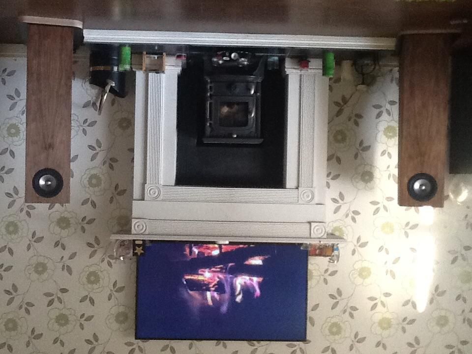

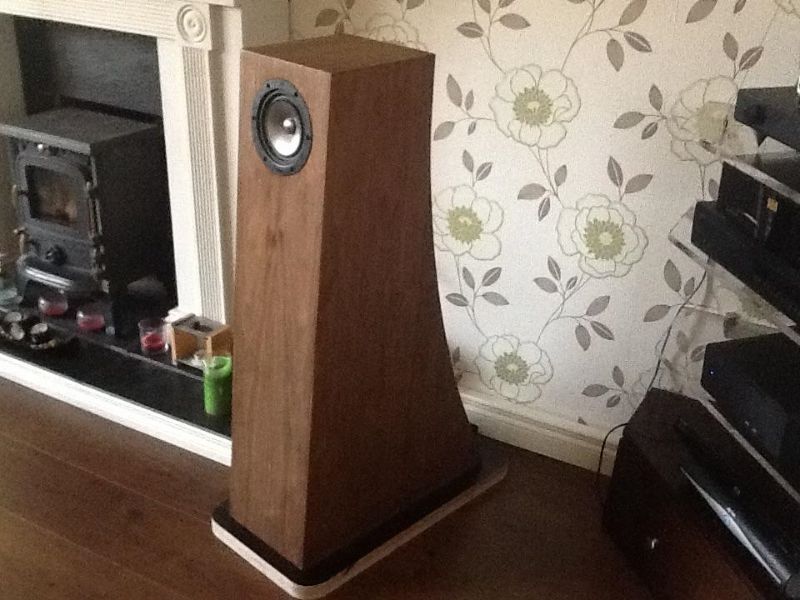

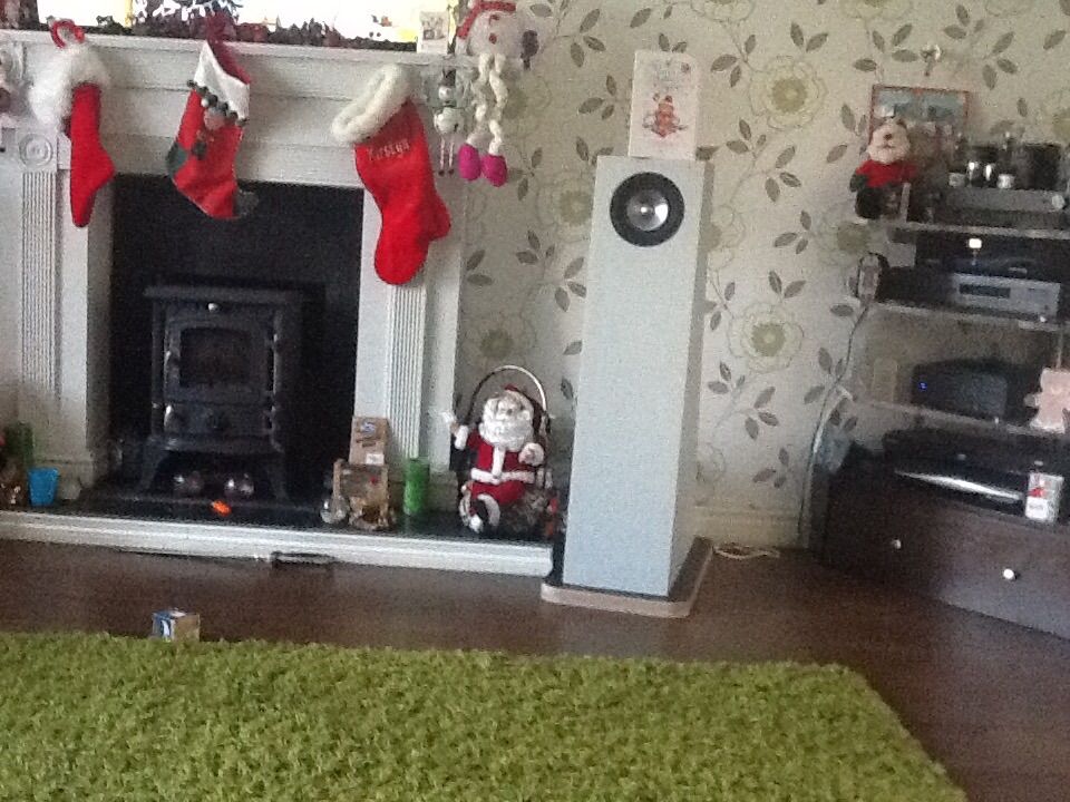

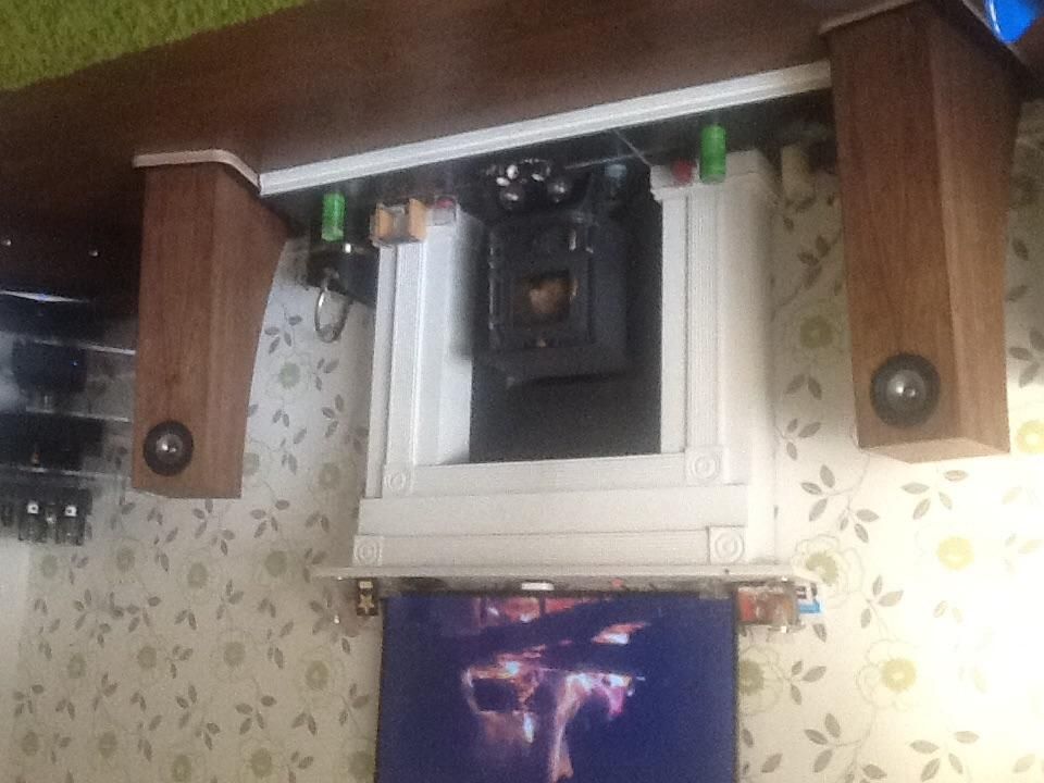

well finally finished the build, camera has given up the ghost, cant get pictures to load onto photo bucket, so these are from my ipad and not great quality, im messing about with the bases with various thicknesses and once im happy will make some and paint satin black.
I have veneered these with American black walnut, after I primed with 4 coats of 2 pack hi build primer then sanded perfectly flat before veneering. 1st time veneering a box so well chuffed with results, dyed a bit darker then Danish oiled, still a couple of coats to do. have about 150 hours on them and removed the stuffing from front baffle chamber and these sound stunning, thanks to Dave and everyone else for advise and support.
this is the primer state,
and as they are today.
