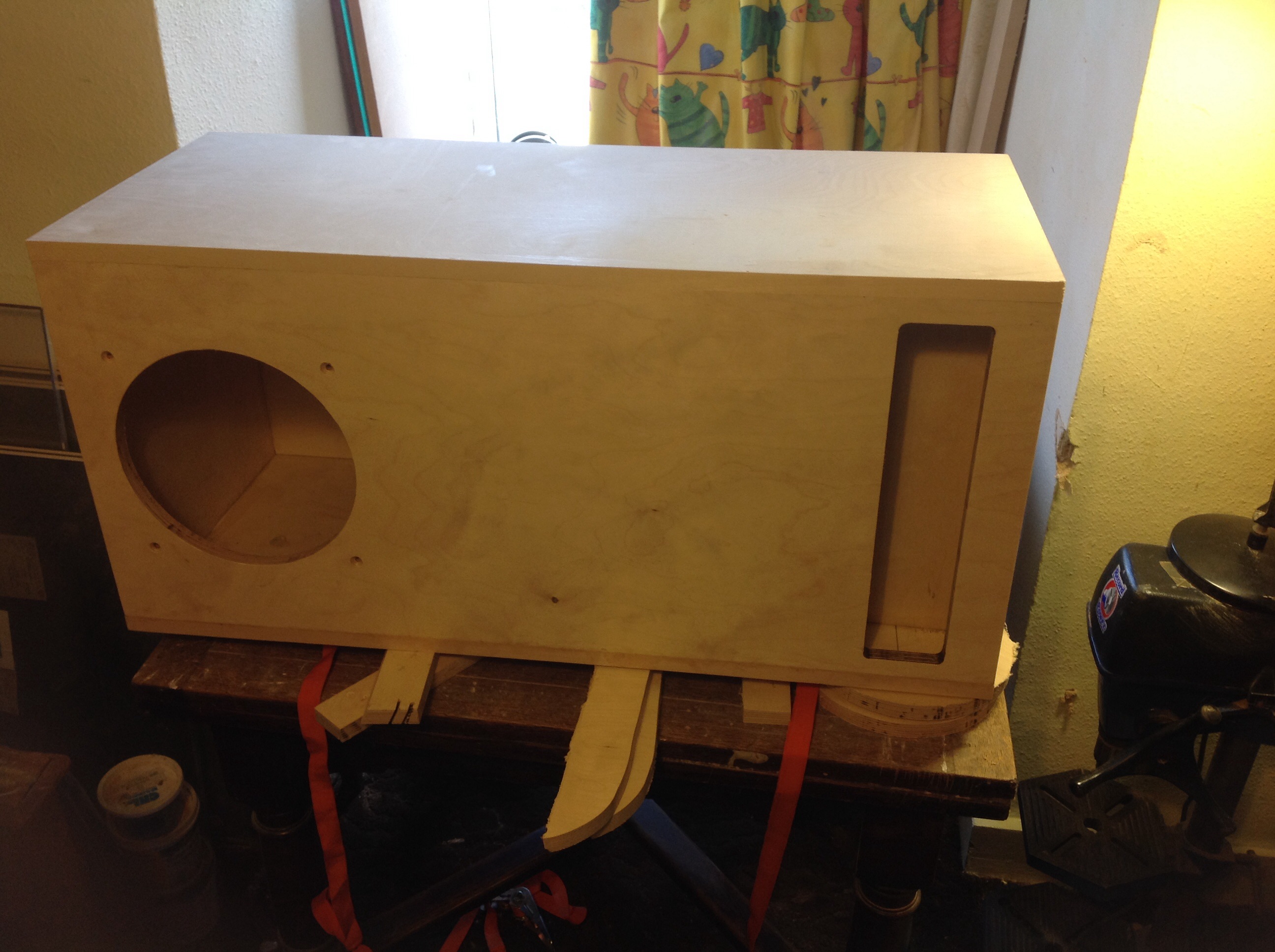

Frugel-Horn XL for Alpair 10.3/10p, Fostex FF165wk, more
Baltic ply? check :)
Drivers 10.3 check :)
Cat 5 cable check :)
W/nut veneer check :)
Pillow Stuffing check :)
DIY FH badges check :)
Speaker terminals check :)
Stainless speaker teminal plate check :)
All i require now is advise on glue, was going to use evo stick wood glue. Is this ok?

I've never used evo stick wood glue, so I can't comment about it. I use Titebond wood glue. I've never had an issue with it and would recommend it to anyone asking.
Mike
For insane strength you could try the titebond3 or gorilla glue, I've used both and they set so hard that the wood will tear apart before the glued joint separates.
But for the set I'm making at the moment, im just using normal PVA wood glue, and I haven't the slightest worry that it's more than up to the job.
Best wishes for your build.

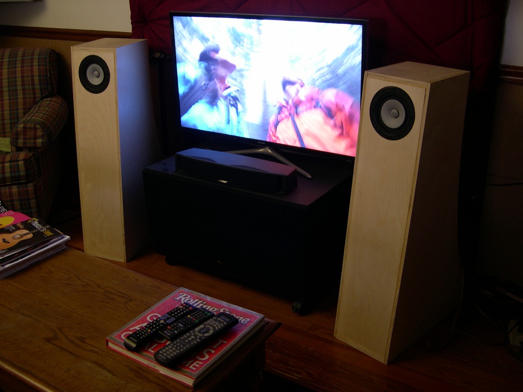

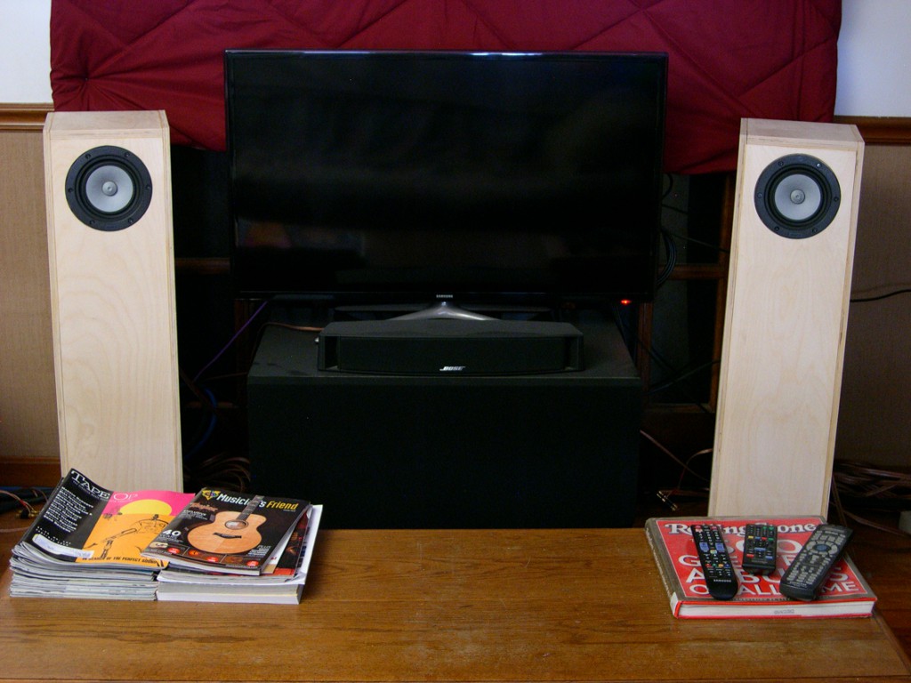

Here are a couple shots. I think I am going to finish them with a veneer, but right now still just listening and deciding.
looing good, few questions if i may.
1, Are you going to put a base plinth on these or spikes?, when i did open baffles before the bass was so low it rattlesed the room like crazy, but when i decoulpled from floor with 1" spikes these were fantastic with good tight deep base and no room interactions.
2, i am starting mine this week if work allows, and i too will be veneering these. if veneering what will you use to cut the access veneer from around the driver opening, i can get a palm router for the edges but wondered if theat can be used with the opening as there is a step with the rebate so the cutter may not sit flush as i hits the rebated step.
3, How much stuffing did you use in the box and what material did you go for around the upper box on top sides and behind the driver?

1. I will probably try a base of some sort in the future. At the moment there is no rattling/buzzing in the room at all.
2. I have never done veneering before, so I am not sure how I will cutting it. I am just starting at woodworking, so this is all a great learning process.
3. I used the recommended 1/2" felt for the driver area. I also used the recommended 40g and 80g of the stuffing, but have removed 20g from the front to add a touch more bottom end. Very happy with that at the moment.
I purchased a yard of a fishnet type material from Wal-mart for a dollar, and cut out 1 foot squares. Hot glued them about a foot from the bottom of the cabinet to hold the front stuffing in place.
