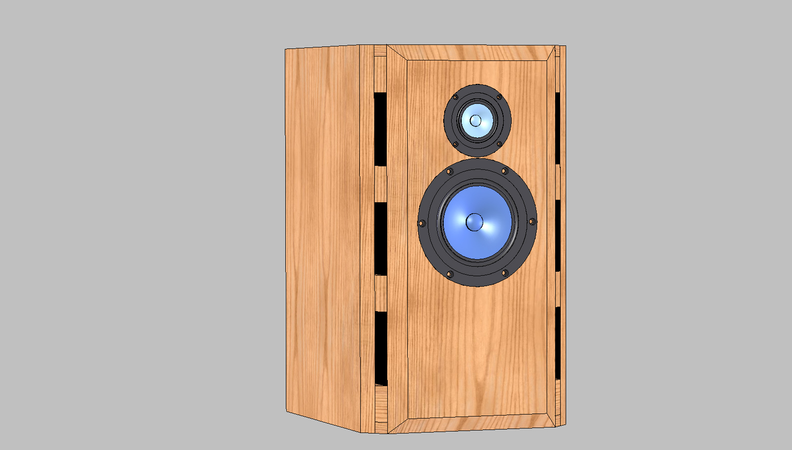

Honestly, if considering investing in 2 Alpair drivers per enclosure, I think a better approach would be A12PW / A7.3 or even A6M combo, in MLTL, XO anywhere between 250Hz and your favorite point. Indeed, I think there was a design by Mark for something along those lines, perhaps it was a simple BR? - hard to recall exactly, but Dave or Scott would have a clue.
That sounds like the simple 2-way that was posted back in 2014.

That's the one I was thinking of - with appropriate adjustments to XO ( might be a bit more complicated, as I think Mark & Scott were targeting for as simple as possible?) is there any reason such an arrangement couldn't work with A6?

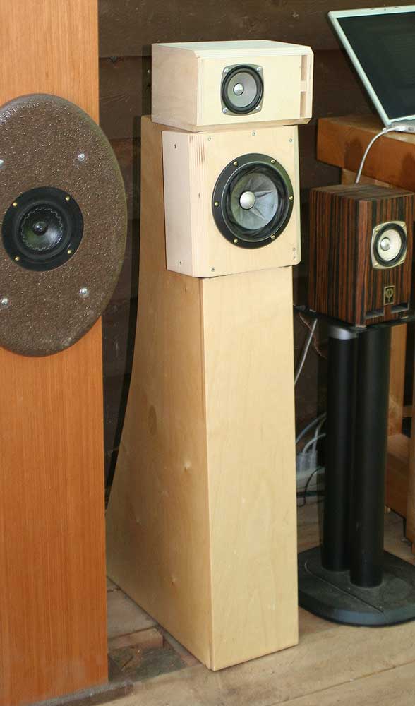

The Alpair 7.3 supposedly has better highs. The Alpair 10.3/10p has better bass and fatter mids. Any chance that one can run them full range either in parallel or series in one cabinet such as the XL?
You wouldn't want to have them in the sameenclosure. Something like this lashup we did one diyFEST would work...
attachment.php
Here the FE138eSR, the limited edition driver that raises the Fostex shout to a screech, and a set of uFonkenXK active at 100 Hz 2nd order (an old Ace Audio XO that was kicking around). The FE138 in FH3 can sure kick out the bass.
dave
Should work ok, as that particular combo is the one I'd pursue for my own use. The only issue is the A6p (and metal?) are about 1.5db down SPL wise from the 12wp. Of course, if you're bi-amping with PLL components, it's not going to be an issue. I drew up a box model after Mark introduced the A12WP. IIRC it's close to 50L in volume.
