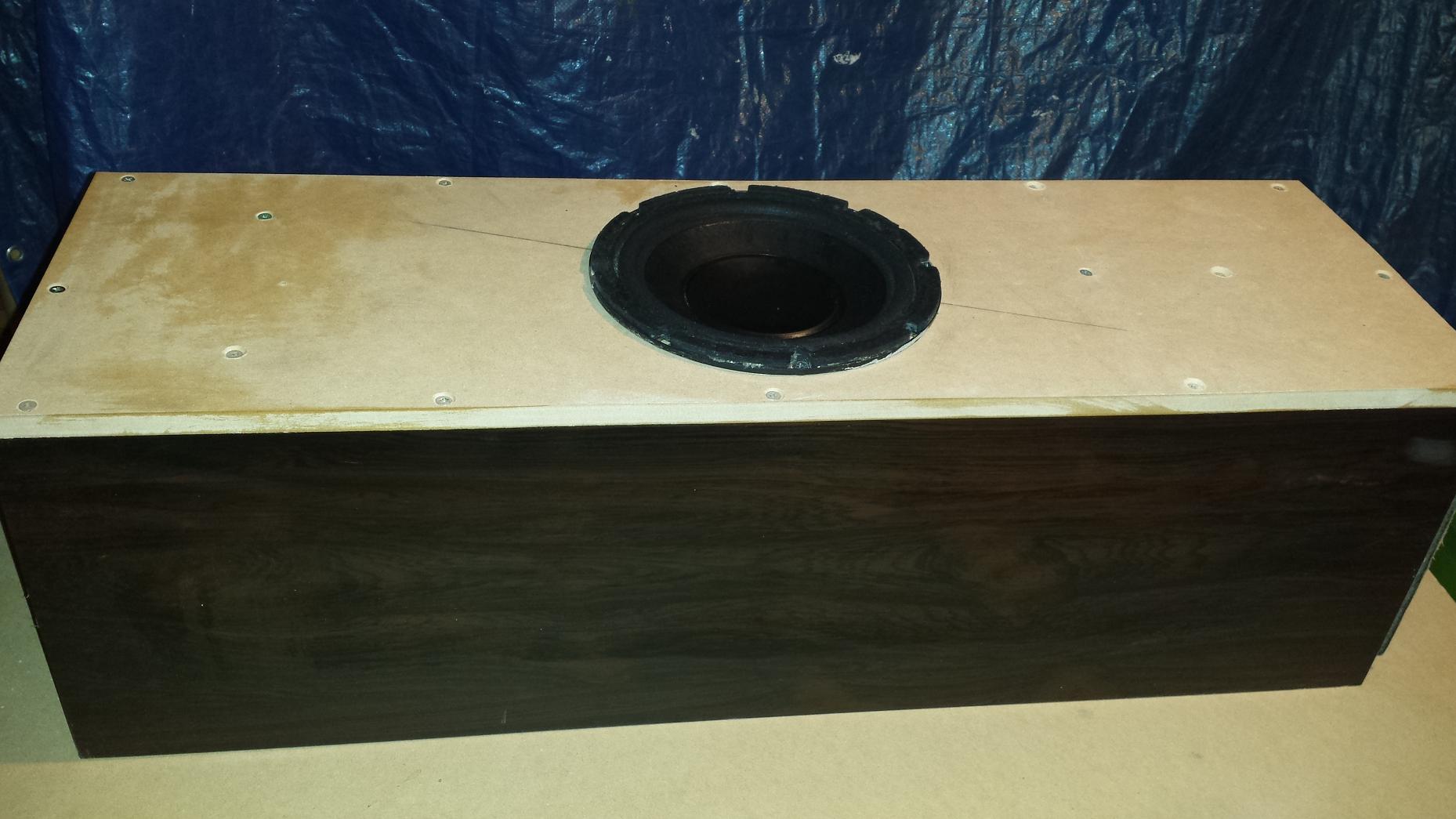

BTW, I was busy a little earlier whipping these up.
After displacement, they come out to roughly 0.36cf. The port is 1.5" x 1" L which makes it an 80Hz tune. They have a little bit more "body" and weight to them now, and it seems that the forward-ish upper midrange has backed off a little as well, probably due to the larger enclosure and actual stuffing instead of old socks. LOL!
Depending on the music, they can put out a fair amount of bass considering. They are definitely the best sounding cardboard box speakers I've ever heard.
Anyway, here's a few pics to laugh at... urr... I mean look at.
Check out that flared port, meticulously researched and designed after B&W's own golf ball dimpled ports!
