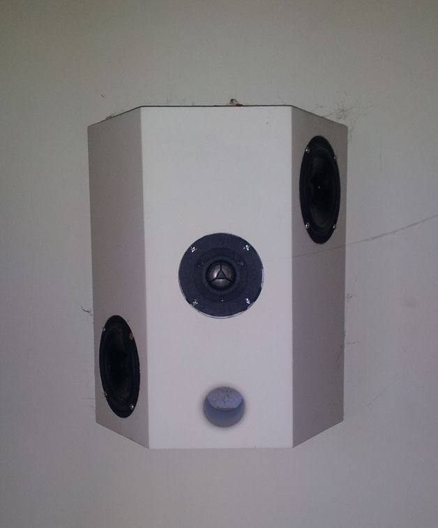

I have no idea how your speakers work. Are those television speaker modules you have inside? Where does the sound come out?
Yes, they are TV speakers- they have a "waveguide" attached, which fires along the wall to the sides, with the roundovers terminating the "waveguide", in a dipole arrangement. The two sides are out of phase with each other, they're specifically designed as surrounds, where all the comb filtering, etc, doesn't matter a lick. I'd do things differently if they were to be mains, though.

Yes, it was a 'speaker obscura' for sure. Sounds like a dipole was made but still not sure where sound outlets are relative to curved ends.
The slot output is along the wall-
The roundovers are oriented vertically, as are the slot-style output from the TV drivers- they're visually hidden behind the roundover, and the "waveguides" are flat against the wall, so the wall acts essentially as an infinite baffle, while the roundover lowers diffraction from the slot termination. The picture above that shows the assembly before dressing up is how the slots and roundovers are oriented, though as shown while still working on it, it's 90 degrees rotated. They fire out to the sides, along the wall, when mounted- I hope that clarifies!
So are you saying the waveguides focus the high end and the back of the drivers combine with the roundovers for a "horn" effect on the low end? I don't see anything that looks like an infinite baffle if the sound comes from the gap between the roundovers and the walll surface. It's my understanding if the energy from the back of the drivers was captured on the other side of the wall there would be an IB separation.
Or are you using the phrase "infinite baffle" to mean super wide, super tall reflective "front Baffle"?
The drivers are wired out of phase to either side, so there's cancellation on the "inside", though naturally it's not perfect. The output all comes from the slots except for some residual sound from the magnet-side of the drivers. The slots are terminated to one "side" by the wall, and the other side with the roundovers.
"Infinite baffle" is naturally not 100% applicable, it's just my way of describing that one side of the slot (the wall) is very large. I'm still experimenting and will likely add acoustic damping all around the back side of the frame (right now there's a fair bit but there's room for more) to further minimize any output not coming from the slots.

I think he's doing kind of a Bose thing but not sure yet.
They're surrounds, so the concept is that of a very diffuse soundfield, with a lot of reflected energy, yes. The last thing I want to do is localize the surround. I'm less concerned with high fidelity as I am with preventing them calling attention to themselves sonically.

Running wire through the attic and initial listening tests have lead me to several conclusions:
1) My bad knee doesn't like kneeling on rafters while pulling wire
2) My Roku player (primary source in the bedroom) doesn't output 5.1 despite having that in the configuration options- old model, and the updated firmware is designed around newer versions
3) They are very good at disappearing, even when playing relatively wideband- the surrounds really do help expand the sound of the room.
They'll get some more tweaking and refinement, but I'm pretty darned happy with how they came out, and got some solid foamcore time and experience. The front panels are constrained layer damped- basically weatherstripping between two foamcore layers, fastened to the wooden frame along the periphery with the white hex-head screws- I got them with integral bonded washers. I'm going to use that screw layout a lot from now on, they were a joy compared to phillips. I didn't even drill pilots.
