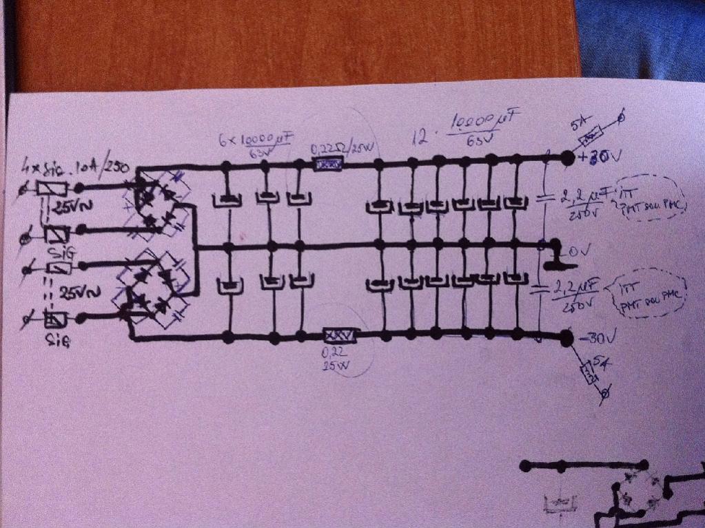

Hello guys,
This year i managed to make some money to buy myself two trafos E+I 300VA@25+25v@5A bifilar secondaries windings for the a dual monos Jean Hiraga 30w "Super Class A amplifier". I want to make a separate 25-0-25V for the input and 30-0-30V just for the output tranies.
Wich solution is better for the best sound quality:
1. The schematic attached (one per single chanel) but with Mr Evil CM instead of the 0.22Ohm/25W resistors for the outputand another CM for the input.
2.The schematic attached as it is (one per single chanel) for the output and a separate Mr Evil CM for the input.
* Can i use a single CM for both inputs from a separate trafo (20+20VA)? Or i have to use separate CM for each channel?
*What is better to use: a separate trafo for CM of the input or take the AC current from the same trafo used for the input?
Thanks in advance

post584 shows an rCRC PSU.
That gives a low ripple supply with an output voltage that tracks (follows) the mains voltage.
If you want two sets of voltages to supply different parts of the circuit:
Do as the tube/valve builders do it.
rCRCRCRC and tap off different voltages at the different C tappings of the PSU.
The highest voltages are at the beginning and the lowest voltage is at the end of the string.
BUT
the end of the string has current supplied through many Rs, whereas the beginning of the string has current current through only the little r of the transformer.
Draw a big current from the little r and draw a low current from the many R+R+R.
If you need the big current AND low voltage from the end of the string then all the R+R+R run hot and the output voltage varies a lot, not following/tracking the mains voltages. The output voltages varies with the current drawn by the amplifier. Equals bad PSU.
If you draw the Big current at the beginning and draw a near constant low current from the end you have a good PSU.
If you need low current at high voltage and high current at low voltage then BUILD TWO PSUs.

Thank you very much Andrew. I'll build myself another PSU for the input with this CM.
Is it ok to feed both inputs from a single CM and the outputs from separate psu-us? Will they oscillate like hell in this scenario or work like charm?
I want to know if i have to build two, each for both channels or one for both of the channels..

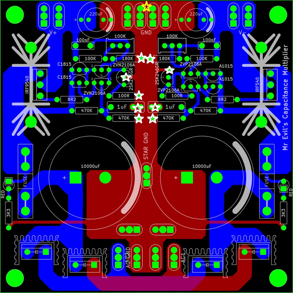

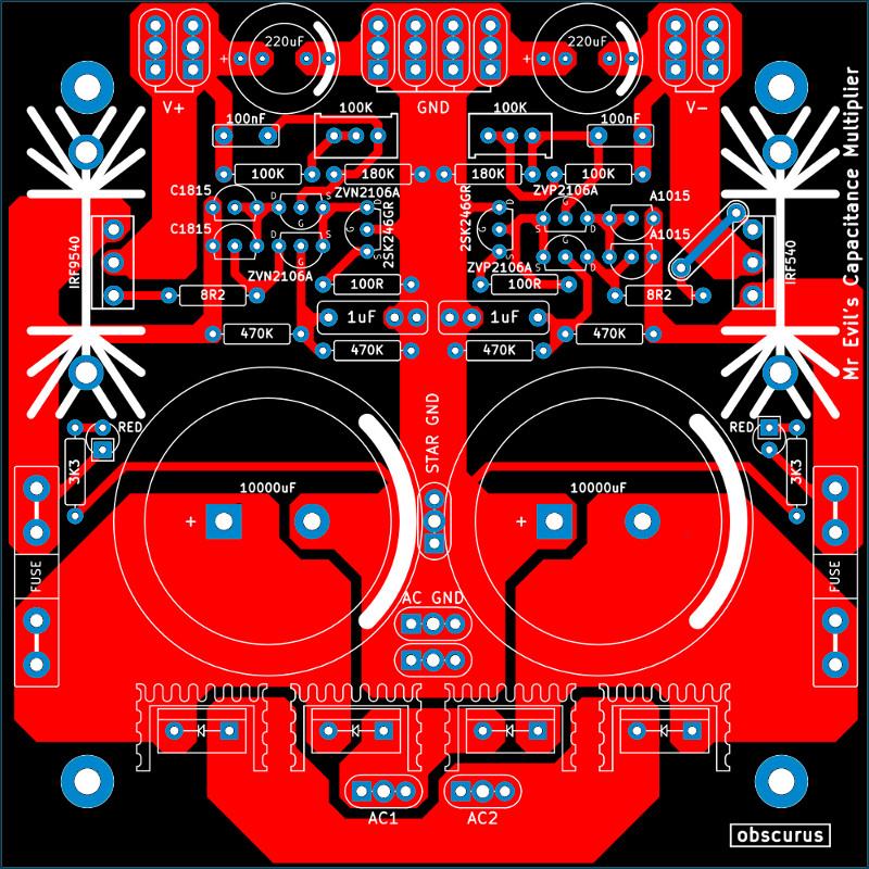

I want to layout the CM with 100mm x 100 mm and use parts that I have on my pocket. So I did a single side layout of CM. But I'm not sure about the quality of my layout.
I will attach it here so may be some one can correct / point out what missing.
Thanks!
Thanks!
1) There might be just enough room to route the tracks between the fuses and pass transistors on the inside of the heatsinks, reducing the loop area between them and ground. To do that, you would have to swap the fuses with the LEDs, so the fuses are next to the capacitors and the LEDs are at the edge of the board, and flip the IRF9540 so it's on the left side of the heatsink.I want to layout the CM with 100mm x 100 mm and use parts that I have on my pocket. So I did a single side layout of CM. But I'm not sure about the quality of my layout.
Thanks!
2) You might struggle to get to that connector between the reservoir capacitors. The other two between capacitors and diodes might be fiddly too.
3) The diodes are very close to the capacitors. It's not a big deal because they don't give off much heat, but it's better to keep electrolytic capacitors as cool as possible.
4) Make sure the screws you use in the mounting holes don't touch the heatsinks.
The connector between caps are for a single wire connect to star ground outside the board.

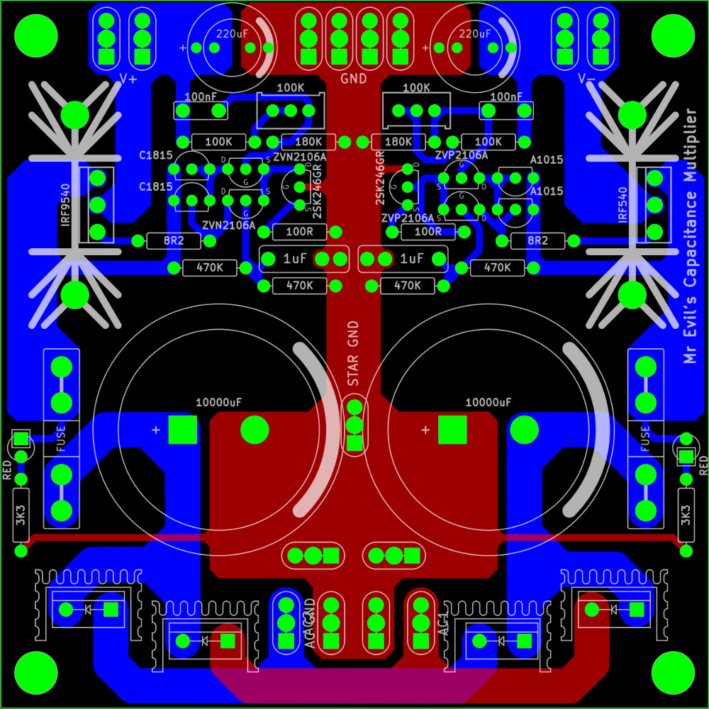

I updated my layout as you recommend. I switched to two sides layout. Could you have a look at it?
Seen many times documented better noise figures when sence points taken as near as possible to load, as is will also work but consider the suggestion. Marked at attached picture 9 white star places that should have own trace or shared trace enroute to yellow star and that you switched to two layer layout should help this. Between the four output GND spades at top of PCB down to 10mF capasitors there's dirty heavy current flow that sence points now avoid sitting in middle of now being more downstream to load and sence at the same point. See some of same in picture of PCB by Mr Evil at post #1.Hi,

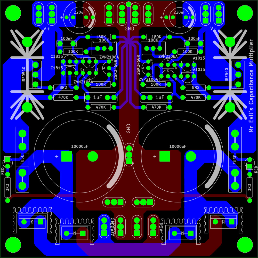

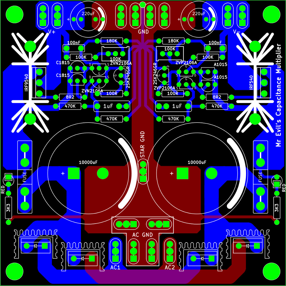

Here is an update of my layout. I connect all ground point to a single point then connect to the yellow star point.

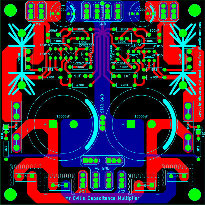

I don't have any plan for a GB. It is for my selection parts. But if someone want to start one, I can provide him my files. With my current devices, the max voltage will be +-40V, it is because of the small signal mosfet can't take more voltage.If you use higher limit mosfet, it can be increase.

Could you include a 'ground loop isolating resistor', or thermistor, next to the 4 way connection point at the top of the board, so the 'ground' wire to the earth point on the chassis can just be a direct connection - much simpler ....
I think the 'ground loop isolating resistor' must be connect to the center ground point (between two big caps) rather than at the top of the board?

@pinnocchio: I think I'm wrong about max voltage with current part choose.
The maximum voltage depend on
- Big cap voltage rate ~ Vp
- Output cap. ~ Vp
- Mosfet max voltage ~ Vp / 2
- Jfet max voltage ~ Vp / 2
Here the latest layout with pdf files attached (not mirrored). There are only some smalls change.
