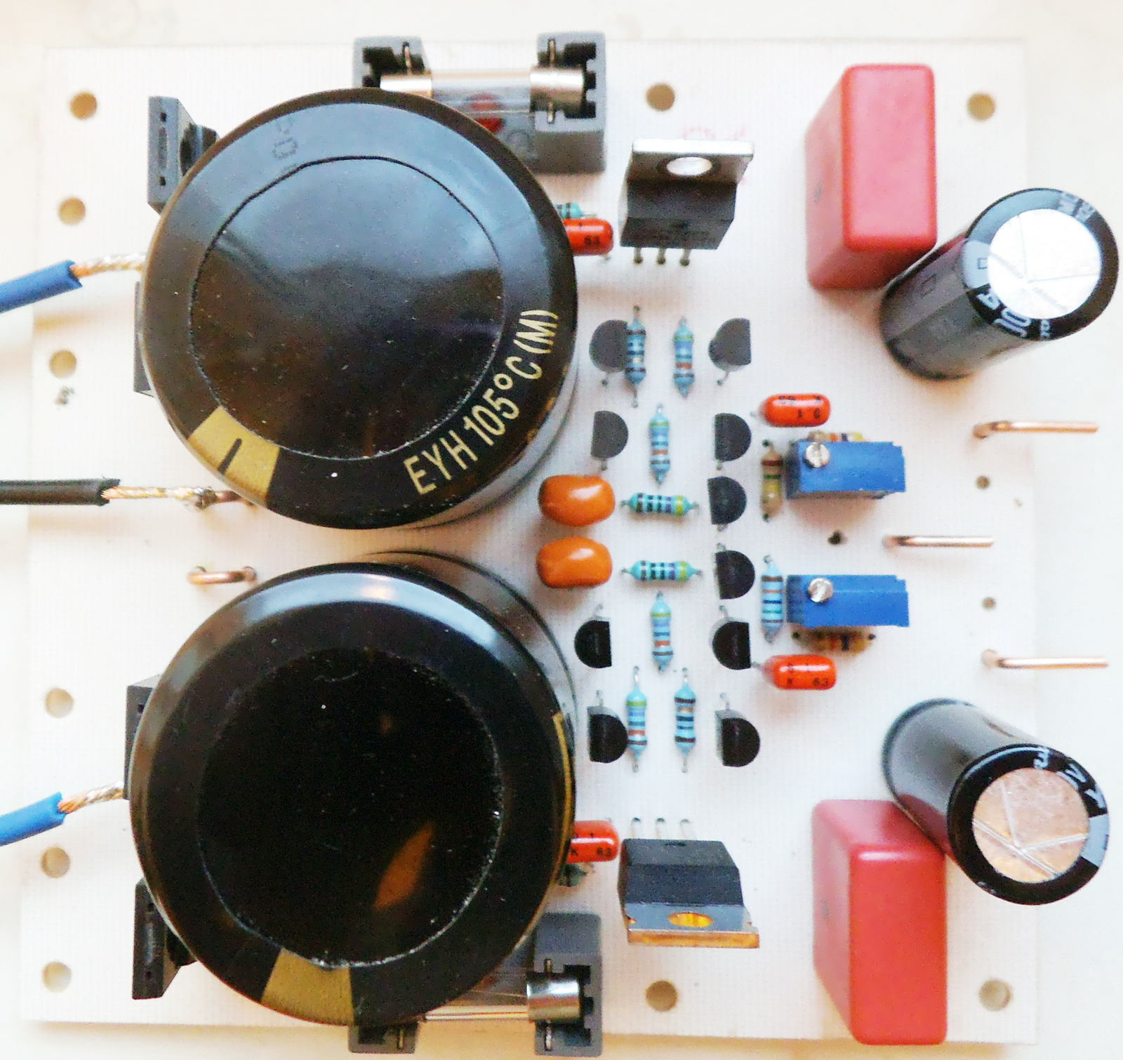

I did supply the following elements:
BYW29-200
BS170, BS250
IRF9540, IRF540.

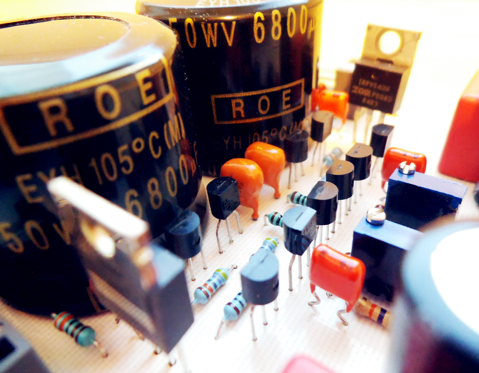

Capacitors 6800UF the bridge and 1000uF output. Without the output capacitor arrangement strongly attracted.

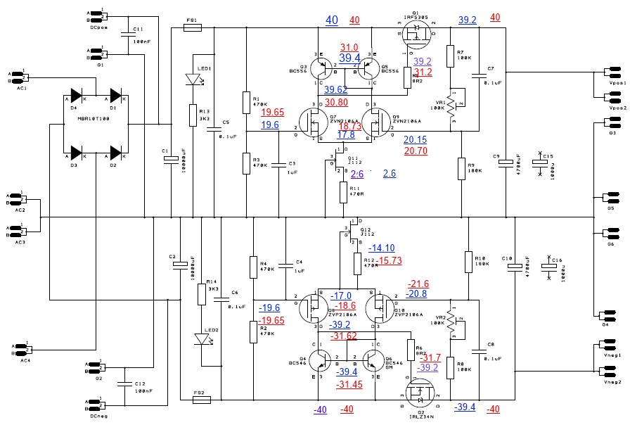

Ok, I finally had a some time to sit down and take some measurements. Please see attachment. The blue numbers represent the working unit and the red numbers represent the non working one. the working one uses IRF5305/IRLZ34N, BC556B/BC546B, ZVN2106A/ZVP2106A. The non working uses IRF5210PBF/IRF3710PBF, KSC1845/KSA992, ZVN3310/ZVP3310. Something is not working right but I don't understand enough to figure it out. Suggestions welcome.
Thanks, Terry
Thanks, Terry
The thing that stands out about those measurements is the voltage at the bases of the current mirror transistors. It shouldn't be possible for them to be more than 0.6V from the rails. After seeing that, I checked the datasheet for KSA992, and the pinout is ECB, whereas the BC5x6 are CBE. You might be able to bend the leads enough to get them in the right way.
Those devices comprise the current mirror for the differential amplifier and actually are not exposed to much voltage across them. The limiting devices are the pass transistors (they see full voltage across them during start-up) and secondarily the differential amplifier MOSFETs and current source JFETs, which in PMI's version see about half a rail.
The BC546 / BC556 pair are 65Vce devices and aren't likely to see more than the required gate voltage of the pass transistor so should work with virtually any rail voltage.
