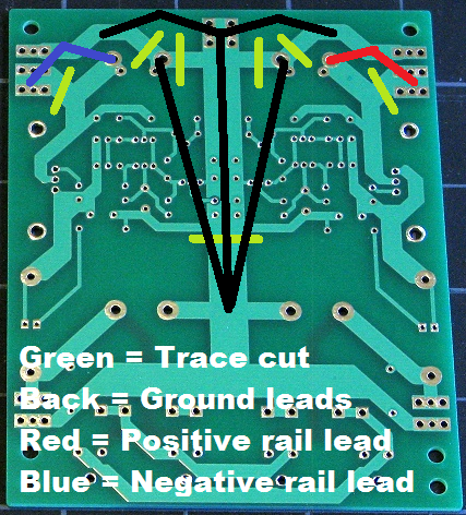

I cut a few tracks and ran separate wires on a few of these but didn't notice anything 'big' in the way of changed sound but when I changed the o/p caps and added some secondary R-C filters, there was a change in the sound (here, it's pick your own flavour kind of thing!)
Pete, on your second set of boards and components (thanks for those, by the way!) I put the schottky diodes, R-C snubbers, and the C-R-C externally to the main pcb with a separate 0volt line to the central 0v point and got a noticeable difference in the bass/low mids on the F5 amp, but it's a fair bit of extra effort for 'small beer' return, IMO (and this is from a 'clean bass nutter' like me!)

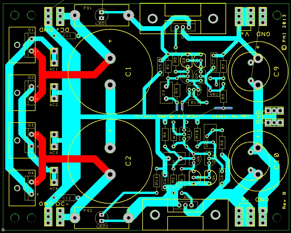

That would be similar to how it works on some closely regulated non-audio PSUs where the load regulation is very important. Here, the output is supposed to be filtered, but the absolute voltage level will rise and fall with the load... allowing it to rise and fall helps to make it such a neat circuit, because the voltage drop across the pass transistor can stay very small. When the power supply gets hammered during heavy bass passages, the voltage at the reservoir caps drops, but the voltage on both sides of the pass transistor moves with it.
the multiple ground leads "read" a voltage. If these multiple ground points are at different voltages the "amplifier" in the middle of your circuit will change it's "output" to suits the differring voltages.
Note particularly C3. It shares a ground trace with components that send very non constant CURRENTs to the zero volts line.
Those varying currents will vary the voltage drop along that shared trace.
The effect is that interference will vary the voltage reference seen by C3. It will affect the amplifier and that will affect the output.
It's the same where the other "measuring" components are tied into a ground trace that is shared with other non constant current producers.

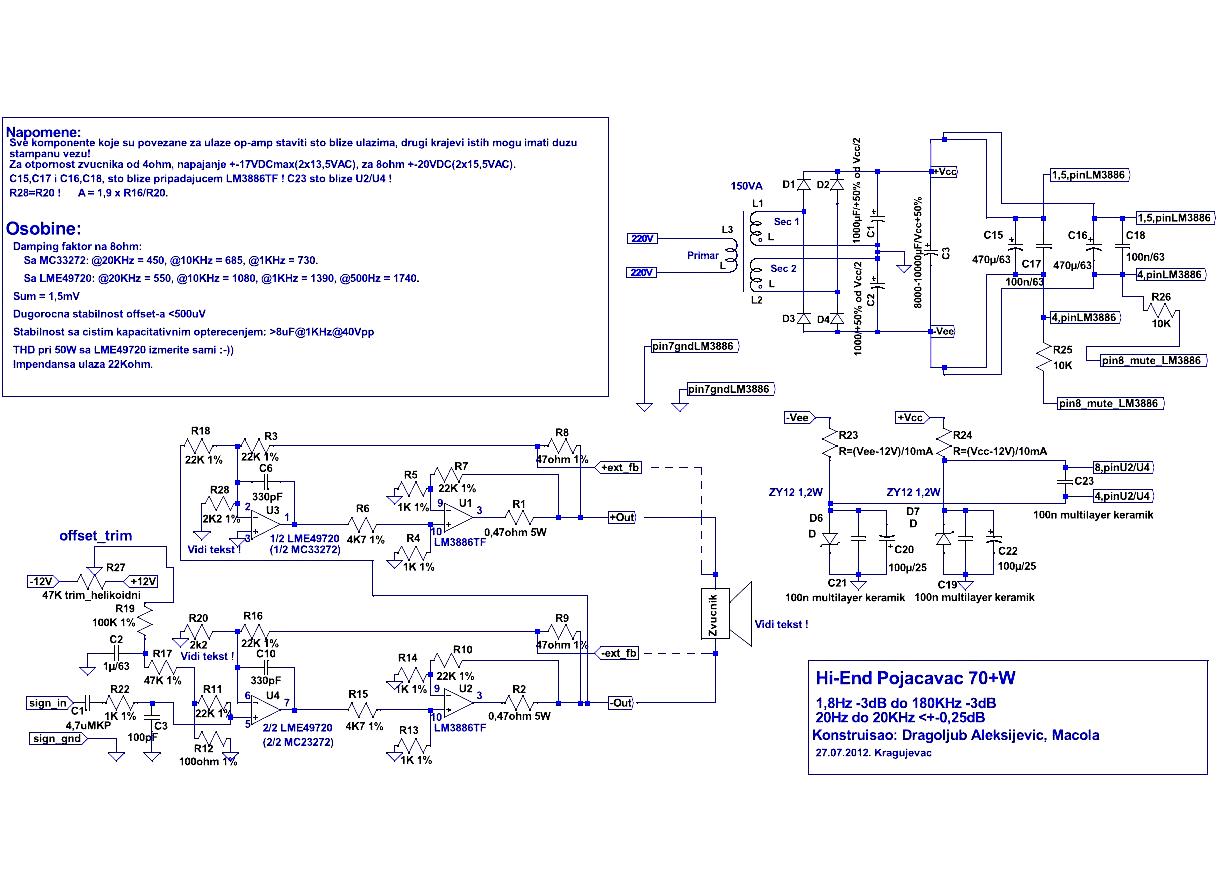

Remote sensing is not the best way to call it. Remote sense is when you take NFB point from loudspeaker terminal with separate wire to amp. There is much about it in some Serbian DIY forums. There are several project currently using it. The idea for it is inspired by lab measuring equipment.

not only.Remote sensing is not the best way to call it. Remote sense is when you take NFB point from loudspeaker terminal with separate wire to amp. There is much about it in some Serbian DIY forums. There are several project currently using it. The idea for it is inspired by lab measuring equipment.

Yes, C3 can be separated from C5 and R13 fairly easily. The central ground bus is fairly clean, to the best of my ability to test. It is actually a pretty low impedance path, when you consider the size.... Note particularly C3. It shares a ground trace with components that send very non constant CURRENTs to the zero volts line.
The effect is that interference will vary the voltage reference seen by C3. It will affect the amplifier and that will affect the output...
If I separate the components in the filter circuit from the main ground bus (which is how it was in the beginning), I will also separate the ground reference for the two rails from each other. Based on past experience, that was something I wanted to avoid, but perhaps this is a case where the top layer can and should be used....

How do you keep that feedback wire free of EMI/RFI and any other interference, shielded cable?I don't know if it is similar to Kenwood's Sigma Drive, but I would not be surprised if it is. The idea is, if I understand it, to eliminate distortions and anomalies present in loudspeaker cables simultaneously with amp distortions.
To be honest I do not follow those threads seriously (because these threads are epic in length) and do not know the answer to your question. I would have to read some of it to see. Here you have schematic of one such amp designed by the legendary Dragoljub Aleksijević - Macola that uses LM3886 power ICs.
I'm not sure that you would need to do much. For instance ATX power supplies use a simple unshielded wire for 3.3V remote sensing. While the wire is not very long compared to a speaker cable, the inside of a PC is full of RF. This might be a good use of a spare pair in a Cat5 cable.How do you keep that feedback wire free of EMI/RFI and any other interference, shielded cable?

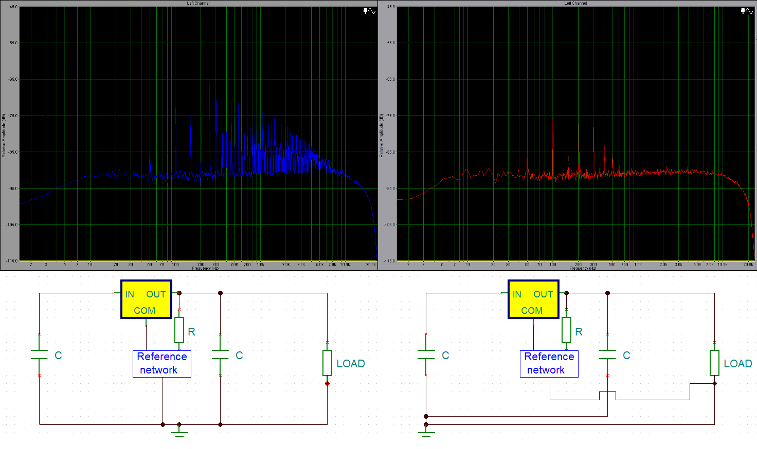

For routing/layout concerns started by member "AndrewT" i have little input. First i say that nothing of my input is to make shipped PCB's better without documented measurements or listening tests. It is what i have learned from this site and books and i only post for getting knowledge out and feedback back so everybody can learn. Think it is same boat as members "AndrewT" and "Jameshillj" mention. This routing/layout are very audible in sensitive preamps for audio/musical instrument, and best it is no cost in bits and pieces.
First Picture:
LM317 example with same schematic but different routing/layout. In a simulating program this will give same result but real world as seen is very different. The plots i downloaded somewhere from this site couble of years ago and as i remember was taken with 16bit soundcard. The schematic layout underneath i made myself tonight before posting for understanding of routing seen in plots.

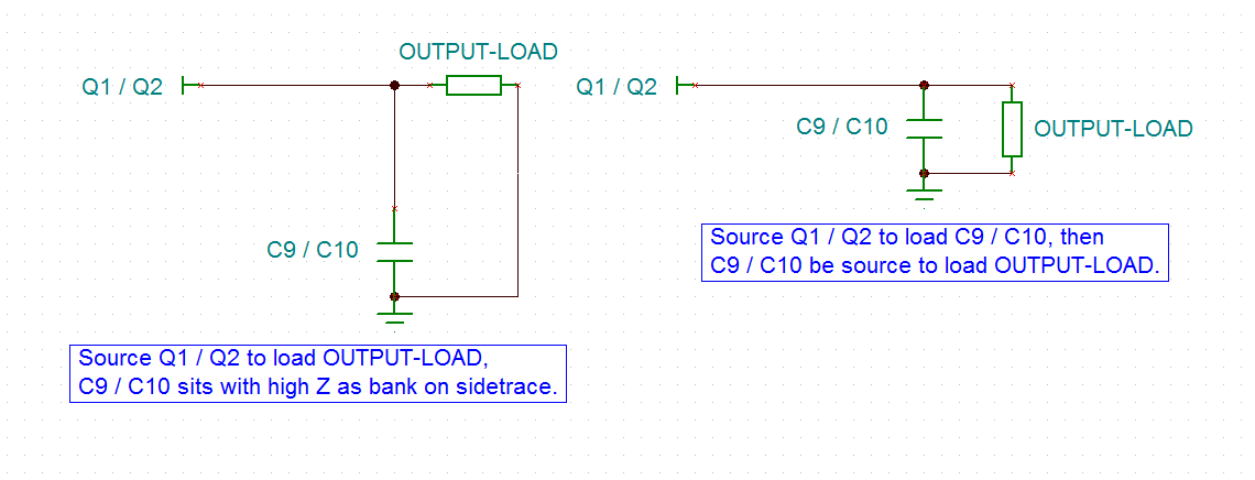

Second Picture:
Taking on SMALL shoes, little routing improvement can be made for C9/C10, see text in Picture.
Third Picture:
Example of one (or make your own) easy way to amend PCB for maybe better routing.

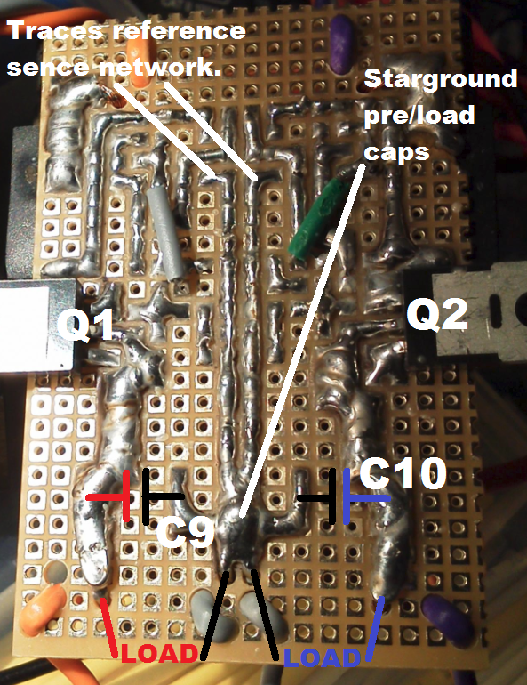

Fourth Picture:
Example routing/layout by member "Metallicus69" taken from #post490.

YES !!!!!Now I know why my LM317/337 regulator for phono stage has some noise (BYRTT first picture)............ do we still need adjustment pin ground to be connected at the load?
At the load connection, i.e the output side.
With regard to the discussion a couple pages back, here is another possible component placement. (The current one was really aiming at a different ground scheme, so, not so easily converted)R11 connect direct to Q11 source.
C3 to R3
R9 to Q11 trace
R3 to Q11 trace
Q11 trace to output, AT THE OUTPUT.
R11 relocated and connected directly to Q11 source
C3 relocated and connected to the junction of R1 and R3
R9 and VR1 relocated to make more room for R9 ground connection
R3 and R11 moved to allow common connection
The different filter nodes connected to ground are left unrouted and highlighted.
That looks very much better.
Now repeat for lower half.
Then change the main (across the middle) ground link back to it's original width (where possible or waist it where not possible).
