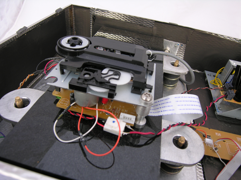

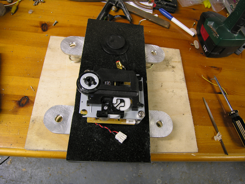

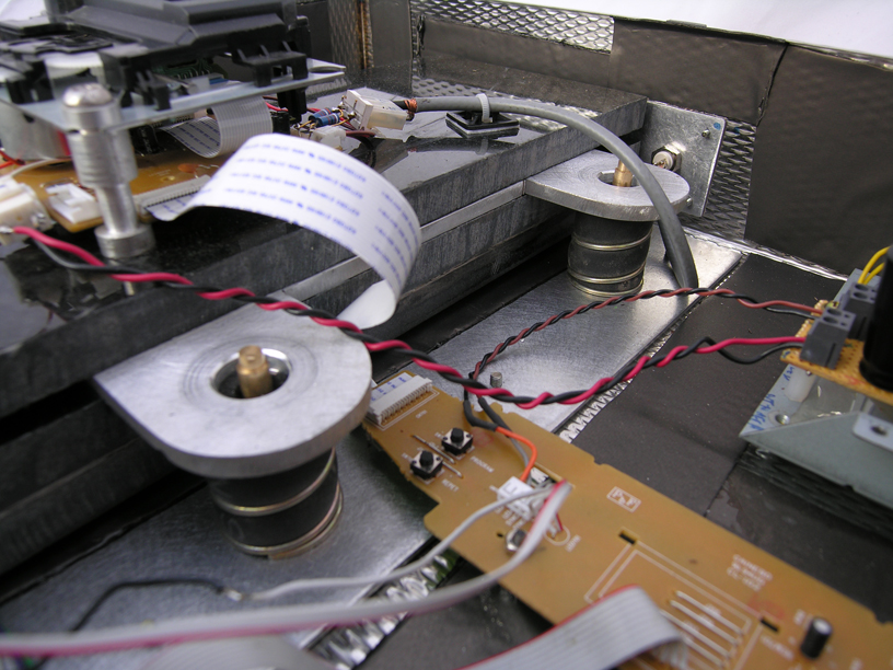

I successfully used granite for one of my builds. I bought a granite chopping board from my local tesco, and then cut that into 3 using a tile saw. I stacked and then bonded the 3 layers together with silicone. I also added an aluminium layer which I used for legs (the whole thing sits on 3 damped springs). This gives me a very inert and heavy support.
A masonry drill bit in a drill press at reasonable speed and flooded with water made the job very easy. I drilled the holes oversized, then fitted the mech to the 2 standoffs, and then epoxied that into place. In this particular build I also separated the control board from the mech.
I think you all need to consider something more than just mass - I think that mass also needs to be decoupled from the shelf too. I used springs - just one solution.
