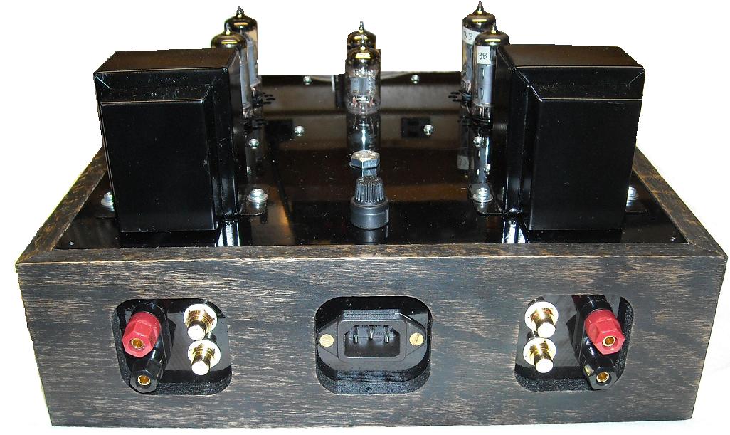

I use wood for enclosures though, copying Peter Daniels idea again....
I have some Paulownia wood to try next, matches my living room...
Cheers

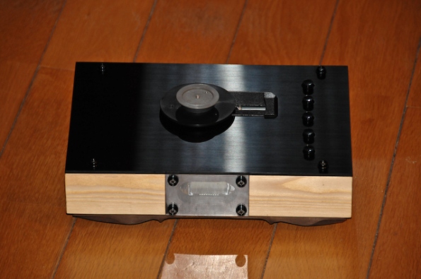

I was thinking something like this
Uploaded with ImageShack.us
That looks nice!
How about a copper top too? Nice warm colour and ages really nicely....
Or champagne coloured anodized aluminum...
Plain aluminum looks good with black wood though...
Just thinking out loud....
I'm happy with the buttons off to one side facing up, but on the front is a nice idea too. Not sure about putting the buttons on the side because I am never sure what I will need to put alongside the transport if I move my listening area around.
If I put the buttons on the front I could use the original switches on the display panel... You got me thinking now tonyptony ....
Bill
I'm definitely with massimo on that.

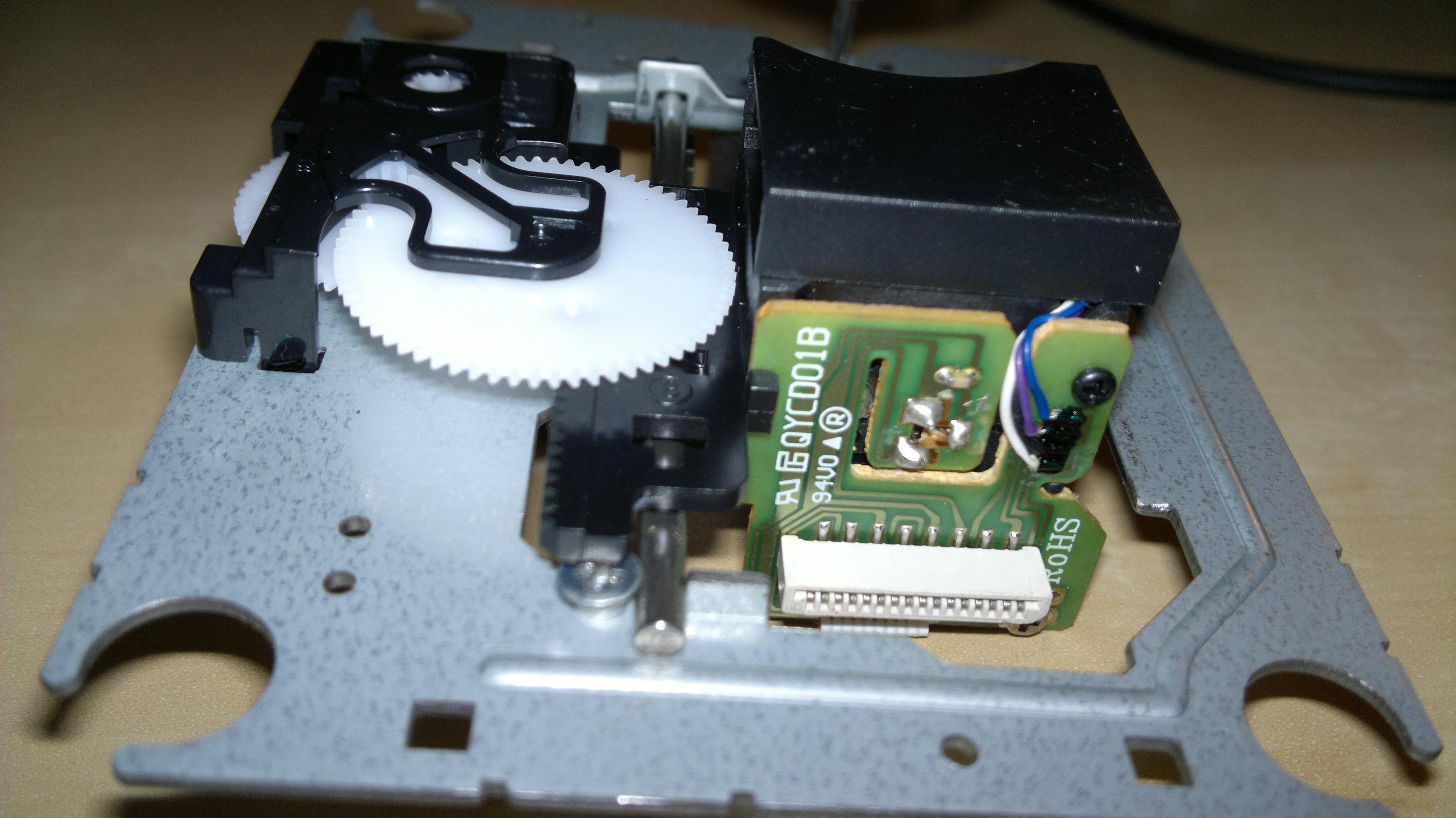

I don't quite see the point of discussing the length of the ribbon cable at this stage though (but maybe I'm missing something?...). The way I'm imagining it, we will have a "control PCB", which we will be able to connect to any compatible CD mech in any way we please - with a short ribbon, with a long ribbon,
...snip ...
One point about the ribbon cable, the longer it is, the more reliable as it will flex less.
This is counter to capacitive coupling and susceptance to radiated interference.
It's a trade off.

How about an eclosure that has an aluminum top plate mahogany sides and a copper base. I dont think it can be 1/2 rack there wont be enough room for the transformers and shunt regulators. Since its top loading, we should just design a custom size. Or we can even make a seperate housing for the power supplies. This way you wont need to take the whole cd player apart if you want to make changes to the regulators.
Why copper base ? electrical reason, or only for weight .
Bill
If I got anybody thinking it was an accident! :) I actually meant immediately to one side (either the right or left) of the display on the frontpiece. Hmm, or the display could be set off a bit to the left of the frontpiece, then the switches could go off to the right a bit. That would leave a balanced looking front.
Although I can appreciate why the buttons might be good on the top. After all, it is a top loading transport - and it might be easier to mount switches on a thinner rigid plate than through a hunk of wood.
