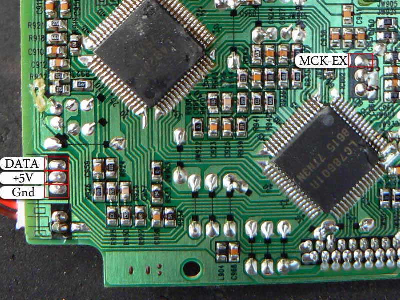

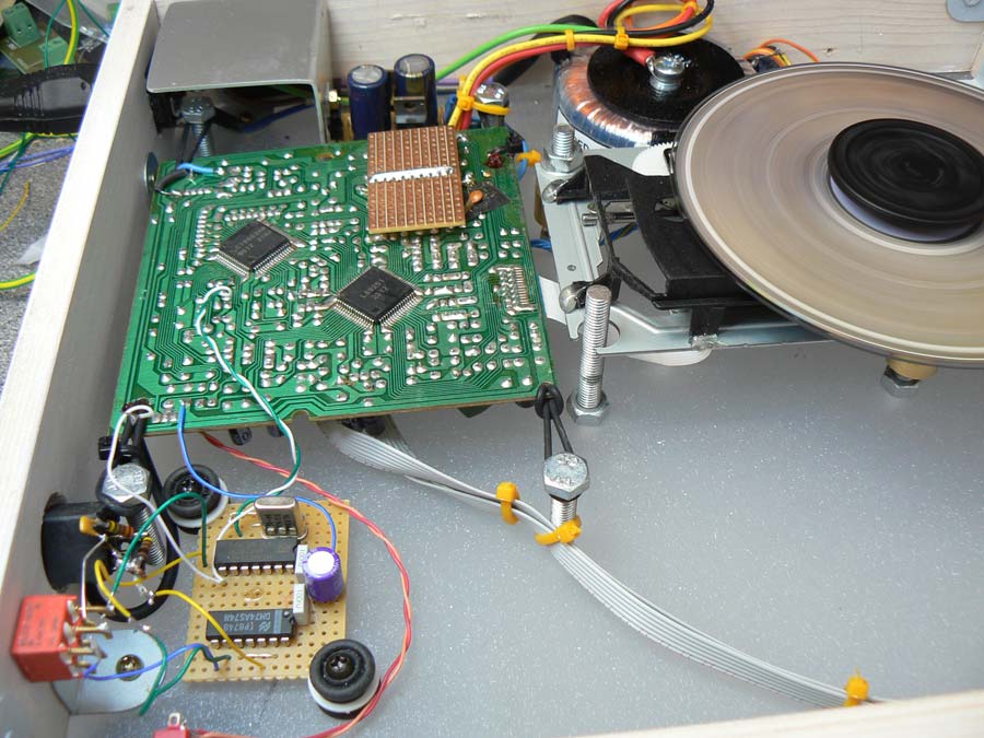

Wow, it works!!
Almost can't believe that it actually works, first time out of the can!!
Here are my pics. Tell you what, my work looks a lot better when the photos are from far away!! (edit: the first 2 pics, I don't have the crystal in because it was still in the shiga but it goes right beside the resistor).
I've only listened for about 5 mins, and like herewegoagain I think its a little more on top right now, more transparent (better highs?), but also, the bass is much tighter. Difference isn;t massive, but is noticeable.
If it settles down a bit and becomes a shade smoother I will be a very happy camper.
How long did it take the rest of you to see this settle down?

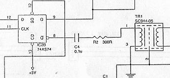

I've put in the reclocking, but using what was available in my local Maplins: A 74LS74 and a 74HC14.
I'm getting a slightly more expansive sound plus a bit more brightness, as others have found.
However the result still doesn't equal the sound I'm getting from my QA-550 WAV player, using I2S direct into a TDA1543 dac. It's a pity that we can't get I2S out of the shigaclone.
Perhaps I need to try again, using the recommended ICs.

Since the choke is removed, you need to connect wires to the other pair of pads, see here: http://www.diyaudio.com/forums/audio-sector/160373-cd-transport.html#post2068918

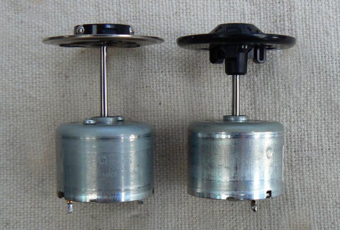

Who tried this one? Was it any good or is the original magnetic clamp better? I can't find that post anymore..
Does anyone know how that is attached to the shaft?
You will need a motor with a longer shaft..

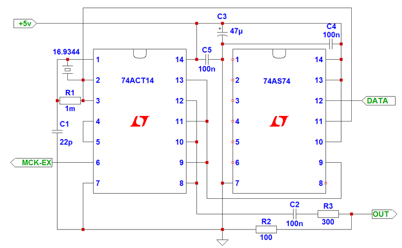

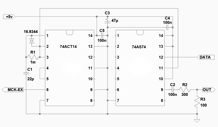

Just completed the re-clock mod.
I am also testing it with the output passing through the spare three inverters in parallel to boost the output.
I am also testing it from pin 8 as used by the TL0..
It will need a few days of listening and I have a switch to select between the different outputs.
Hmm.. It doesn't look that much longer? And the motor type is exactly the same. Is those "clamps" just press fitted or clued also?
