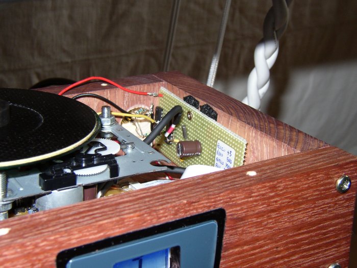

Remove the crystal on jvc board,
connect MCK-ex from Peter scheme to the pad from LC78601 pin61 (see picture)
connect board dout to 74AS74 pin12
I fed the circuit with +5V from the jvc board, the pad between dout and gnd
I omitted pulse transformers, 0.1uF cap and 300R, taking the signal directly from 74AS74 pin 9.

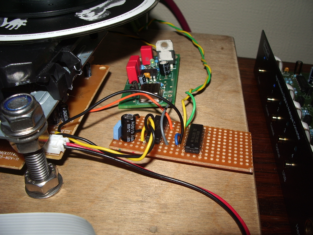

OK I've attached the pic of the circuit I built on vero to illustrate where things go.
the board has 2 chips and 2 caps for local decoupling - if you are using a crystal or resonator then you'll have that and a 1meg resistor too.
the LH chip is the 74act14 the RH one is the 74as74 - they are both orientated the same way with each pin 1 closest to the camera on the right.
The twisted black and yellow wires are +5v and ground - you can attach them to the pads next to the Dout pad on the side of the board. Both chips, pin 7 is ground and pin 14 is +5v.
The single black wire comes from that Dout pad and connects to pin 12 of the 74as74 (data in).
The single orange wire is connected to pin 6 of the 74act14 - it is the clock going off to the board - you can see it disappear underneath where it connects to the old resonator pads (circled in the pic above - the furthest one from the chip)
The single grey wire is connected to pin 1 of the 74act14 - it is the clock input from my Flea/Tent - if you are using a crystal/resonator then you'll have it, and a parallel 1Meg res across pins 1 & 2 of this chip.
The twisted yellow & green wires are my 'data out' - the yellow is connected to pin 9 of the 74as74 (just hidden from view in the pic) - the green is ground. These 2 wires go to my RCA output socket via the 300/100R divider.
for decoupling I'm using a 100u ZA and 100n MKT but for my quick lash up on breadboard i just used what was at hand. The +5v is the same as is used by the board so some experimentation might be in order to suss out the effect of these caps on the sound.
hope this helps fellas
