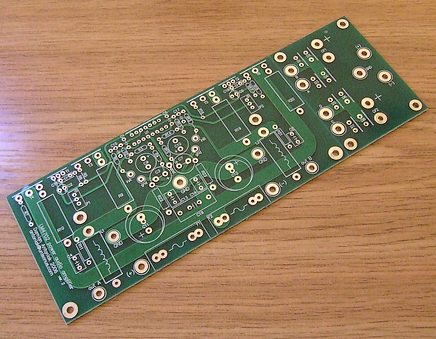

Here are a couple screen shots of the performance with Veteran's first board with some modifications (nothing major) as mentioned earlier in the thread. The graphs are taken with an Audio Precision 1, 80kHz filter, 8 ohm load, both channels driven and in phase (there is some Ch-Ch interaction that causes THD to be higher when both driven). The output power plot is with 1kHz and the frequency plot is with 25W/Ch. Not too bad performance and it sounds really good to me but I must admit I am not a critical listener. But I heard things in songs I had never heard before and these were very familiar songs to me. Excellent definition in the music now, so clear.

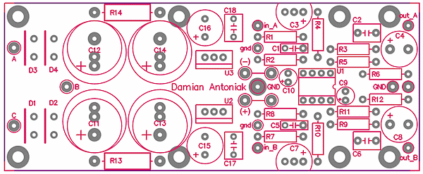

This is my final design of LM4702 with MOSFET transistors. I don't need more power and any other modifications, because two of this boards will work in symmetrical mode. I can put you on the list for 5 boards - I will have them Monday :)
Measurements made by SpittinLLama shows that this is very good amplifier even when assembled with standard components:

alexcd said:
Veteran,
Why didn't you mount the LM4702 to the heatsink like the MOSFET's? I've seen the pins bent up so they can be loaded through the bottom. I figured this was required. Do you heat sink the LM4702 at all? Any pics of the current config to show this?
Depending from supply voltage. A little heatsink is needed - PCB is designed to mount all of the devices on one heatsink.
