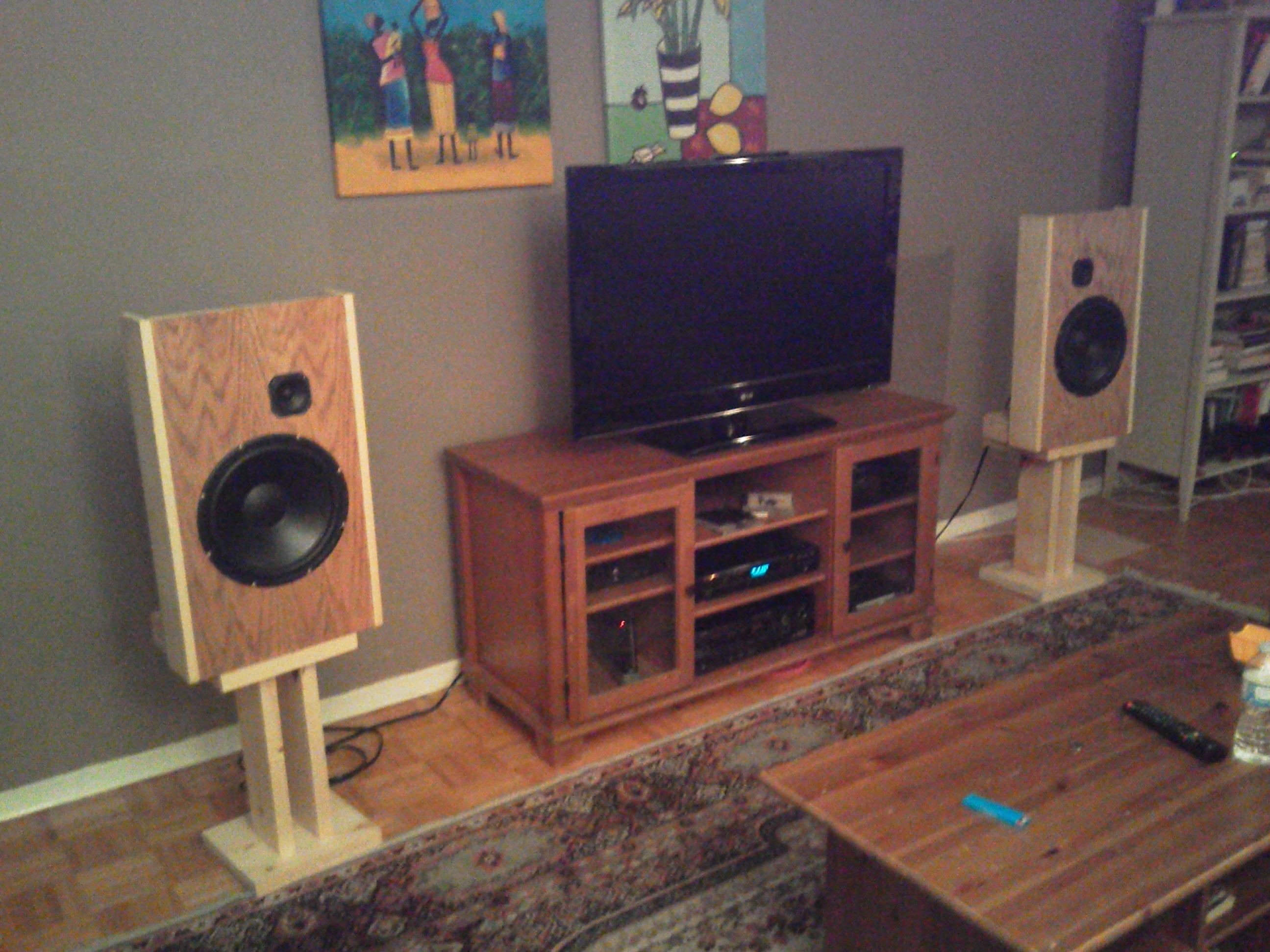

manzanita build
I've built manzanitas recently but never posted anything. They look different now, this was taken the very fist day after the build was completed. Sorry about the grainy picture; this was taken with my tablet.
Anyhow, the speakers works well and I am very happy with them. If anyone cares, I can post a more detailed write up.
Also, I'd like to thank the designers for such a well executed design.

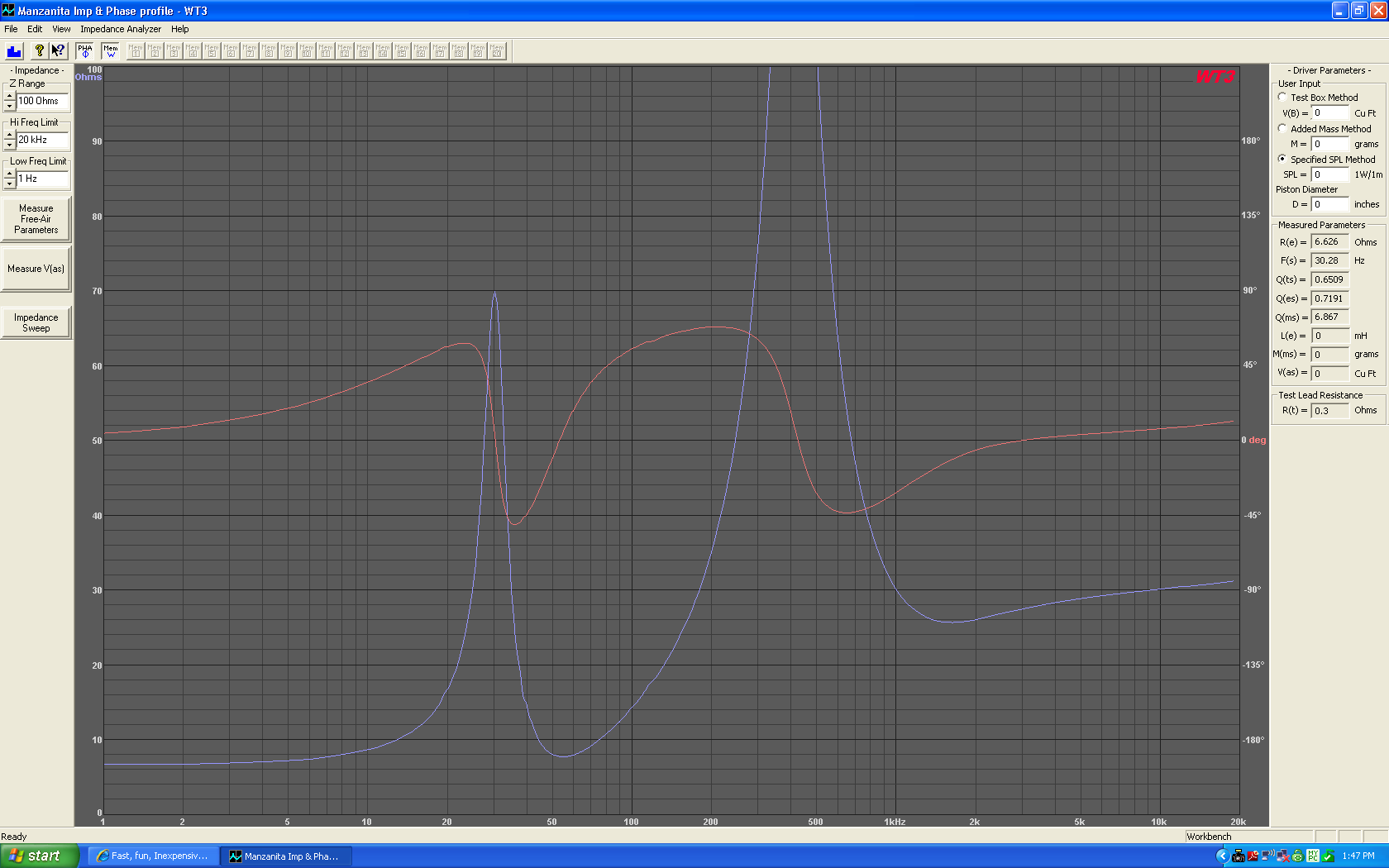

Manzanita Phase and impedance curves
Here is the WT3 phase and impedance data and curves for the current Manzanita. The impedance remains above 6.6 ohms and phase stays between +/- 45 deg. Should be an easy load. Have driven the Manzanita with SET, SET and class A push - pull with out any problems. Hope this helps. John
