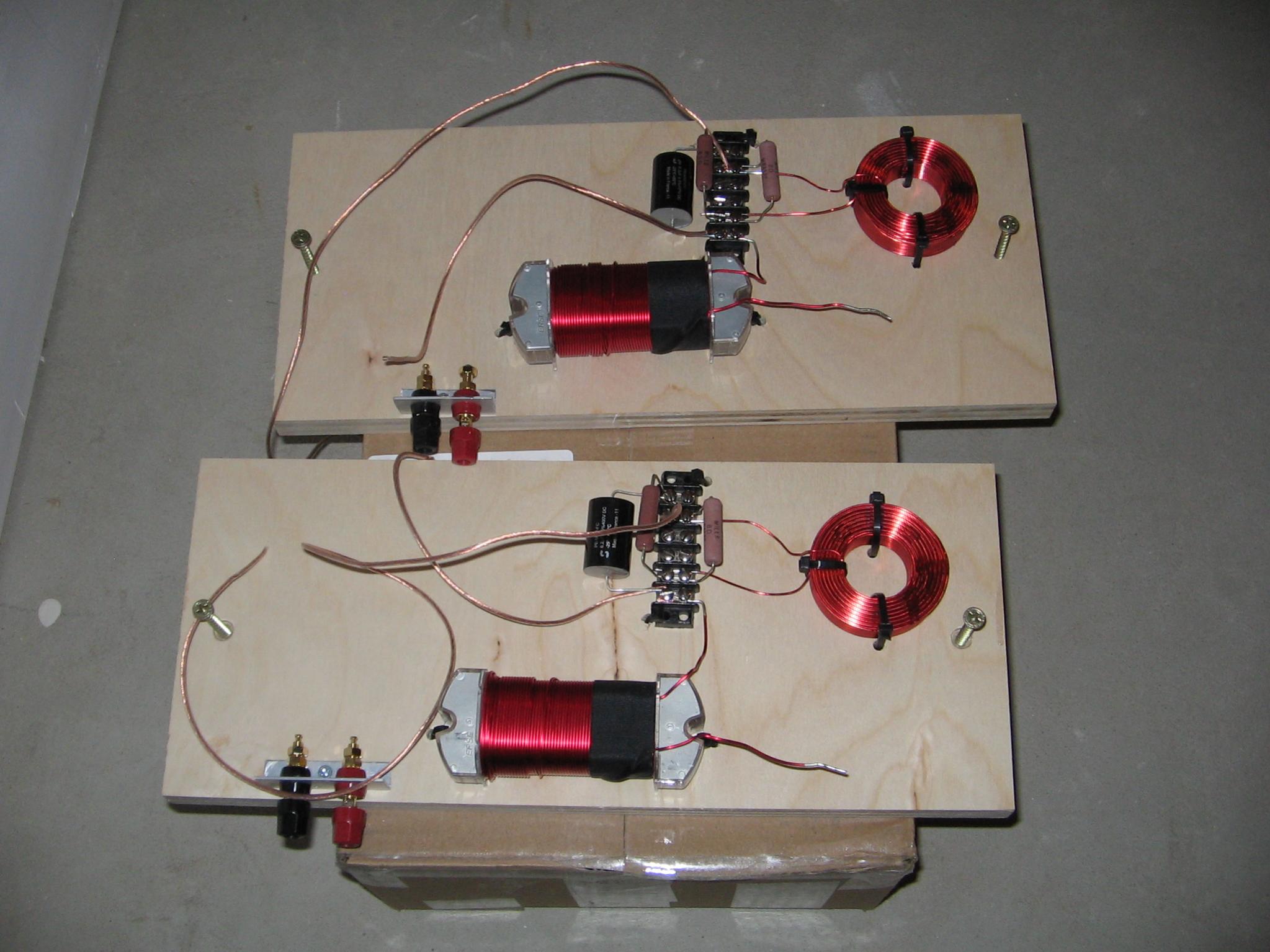

Built up the crossovers, installed, and finished wiring them up. Just using zip cord right now to make sure everything works. I used a terminal strip as a temporary thing. I bought a few extra resistors to experiment with the tone. When all is done I will solder point to point. I stained and then finished with Polycrylic. Installed the speakers. I guess they turned out ok. I laughed at myself when I tried to drive them with the Tubelab SSE I built. I ended gabbing a chip amp I build't about two years ago. It puts out about 65 watts. I thought I had a problem with a crossover after the right channel dropped out after about five minutes. Traced it to a crappy interconnect on the negative side. A 5 cent wire nut fixed the problem. I then listened trouble free for about three hours.
And... what'd 'ya think?

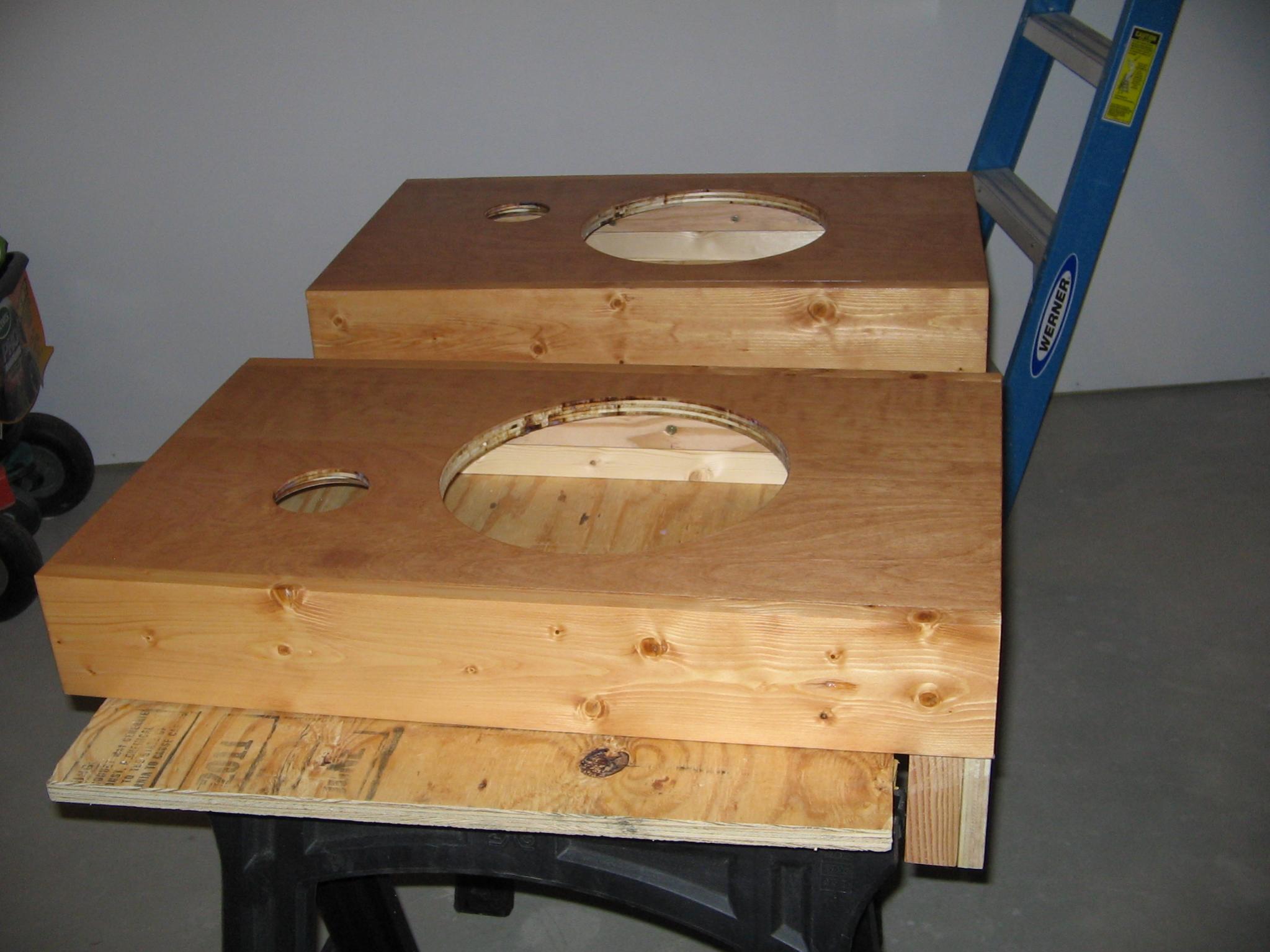

I understand the urge to get started, but experience (read bad) tells me to wait for the drivers and measure yourself. Manufacturer variances are the norm with the exception of the very high end drivers. Even then I have seen differences that made a pre-cut baffle useless. YMMV.
Are the published driver cutouts correct?
Vifa TC9FD18-08 - 78mm/3.07"
Peerless - 275mm/10.82"
I've got the parts on order and the baltic birch on hand ready to cut.
I cut the Vifa at 3 1/16 inch. It fit perfect.
I cut the Peerless at 11 inch. The hole might be 1/16 too big for a snug fit but the gasket on the speaker fits perfect onto the plywood surface. When you get the Peerless you'll see the gasket and where the speakers mounts. Anyway, I cut hole in thin scrape to verify fit before I touched the finish plywood. Good luck.

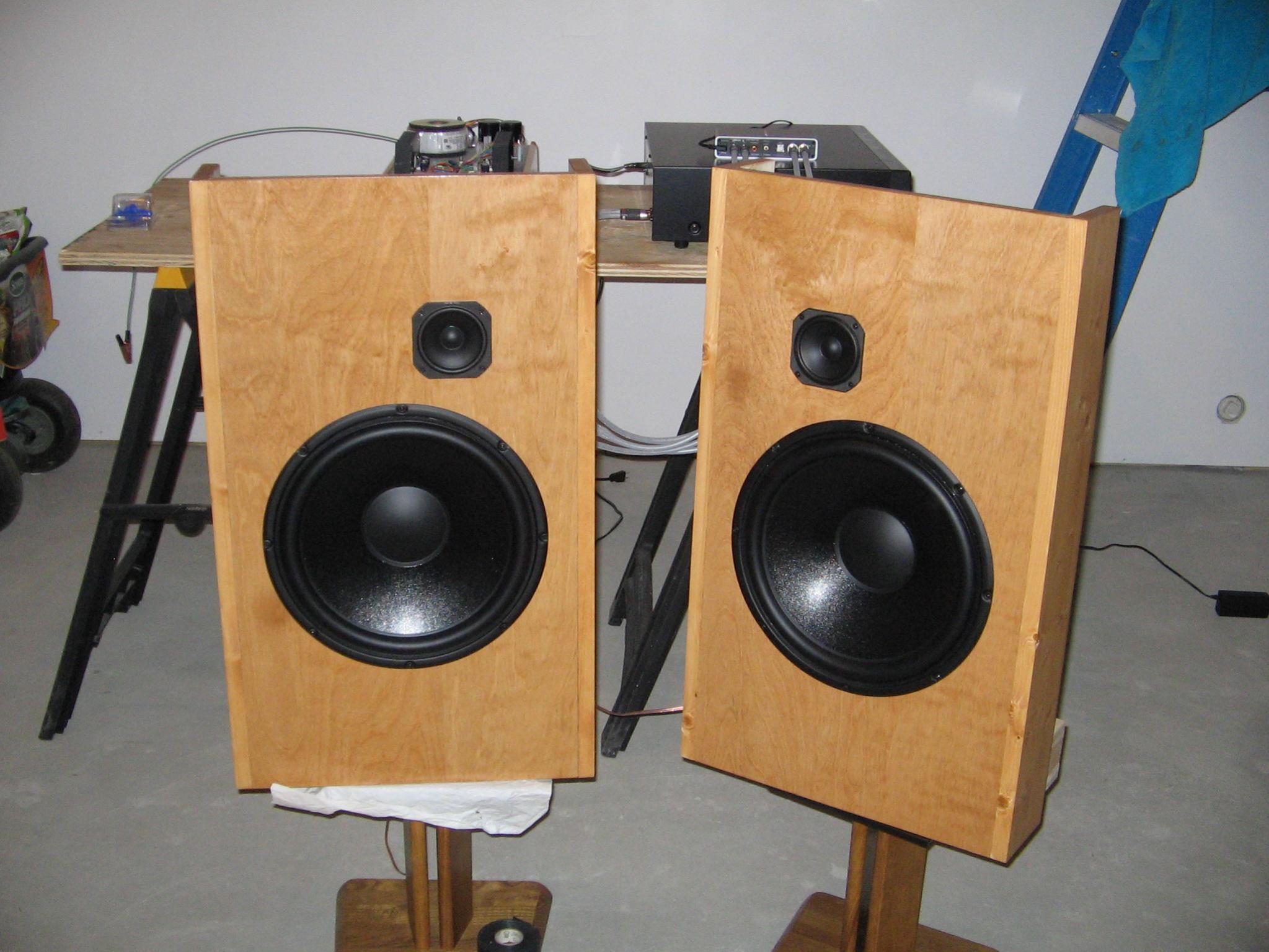

Got the Manzanitas running. In a word, WOW!
These are in a small room - 12' x 15', so far 30" out from the rear wall. Bass is very nice, moderate level with a stock Lepai (don't laugh). I'm going to try it with one of my Sure's.
JB, thanks for this design. I know you spent a lot of time on this and the results show. I always wanted to try an OB but they were always too big. This one is just right.
