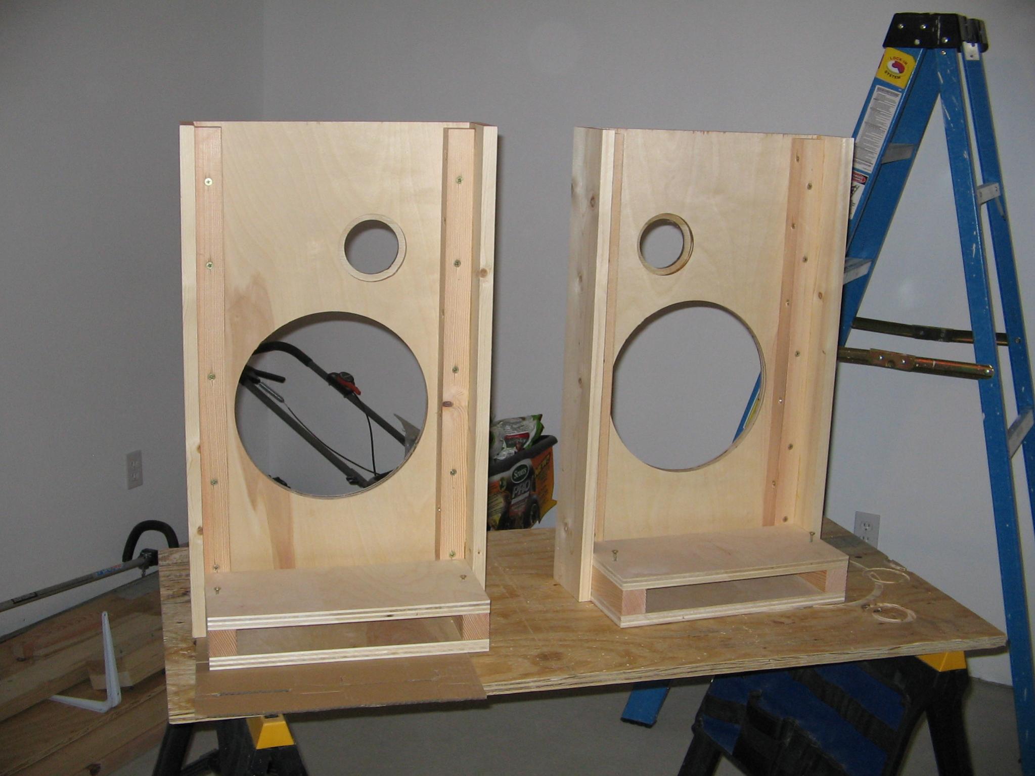

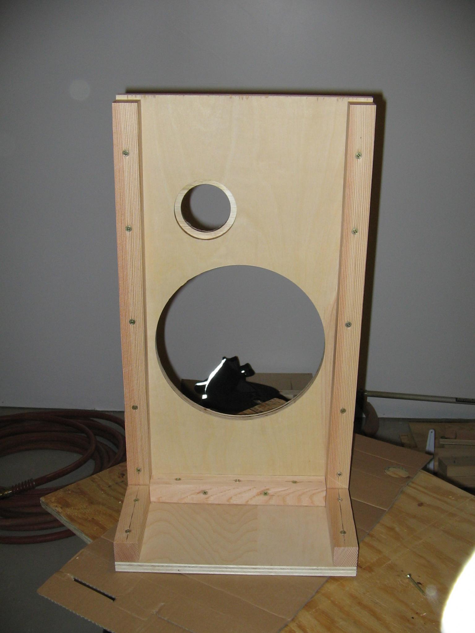

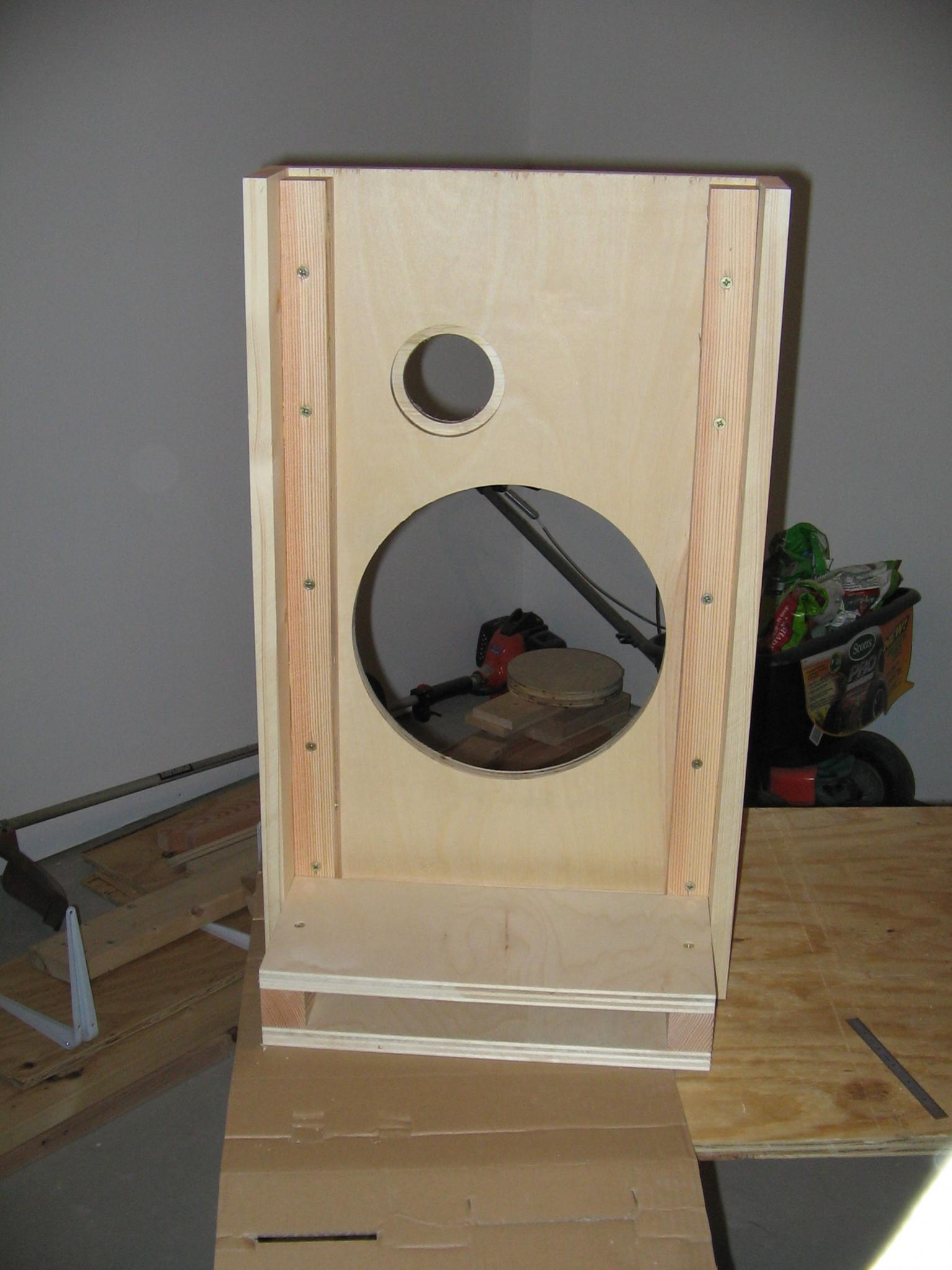

After attaching the base to the bottom of the baffle, next item was to glue and screw the baffle / wing supports to the baffle. A note on the plywood. You might be able to see some chipping at the base of the plywood. This is from my power handsaw. I pre-cut with my power handsaw a little oversize and then finish cut on my portable table saw. It was easier to handle that way and none of the chipping is on the visible side.
Securing the wings to the Baffle and supports was straight forward. I added an extra horizontal screw on each side (don’t forget to glue first) at the base to help support the overall baffle structure. Then added the top portion of the base structure where the crossover will mount. A note on the relief for the Vifa. John specified a 4.5 inch by 7/16 deep relief. Mine is only 4 inches wide. I did not have that size router bit and didn’t want to spend 30 bucks on one.
