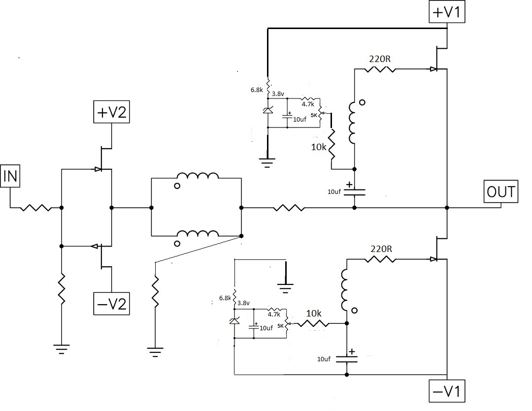

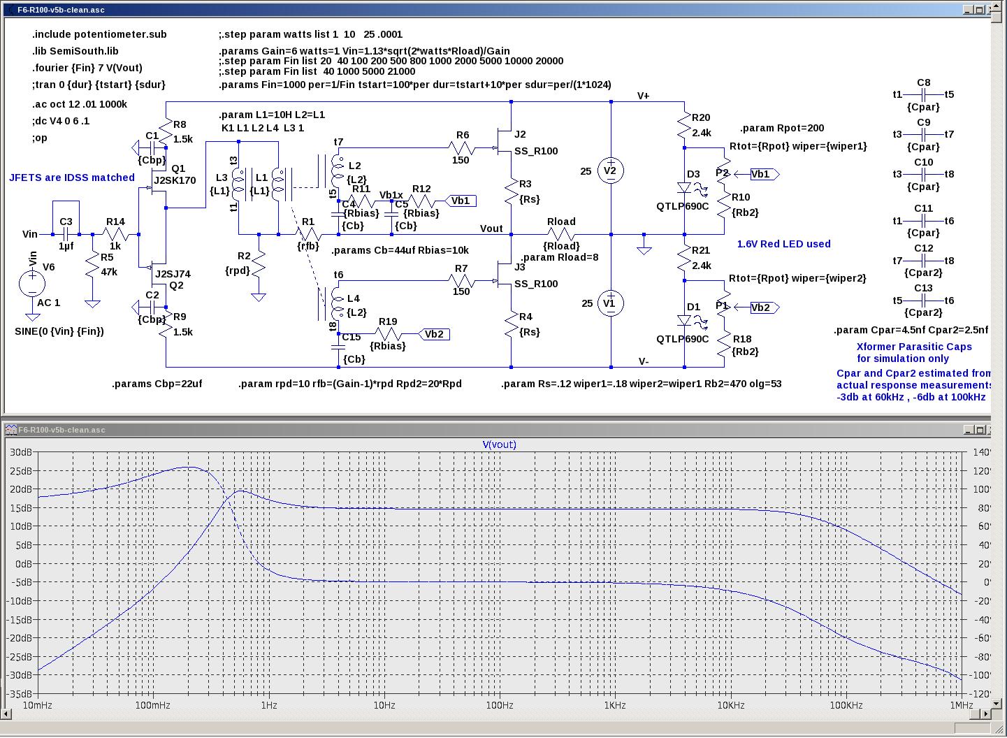

Here is an update of my schematic and its Bode plot. You should note the 2 pole RC filter supplying the bias voltage for the upper output FET. This significantly improves the low frequency THD. The high frequency response shown agrees well with actual measurements. I cannot really test the low frequency rolloff. This implementation does not suffer from the low frequency oscillation problem that my previous build exhibited.
Also shown it the THD plot of the rewired circuit. It is interesting to note the at low frequencies the 3rd harmonic dominates; at high frequencies the 2nd harmonic dominates. The crossover it at about 700 Hz. (I really need to do a Bode plot of the harmonics separately.)

lhquam: Your refined circuit like its parent still has the following observations:
  • The capacitor connected to the lead of the bottom transformer [circle] a dead short to AC ground [or V-] under all operating conditions.
  • The lead of the transformer's upper winding [no circle] which is connected to a same-valued capacitor is not [never] at AC ground. The impedance from this upper transformer aiming at ground is the sum of the resistances and through the upper bias regulator to its official ground.
Like the schematic of bobodioulasso which shares the identical observations, it is apparently difficult to exactly match the input circuits of the upper and lower JFETs.
If one insists on exact matching, then the answer maybe found [or not] in the schematics of the old classic parent[ with bjts] of Conceptual F6.
Would you consider simulating the old classic design using LTSPICE as a comparative reference?

No, regs for bias and maybe FE. If 2 pole filter on bias circuit improved LF distortion, doesnt that suggest riplle/noise is getting through simple RC and causing distortion.

I am not sure what the relevance is for "AC ground". What is important are the bias voltages relative to the bottom of the FET source resistors. We are trying to maintain these voltages at constant levels under varying signal conditions.
