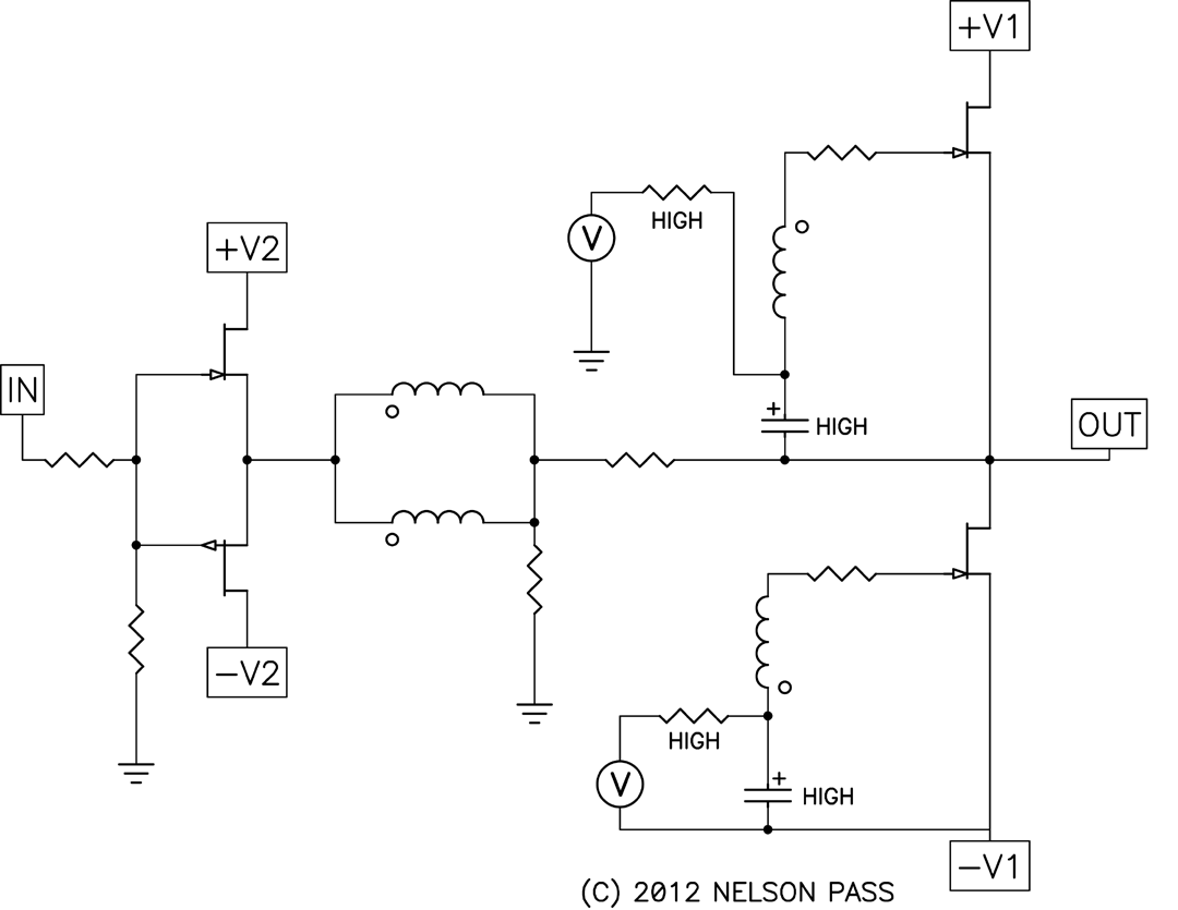

Mr. Pass. You called Conceptual F6 a Classic. Todate, no one has asked you: what is the precedent schematic of this classic old design you used to resurect it as Conceptual F6? Please show us a specific schematic of this old classic. It will be valuable to DIYers to compare with their ongoing designs to revive it.

What "I" think he is saying is that, the bias refrenced to gnd will not float the top FET with the Vout node and the bottom FET drain. Not only will the top FET not be a CS anymore but the only variability then would be the few volts of transformer signal.
As the simplified dwg shows, the output top FET bias is tied and floats above, the Vout node.

The specific schematics in the previous post, and others presented in past ones have a general structure [or topology] like that of Conceptual F6. I believe that any one of them fits the description of the basis classic design. IMHO, Mr. Pass infused this old parent design with current new-technology semiconductors and passives [absent in the 1960s], plus his extensive and exclusive know-how to create his Conceptual F6.
DIYers have focused their attention on Conceptual F6, and may have ignored the [great] value embodied in the old parent classic. The parent designs from the 1960s contain all of the principal principles of operation which are needed to implement a working Conceptual F6. For example, where does the bias to the upper JFET need to be referenced to in Conceptual F6? Clearly the best solution is to the output port as shown in the old trusted design.
How close is the design of your Conceptual F6 to that of the parent classic?
The first time I saw a design like the F6 came from this Delco application note:
http://www.updatemydynaco.com/HistoricDocuments/Delco100Watt.pdf
I remember at the time I didn't have a clue how to make a +/- 50V power supply.
I believe that Mr. Pass took a classic as in the above link, and ugraded it dramatically. For example; the very low distortion, high power, and simplicity etc. of Conceptual F6. I hope this analogy fits; it is like improving a 1956 Chevy to a Chevy Volt!

I took the time this morning to review my history of posts in this thread,
and I conclude that you would benefit from some additional information.
Notice the particular placement of capacitors, resistors, and transformer
secondaries which give greater output DC offset stability without
sacrificing the symmetry of the two halves at AC.
:cool:
