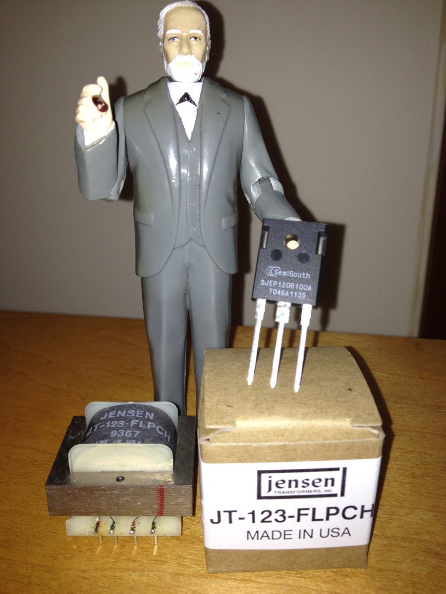

I'm pretty sure that transformer above doesn't have dual secondaries.
Try this one instead, $2 more:http://jensen-transformers.com/datashts/123flpch.pdf
This is the Jensen page you want: JENSEN TRANSFORMERS, INC. - LINE OUTPUT TRANSFORMERS and pick your poison.

You could put quite a few of those transformers in one of the small International priority mail boxes. They weigh 3.5oz each box (max 4 lbs a box at 16oz per pound). Could still add some bubble wrap padding on them.
I added the R100A and transformer size for perspective, with a little help from my therapist, Dr. Freud. So four of them don't need two of the boxes Generg if that's what they said.

Yes Rush you are right! The 123flpch is the right one and it costs some US dollars more...... The postal fee to Europe could be the same and the mode of ordering will be the same mentioned!
